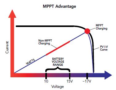

Maybe the difference is the Morningstar SunSaver MPPT charge controller I was using?
It can generated power when the panel voltage is above 14.5. Most other (non-MMPT) charge controllers can only harvest power when the cells are between 10-14.5 volts, but cells can maximize usable power to about 18 volts, which can only be harvested by a Maximum Power Point Tracking charger.There are some Chinese MPPT chargers ones that are junk, so I went a reputable US company - Morningstar.
That's good info to know. I was using the cheapo Morningstar SunSaver old style controller back then. I've had my eyes on those MPPT regulators. Guess I got my answer right there. Thanks.
My previous comment of "barely" implied that I didn't have all that much left over solar capacity after fully charging the batteries. It could keep up, but needed sunny days and to be actively pointed at the sun to do so.
