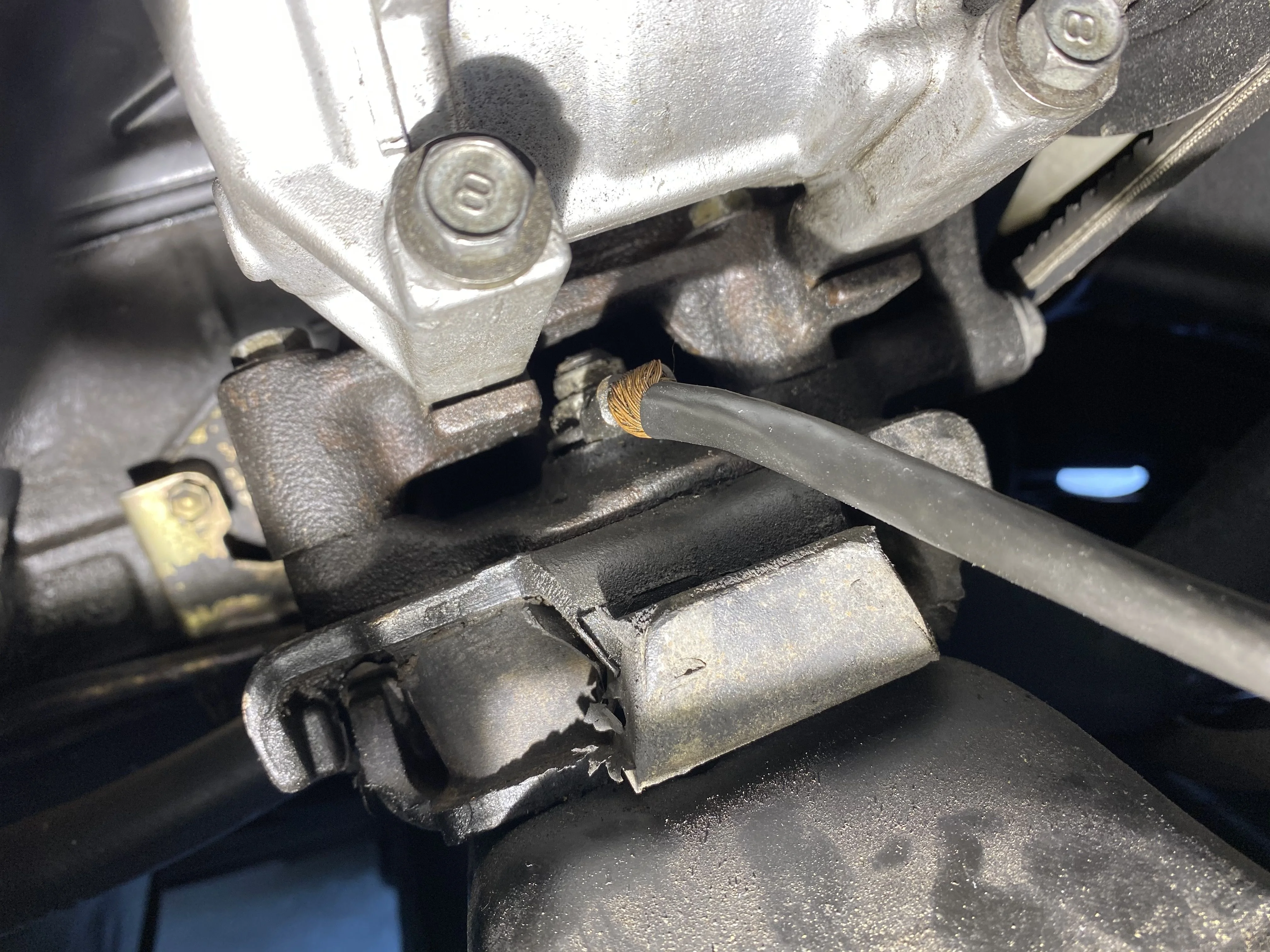

Question for anyone that's installed the Fourrunner cables. I bought a set last week and started the install today. The positive side was a breeze. Hit a bit of a wall trying to get the negative cable removed from the engine mount. It's a super tight clearance and I cannot seem to break the nut free. Even if I get it, I'm not sure there is the clearance to get the nut off to remove the negative cable. I feel like I'm missing something simple here. Appreciate any input from someone that's done it.
You don’t have to run the new cable to the motor mount. Anywhere on the engine will work fine. Just wire brush or sand the mount surface clean before you put it on with a bolt.
In fact what you could do is leave the old one bolted to the motor mount like it is and find another place to attach the other end to the frame. You may need to put an eyelet connector on the opposite end. Then you could run a new wire from anywhere on the engine to the battery etc.
Thanks, guys! Exactly what I needed. Will fix it up tomorrow. Excited to get it in based on what I’ve heard.
I put mine in the stock location. I just had to loosen the ac compressor to get access to the bolt. If I had known, I would have run it to the dogleg bolt. I haven't yet attached the two smaller gauge grounds.
