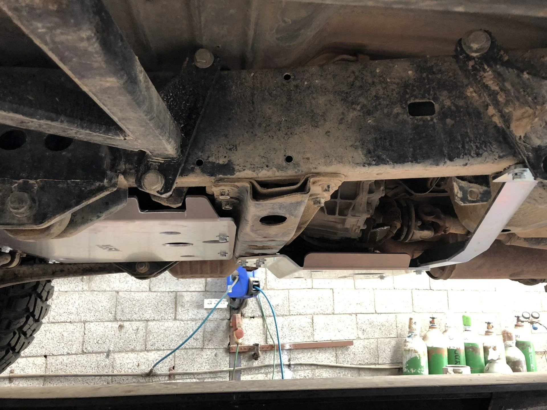

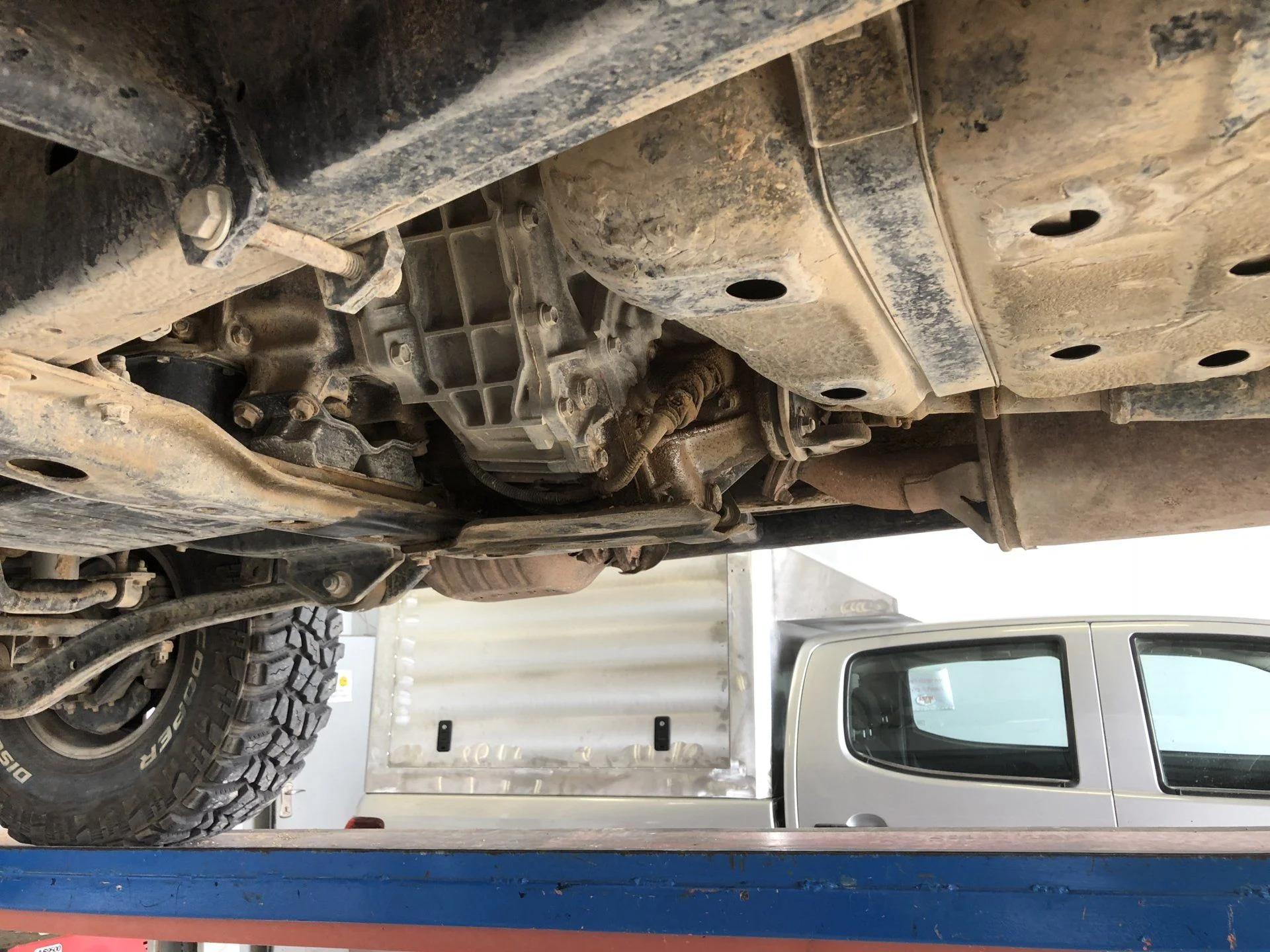

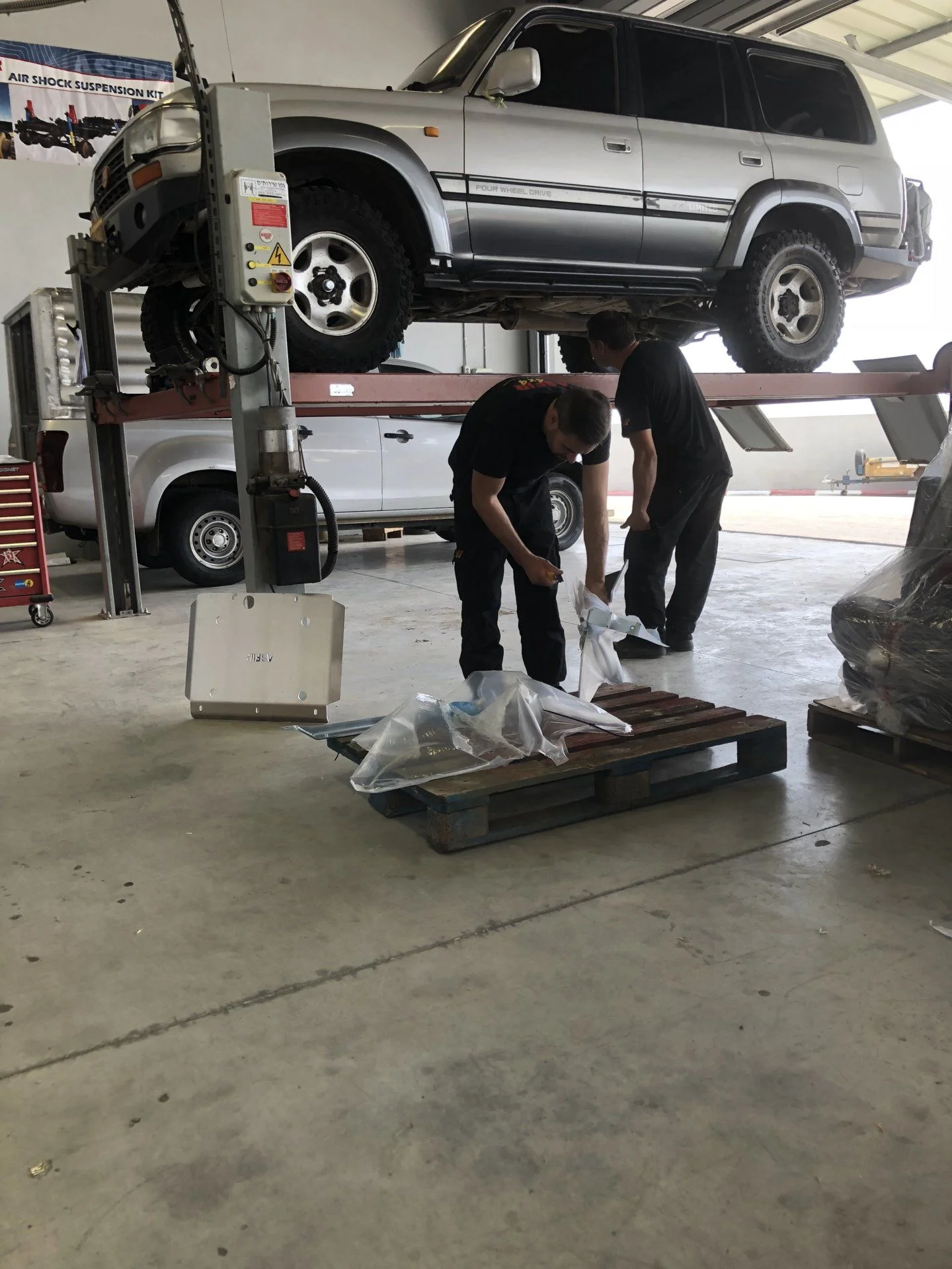

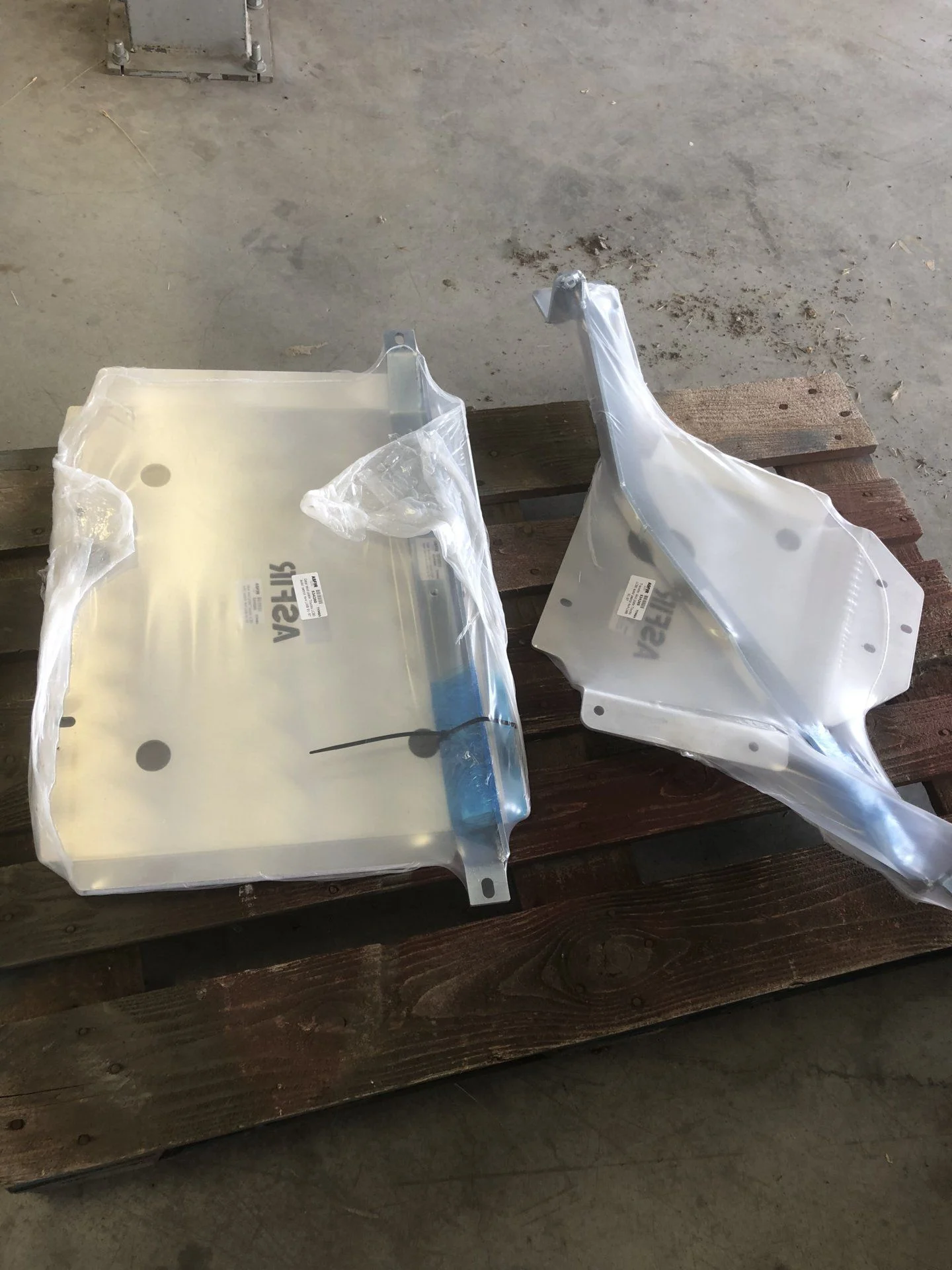

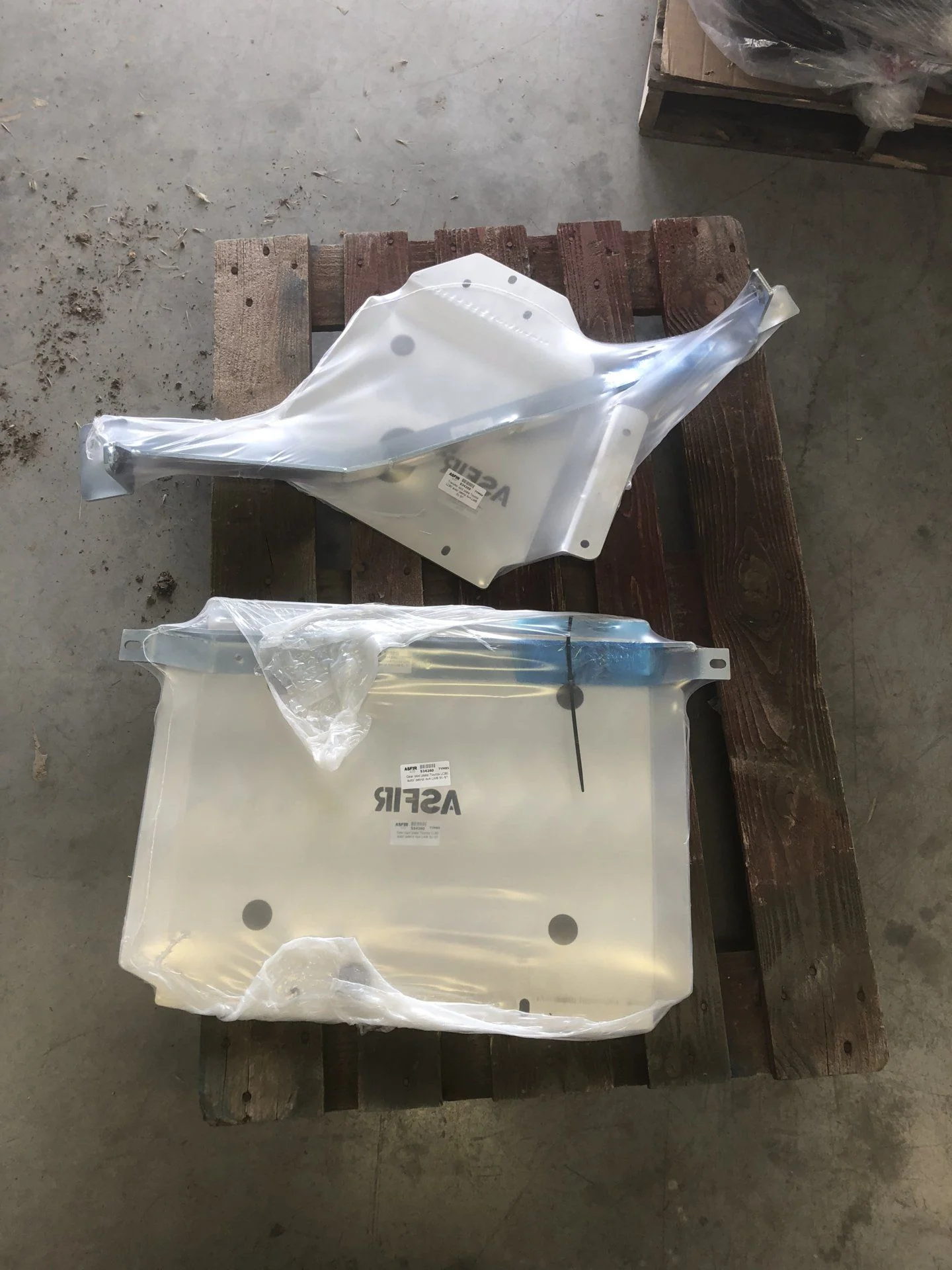

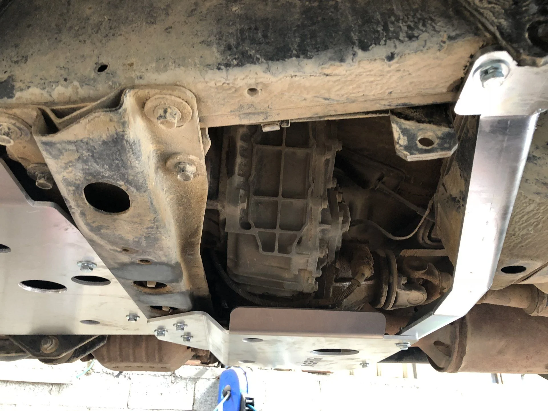

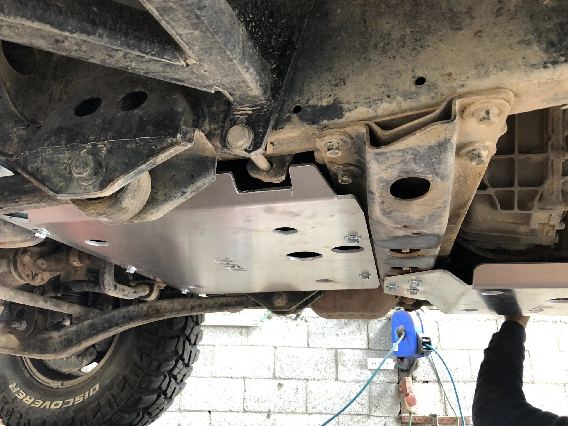

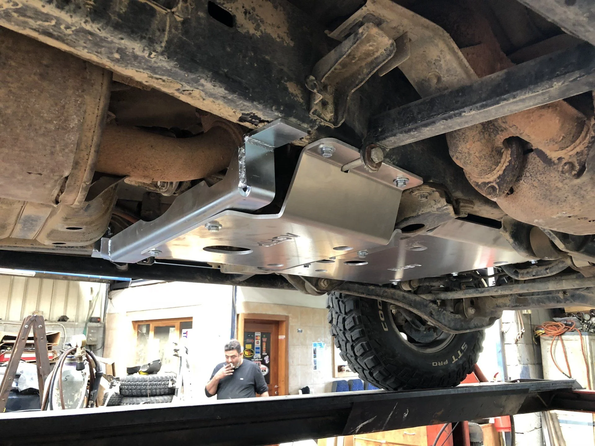

I ordered the armor from Asfir it took them 6 weeks to manufacture the 2 kits.
The kits were mounted by Asfir and they were very well packed with all the hardware needed
Installation was bolted on and simple. The only thing is that was wrong were the service holes for oil change were not in the correct place. So I am made them remove it from the rig and make new holes in the correct place.
I have only the before pics since they have a very beautiful girl in the reception (don't tell my wife) so when I went to pay I got stuck in a long conversation and coffee about do you really need 110V AC on the rig or not I remembered a thread here on MUD with very good arguments in favor of 110V for the operation of the Magic Wand. She liked the Arguments so much so she asked to come with me on the next trip.

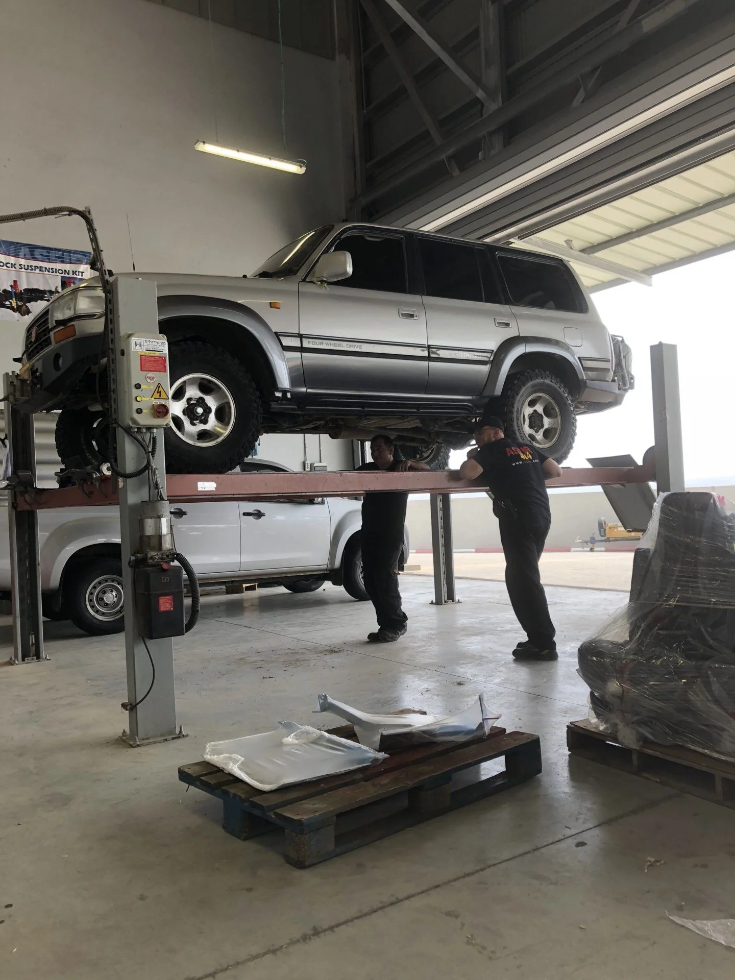

When I finished the conversation the rig was parked ready to go
Next time its on the lift i will post the after pics

View attachment 1682341 View attachment 1682342 View attachment 1682343 View attachment 1682344 View attachment 1682345
