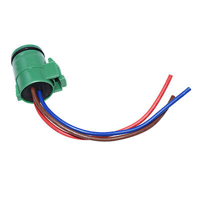

Nothing wrong with the CR alternator, but your connectors are fudged, so you'll have to find the connector for that pigtail, or wire directly. The connectors are on ebay.
I think this might be easier, on Rockauto:
I think this is the correct connector, but verify:
