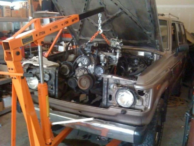

metal flakes in the coolant look like bars leak rad sealant magic. Chassis looks pretty cherry, My sixty is the same colour, rear end sag and wheel tyre combo like 75% of them. The lack of heat is probably a plugged heater core combined with the thermostat. Flush it well and all should work out.

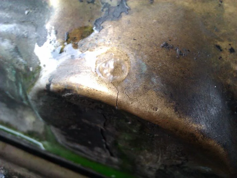

Pictured here is a hairline crack in the radiator. I'm gonna see if I can get it brazed but I'm guessing it's time to shop for another radiator...:censor: By the time I'm done with this thing it'll be a brand new rig.
Going to replace, the brazing managed to pop 3 more leaks in the damn thing :bang:, There's a member here on mud who is parting/parted out a bunch of FJ60's and happens to have a good radiator lying around still so I'm picking that up on Tues when I have cash again.
