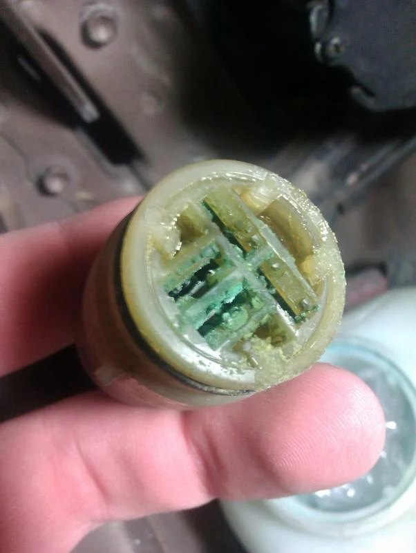

Ok, horn is definitly that pin, when I had something (a key held between) touching both and pressed a button it made a small beep. Wiper I'm still unsure on, I can hear the relay clicking so I doubt that's it, guessing it has to do with the wiper motor itself. Next order of business will be tstat but I need to go warm up first

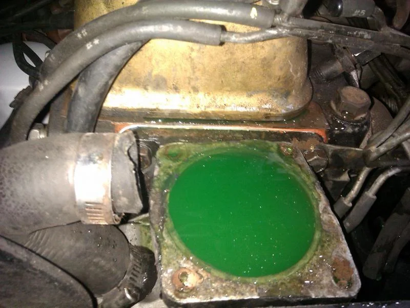

Ok, will post pics later, opened up the thermostat housing and that little rubber gasket was definitely missing, going to spend the extra to replace the thermostat anyway since I've already got it open and have to run out for gasket maker I figure i might as well. One thing I did notice was there seemed to be something metallic looking in small quantities floating in the coolant, i might have to keep an eye on that, more pics later

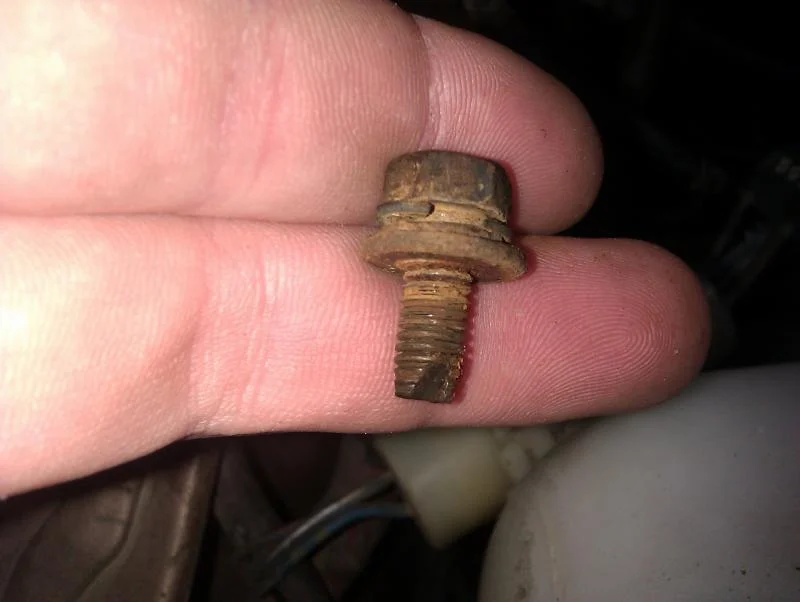

Pic 1: Changing out busted marker lenses yesterday with one's I picked up from Cruiser Outfitters*, found this piece of work :eek:
Pic 2: Erm is the coolant supposed to be metallic looking?? :confused:

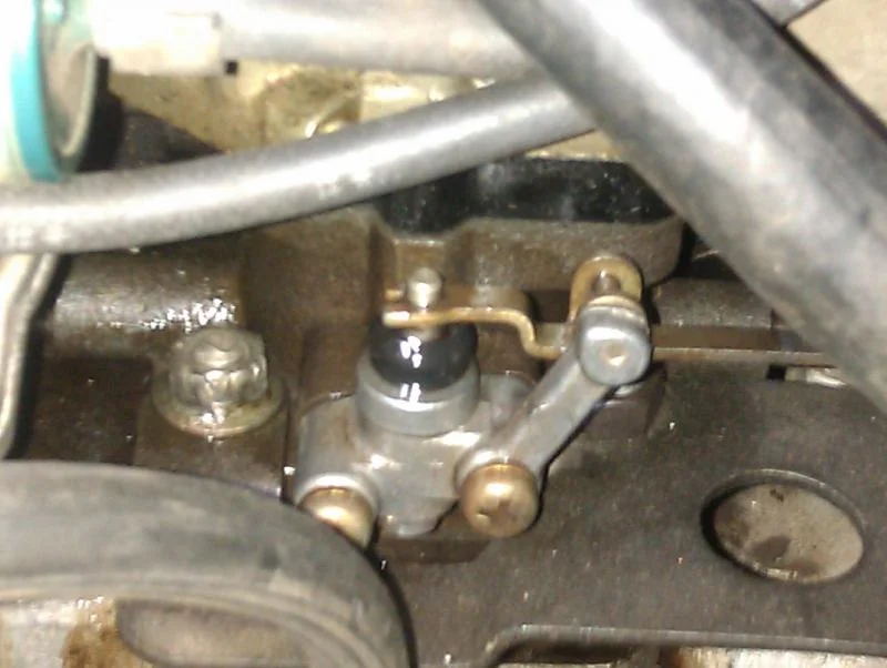

Pic 3: Fuel leak on side of carb :bang:

I would start with the switch on the wipers, get a wiring diagram and check for voltage at the pins of each position.
