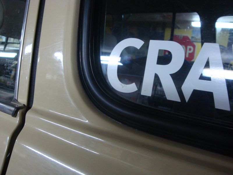

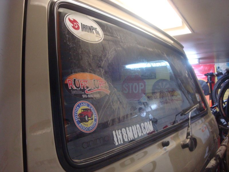

Not much to report really. Popped in the black lock (belting?...) strips on the cargo windows and hatch window seals that the po didnt replace when he dechromed. Bought the tool so it went in real easy with the help of some silicone spray.
