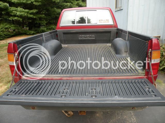

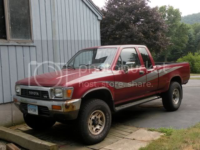

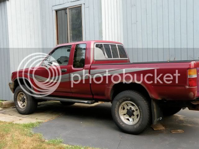

For the most part, the new truck is in really nice shape. I bought it from a guy who owned it the last 17 years / 90k miles, and he did a lot of maintenance. Just about everything works, including the 4x4 stuff and AC. It does need a few small things, and I’d appreciate a little input from everyone. Here’s a couple pics from when I bought it:

That chrome thing on the front fender will more than likely trap any salt that accrues... So will the places the plastic covers on the running boards.
Have a look at the under side of those and you'll take them off... Toyota only chromed one side.
I'd wash that thing religiously in the winter and try my best to use only hot water...
Then I'd get a garden prayer and fill it with some type of oil and periodically spray the under carriage...
Also, body seams. Those are IMO the hardest and most complex places to fix. So $$$ cha ching if you have to have it done.
I'd get on the corrosion, and stay it as best I could. The cab looks fine so far, and since beds are easier to obtain and swap I consider their importance secondary...

Appreciate the words of wisdom so far. Rust is definitely an issue on this truck (as it is for anything 20 years old and in the NE) but I don't think I'm going to worry about it until the spring. After the winter, plan is to remove cab and bed, por15 the frame, cut out the rust around the wheel arches and install a set of plastic flares. That's the plan anyway.
