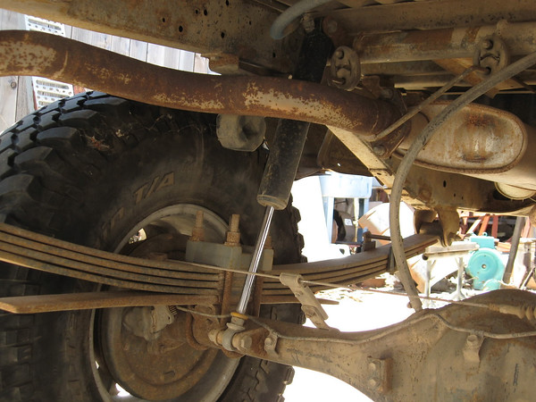

Keeping the Cat isn't a bad thing, and the engine is tuned for it being there. On my '84 22R I went with mandrel bent 2.25" from the 'Y' of the stock head pipe (kept the 'Y', cut off after it at the end of the merge) all of the way out. Used all of the stock hangers. Only pic I can find of that system:
