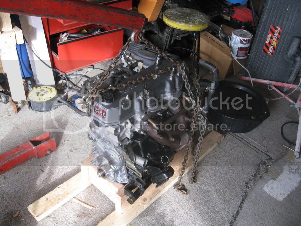

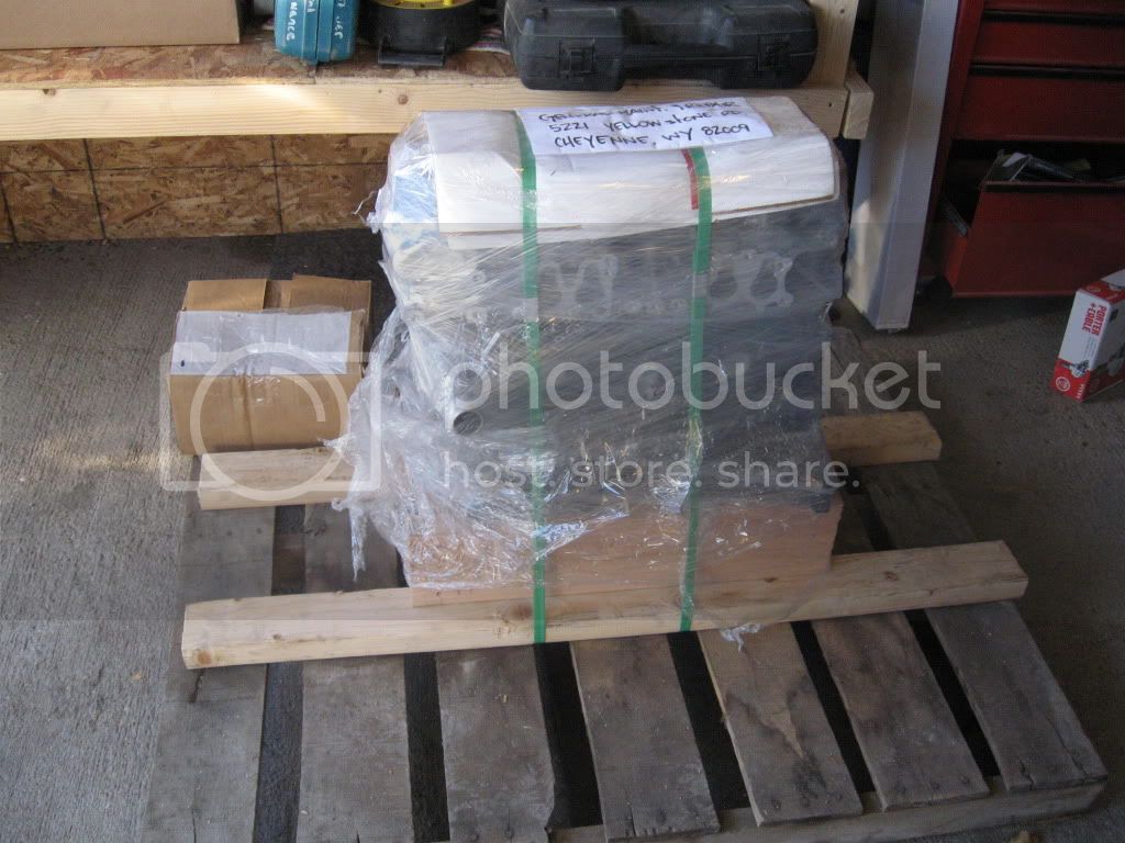

I went back and forth about what to do with the truck. I did not know if I should sell it or if I should drop a new motor in. I started to do some research and came across 22REPreformance or Putney's machine. I called them up and asked a few questions. I wanted a block that did not need boring or a crank that needed to be turned. I wanted to run OEM rotating assembly components. They said if Toyota could get them, they could do it. So I called up my Toyota parts guy and told him to get searching. I also just went with Putney’s performance head and their high flow rocker arms. One week later I had received brand new pistons, rings, bearings, etc. I shipped them off to Putney's and 8 weeks later this is what showed up on my door step.

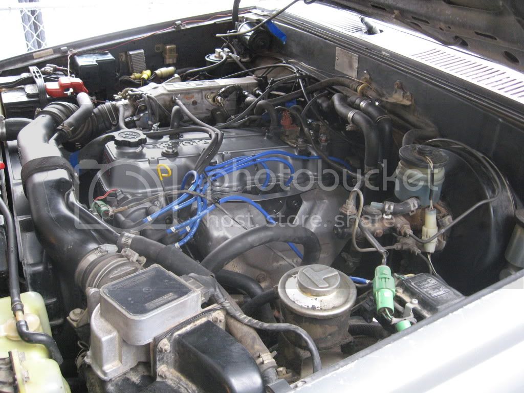

I proceeded to start prepping it for removal
By 10:00 it was 90% ready for removal the next day. The next morning I had to get the tranny bolts out and lift it out. By 11:00 it was out!

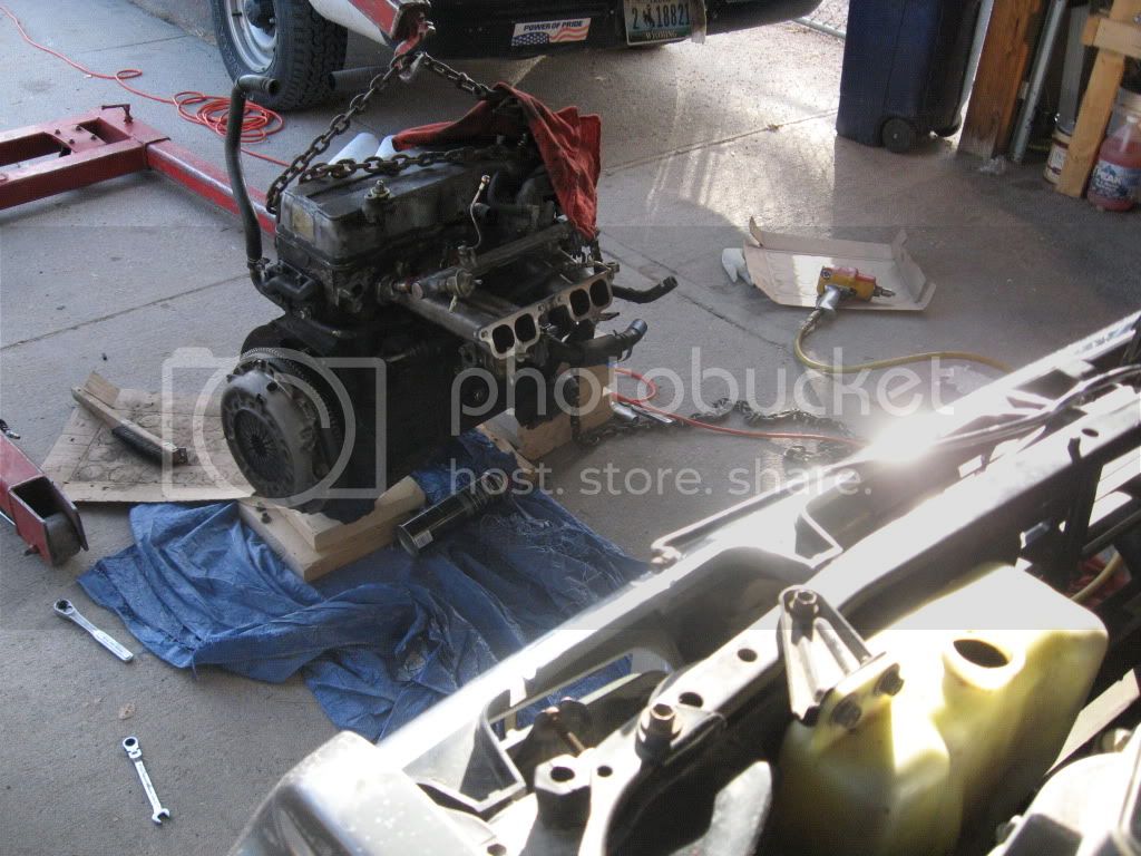

Then I had to move everything over to the new engine and install the new clutch. A few pictures:

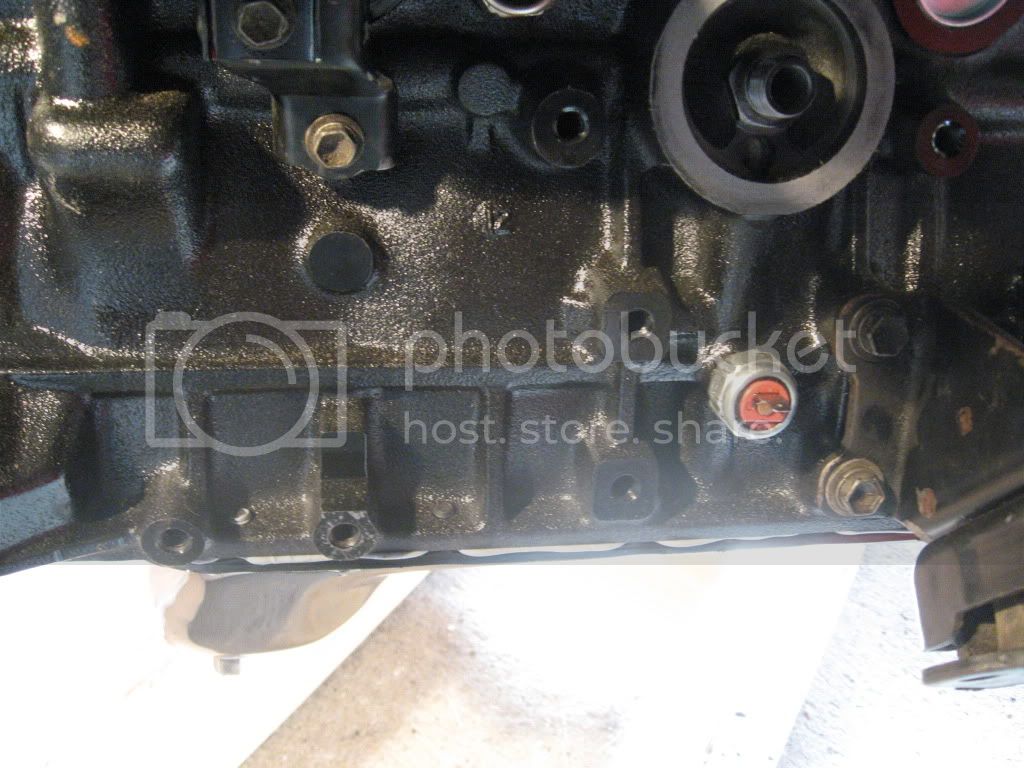

Here is a picture of the RTV on the oil pan. No leaks here...
Here are some pictures of the new engine with the accessories on

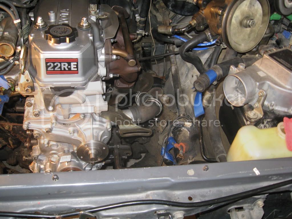

By 6:00 Saturday evening the engine was back in the truck. It went so much faster than I imagined it would for my 1st engine swap.

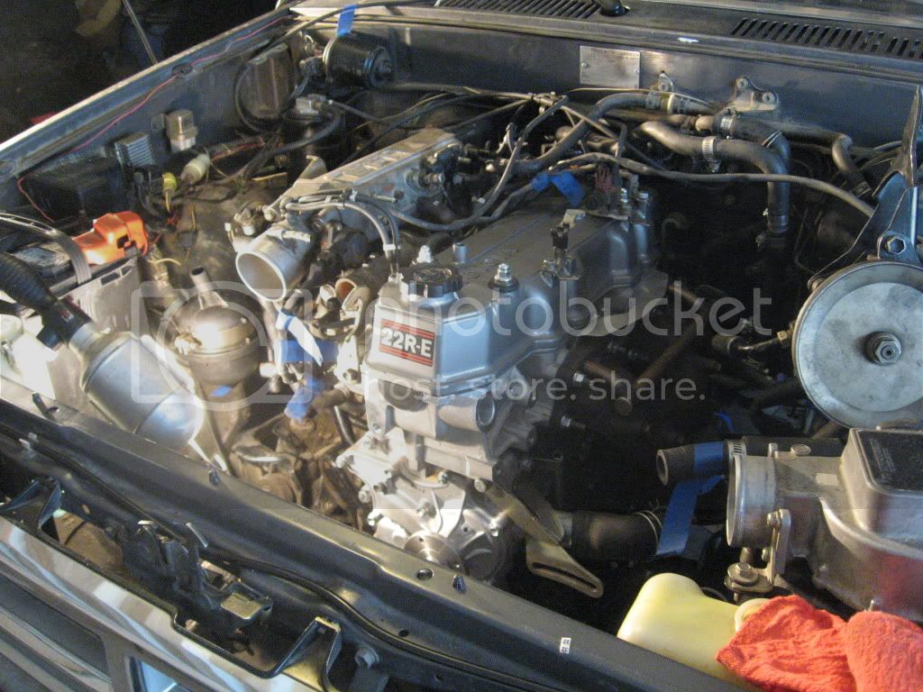

Here is some pictures of it getting hooked back up and finished.
Well I had it finished by 2:30 Sunday afternoon. I used straight 30-weight oil with a bottle of a zinc additive for the first 100 miles. Then I went with 10w-30 for the next 500 & 1000 miles. Since the initial break in, I have been going 3,000 miles between changes. Around 10,000 miles I will change to Mobil 1, just to see how it lasts verses an engine that used conventional all it's life.
