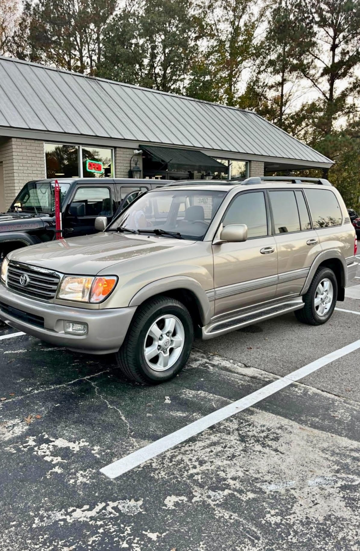

Thanks for the input! It has 160k and is getting timing, serpentine, water pump, and hoses done before I pick it up next week. I agree on "best" being subjective. I want to get the ride height up a bit as I believe the stance has a better appearance - likely not doing any serious off-roading outside of finding spots to fly fish.
Here is a pic.
looks like new! maybe think of starter contacts while you are at it.
Be prepared for everyone to tell you to ditch those flares and running boards!

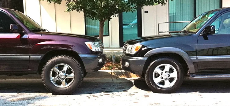

Since you’re not planning on doing a lot of hard ‘wheeling, how about doing what squidmotion suggested plus tires and a torsion bar “lift”? You could buy even more fishing gear ;)
For comparison, both 100s are stock. Left has the TBs cranked about .75”; tires are 275/70s.

Hmm, that could be a solid option. Thanks for the visual!

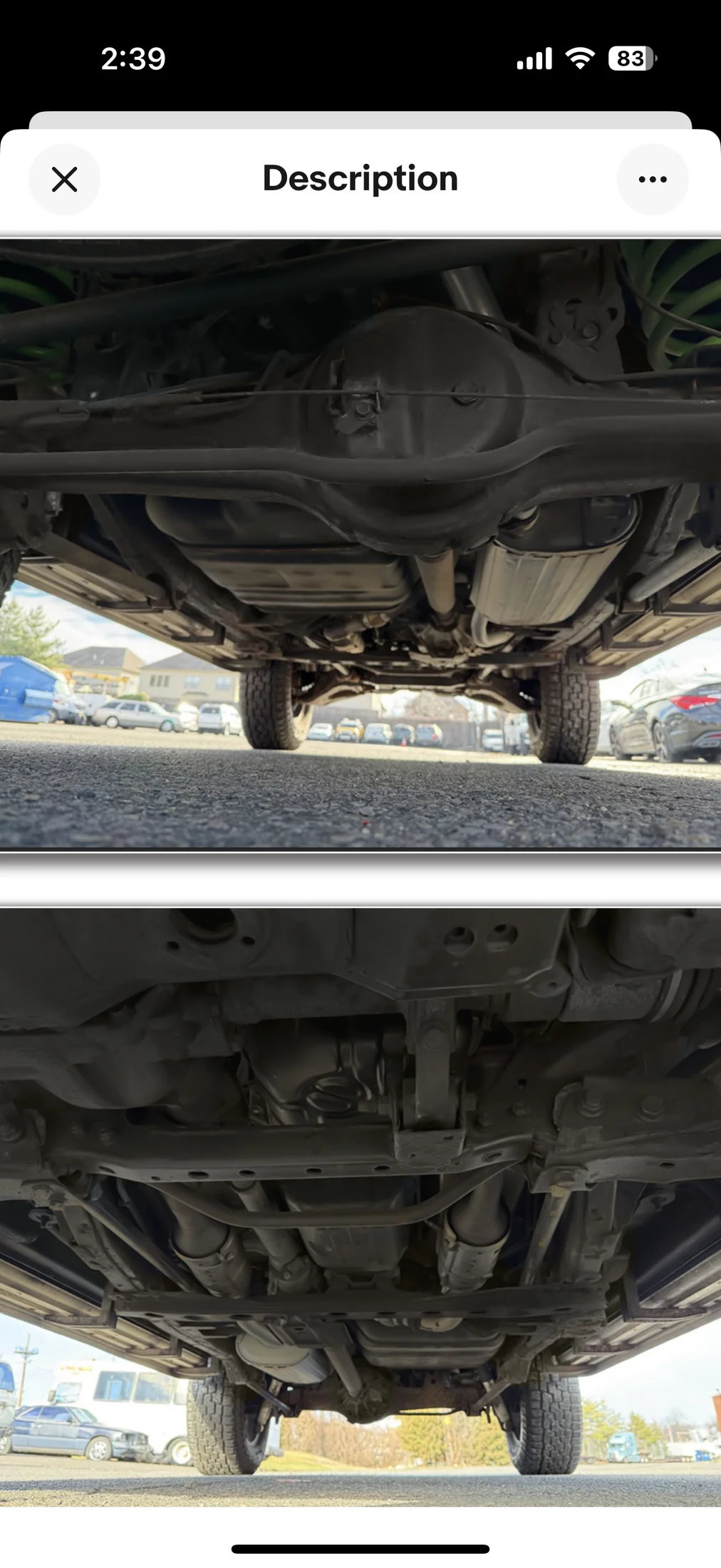

I'm looking at 2007 with 150k in Galactic Gray with gray (super clean) guts. No accidents - clean body. Long service records, all done at the dealership. 2.5" Ironman lift. Any thoughts on the undercarriage? The last owner did do some sort of light rubber coating.
I appreciate any input.
