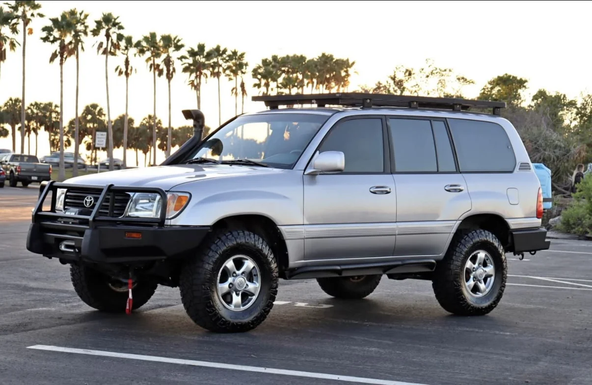

After the PA disaster, I have just purchased this 2002 which is being shipped to me on Tuesday.
