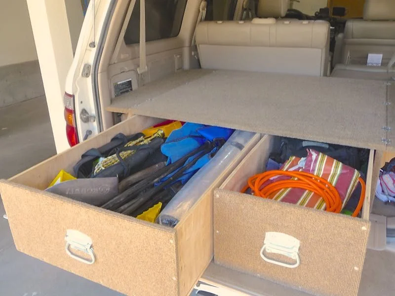

I’ve never been able to understand the angst about LC100 drawer systems. I took one look at the commercial offerings, decided that >$1,000 did not make sense for me, designed and built my own for a little over $100, and have never looked back.
For context, note that my carpentry and indeed engineering skills are essentially nil. I can glue, drill a hole and screw in a screw and that’s about it. I’m a retired economist (see cost analysis in the previous paragraph). I even used carpet tape for part of this project without realizing that you’re supposed to iron it to activate the glue (I mostly used a 3M spray-on glue not particularly meant for carpets).
My clever trick, if I had one, was to build a prototype out of hot glue and 1/2” thick insulating pink foam sheet, the kind you find in Home Depot, and then use the result as a pattern to get the plywood components to fit precisely. Then, knowing the exact dimensions I needed, I was able to persuade a helpful guy at Home Depot to cut the pieces I needed out of a single 4’ x 8’ sheet of plywood (may have been two sheets, I don't recall for sure).

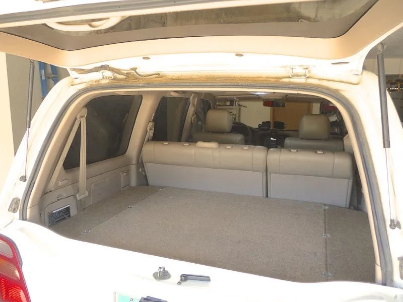

My critical insight, so to speak, was that because the LC’s rear area with the third row seats removed is essentially flat and the tailgate descends to flat and level and is carpeted, slides are not necessary. They just take up useful space, add cost and add weight. My drawers function perfectly well without them.
The tailgate area inside is not perfectly flat, but I was able to correct for this by screwing an old broom handle across the front of the box that holds the drawers (the front of the box being towards the front of the vehicle). The drawer system is attached in 4 places near the corners to the tie-downs the LC already has in exactly the right places, and is easily removed when I need to reinstall the third row seats, as I did over the Christmas holiday period.
More than a year later I have driven with these drawers loaded up and without a single problem through several Western states, put in thousands of miles on dirt roads and travelled a lot of routes that barely deserve to be called tracks. Two weekends ago for example I drove up La Bajada hill between Santa Fe and Albuquerque, which for those who know it is a rock garden of a road that hasn’t been part of Route 66 since the 1930’s.
My rear drawers have frequently been admired, and function in one respect better than any others I have seen: they are very light weight. That’s critical for me because a key goal has been enhancing my LC’s off-road capability while keeping the suspension totally stock.
Pictures:
full
My 70lb+ dog sits back here with no problem, often with a pile of luggage beside him:
full
No slides necessary:
full
Half inch plywood throughout, plus cheap outdoor carpeting from Home Depot:
full

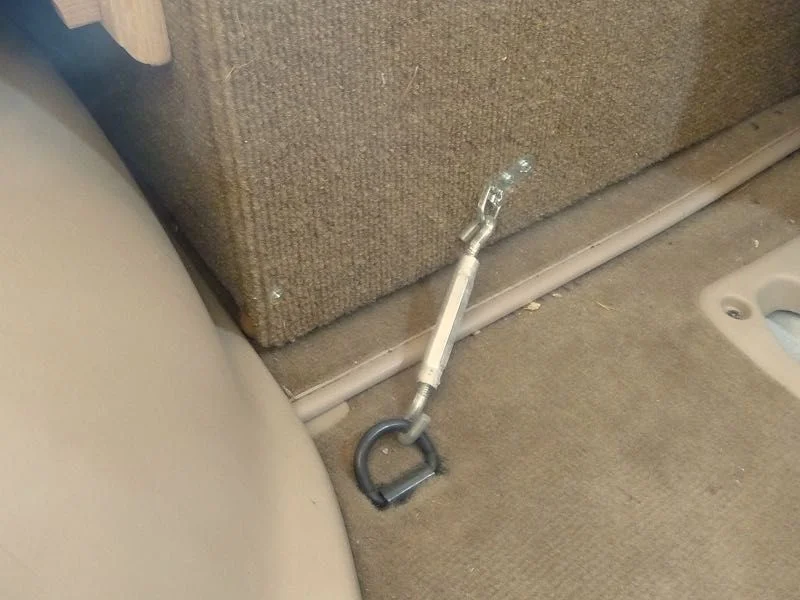

Rear anchor point:
full

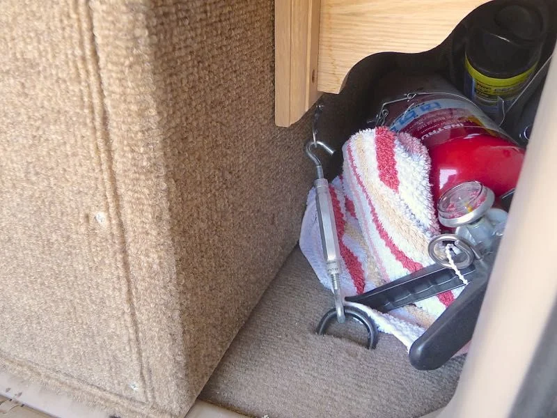

Forward anchor point:
full

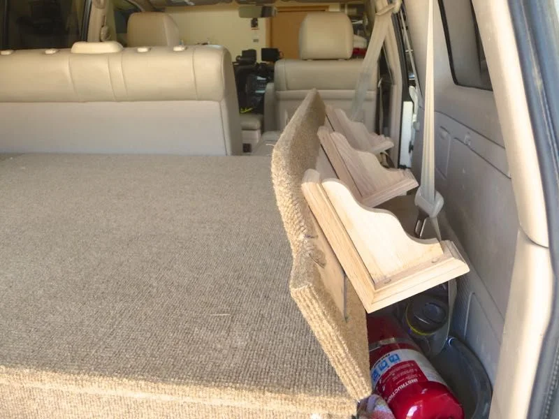

The hinged flaps are held up by some wooden Home Depot bookshelf brackets. Not elegant or space-efficient, but as firm as I need them to be:
full

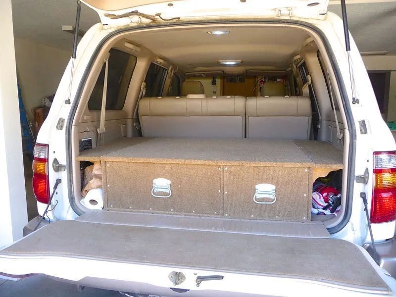

I keep them pretty loaded up:
full
full
Barely over $100! YMMV.

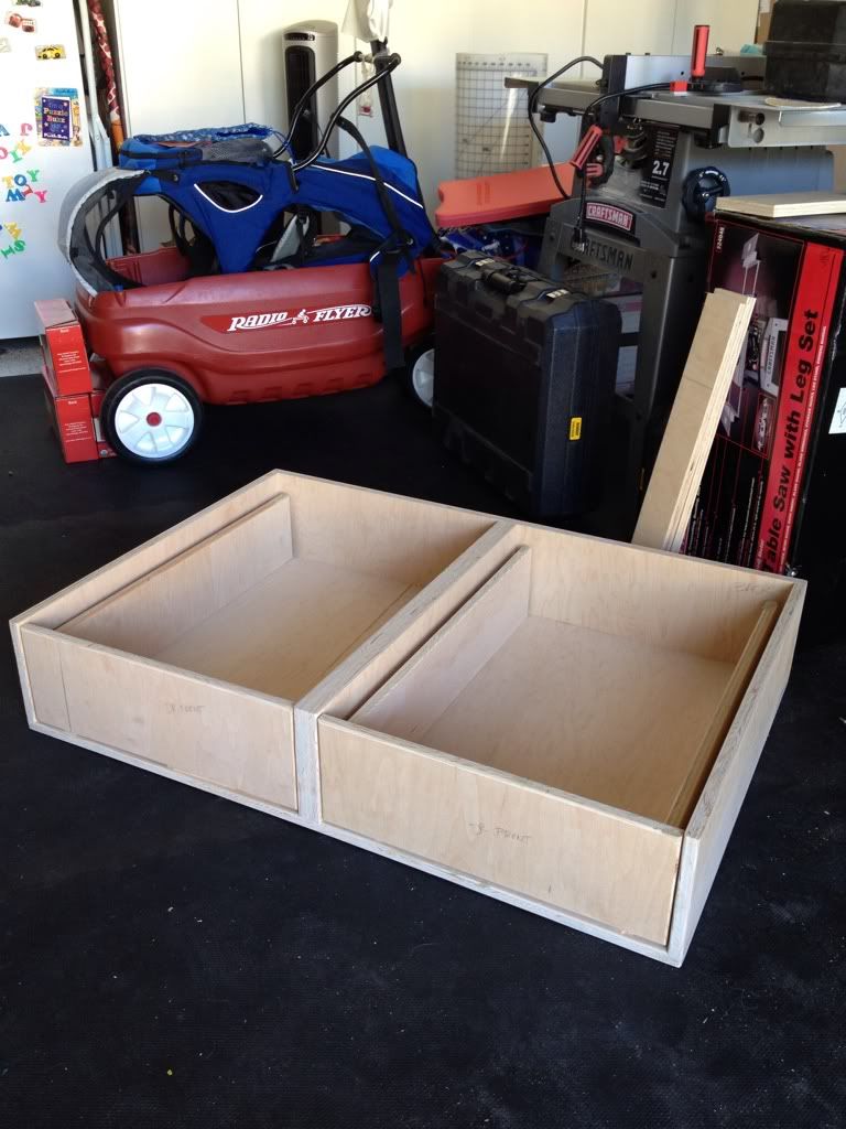

like this? half drawer w/ cupholder integrated for 3rd row passenger...
I guess there's alot of truth in the idea that we all have different expectations on what we'll use drawers for. One of the most desireable features for me was the ability to get access with out having to unpack your gear. So top access would not be necessary (except for maintenance). Also, for me, as little as possible, more room for storing camping chairs, tents & gear or luggage on top. Just a place to stow jacks, chains, snatch block, D-shackles, tools, spare parts, etc.... These things need to be accessible at all times, so you can't just put them on top of all your other gear that's packed, because they're heavy and dirty and would settle to the bottom anyway. You'd be hunting for them forever. So for me strength and reliability in the drawers is non-negotiable. I tried a couple of plywood and plastic bin setups that left me unsatisfied. Plastic and wood didn't fill my purpose, plus I wanted a fridge and slide setup. I didn't want an impressive storage unit stacked in the back with edges following the contours - like it appears is popular. My minimum Outback Solutions works perfect for my purposes and you might consider as a basic setup option model, Dave.
