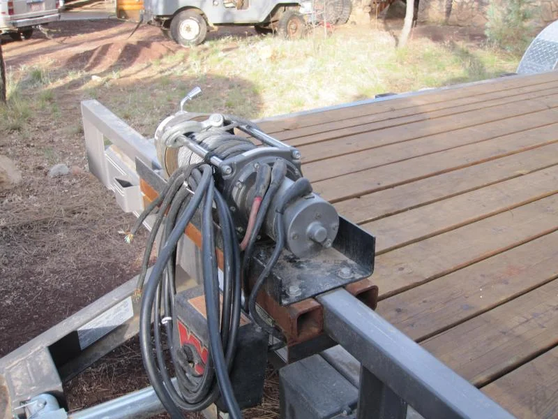

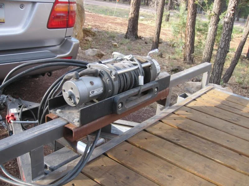

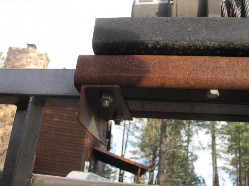

I have a 5000 lb Warn winch that I have just for the car hauler. Since the winch is only used with the car hauler I just leave it on the car hauler all the time. My car hauler has a 2"X2" sqaure tubing running across the front. The winch is on top of the tubing. Have a piece of tubing running in front and one behind the rail. Then two small pieces of angle running front to back underneath on each side. Using the holes in the bottom plate of the winch as a pattern I drill thru the loose tubing and angle iron underneath and bolted it together. I sandwiches the car hauler's front railing. No holes in the car hauler and it doesn't rattle around like it would in a receiver hitch. Can get pictures this weekend if you want.

This was a very simple setup. No real fabrication involved. Couple pieces of scrap metal, drilled a few holes and bolt together. Beside the rattle of a receicer hitch it makes it tougher for some one to just walk off with it. It I didn't the car hauler in a secured location I would weld the nuts to the bolts making it even harder to steal. The winch was given to me. Just needed to pick up the remote control. 5,000 is really to light to use even on a FJ40 so figure the car hauler was the best place for it. Beats using a come-along to load a inop vehicle. Even unloading is more controlled. I'll be picking up a non running FJ25 this weekend. so I get some pictures then. Right now it's all covered up to protect it from the AZ sun.

Here is how I mounted mine. I thought about the receiver hitch but only use I have for it since it's only 5,000 lbs is the car hauler. I have other winches for vehicles. I just used a couple pf pieces of heavy gauge wire I had then a set of jumper cables to the towing vehicle battery. For me it wouldn't make sense to have a dedicated battery. The only thing I paid for was the controller for the winch.
