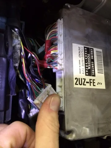

I will debate the "5 minute way" though. I started the timer on my phone after finding this thread and timed the following:
Remove glove box
remove plastic panel behind glove box
Remove 4th connector down that contains red/black wire
unwrap OEM loom.
Cut wire and strip both sides
cut length of new wire
solder and heat shrink
rewrap loop with new electrical tape
zip tie new wire along antenna path (the antenna is right near the ECU, so it makes a nice pathway back to the radio).
install male disconnect on end of new wire
install female disconnect on radio pigtail
Red/blue wire that is in Pin2,bottom right, of the connector my thumb is on (note that you can't really see the blue stripe in this photo):
I stopped to go to the bathroom and took a few photos.
Grand total:
