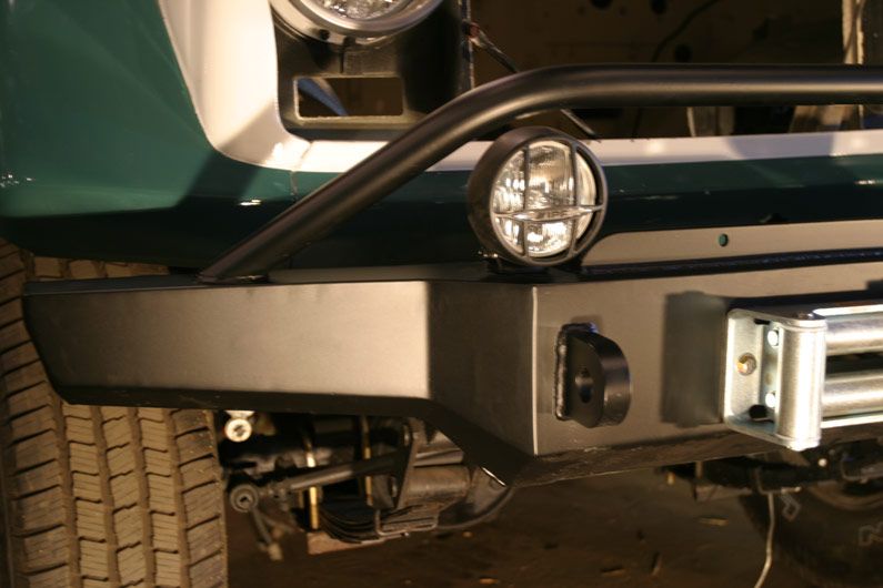

There are alot of great bumpers in this thread with lots of features I would like in a bumper.But I have some unique problems that other 55s dont have.I have been lookin at this for over a year and Im still not sure of the end product.But I do know for a fact that I will ruin this body if I dont support the frame front to back.
Well I have started it but it is not finished.Still having no clue I just started at the top of the list of needs.Number one on the list of "needs" is that it needs to be tied into the cage and provide support to the front of the frame.So this is what I have so far :D
This is good enough for my Labor Day trip.So far total I have about 8 hours head scratching,6 hours of actual fab time,and another 8 bending and fitting ideas that just didnt work and got tossed in the recycle pile.Anything I did above the winch and in front of the grille didnt work.Thats one of my favorite parts and nothing looks right in front of it.The only thing I will be adding is fender protection.And I have til an October run to decide on that.

clean, different and simple...I like it
The other fj55 that is on a chevy frame has body vs frame twisting issues also. Good idea to tie the front bumper to the cage.

Thanks :D Some fender protection will come later.

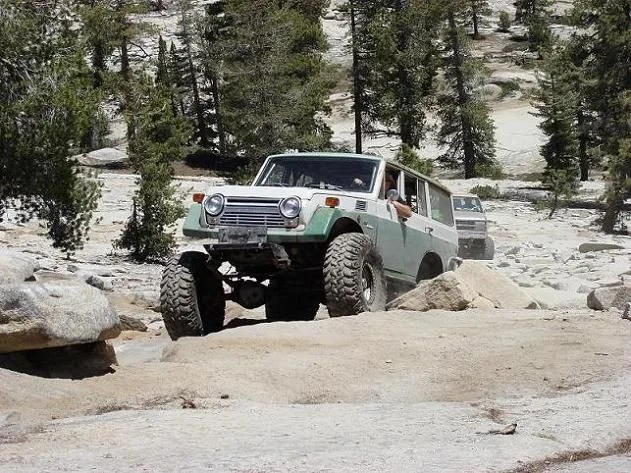

I made a run into Coyote Lake Labor Day weekend to camp.The new tube work made a HUGE difference.Thats exactly what it needed.
