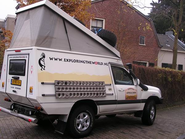

This 100 conversion has been featured here on MUD before and seems closest to what you are describing.
http://www.exploringtheworld.nl/
Pretty close to what I want too! :D

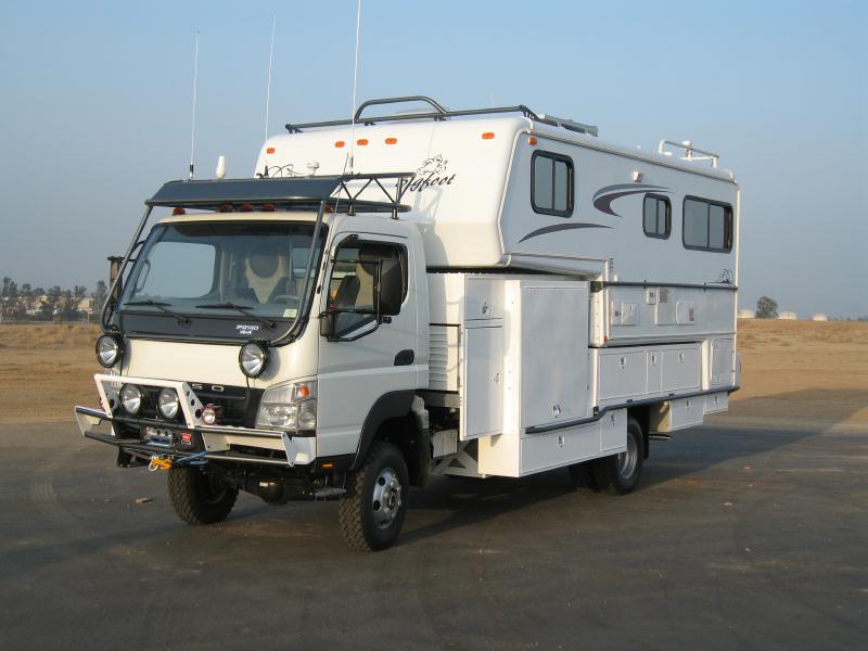

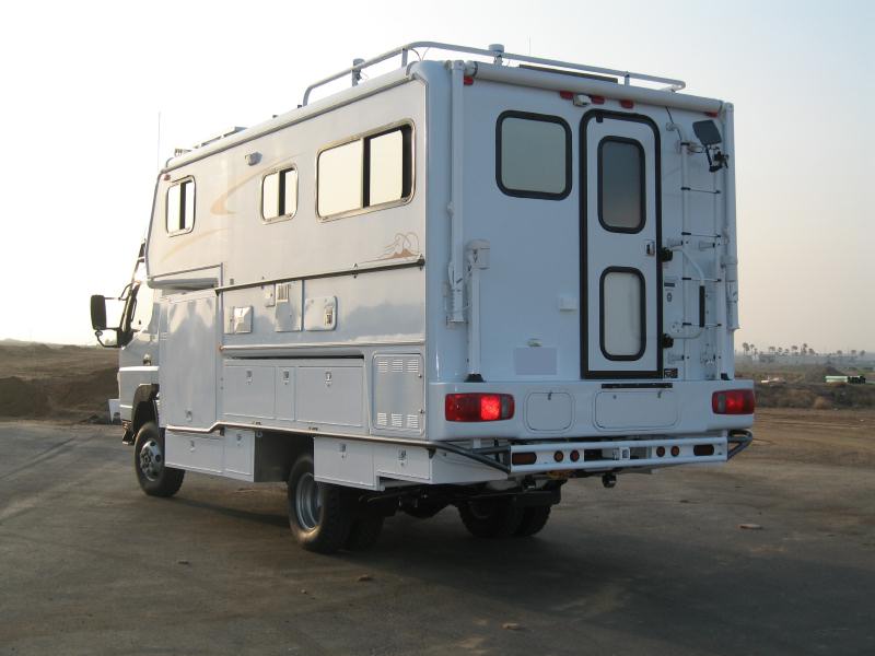

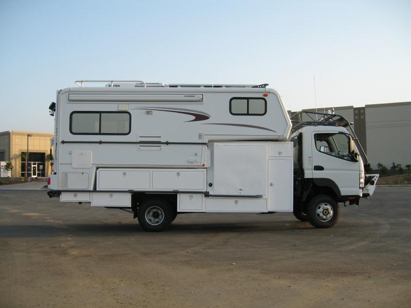

Project Complete
This project all started right here on mud. I want to thank all of you guys for helping me out when we knew nothing. Not that we know anything now, but we've come a long ways from my first post asking for help.
I know this is not LC100 related, but I wanted to let you all know how things turned out.
Thanks again for your help. This is a super group of people on this forum.
Project complete Sunday 3 June, 2007 ~8PM PDT / 0300 GMT / Zulu
Rollout shot:
  • Project: Hackney Expedition Vehicle
  • Goal: Self-sufficient, Self-Extracting Global Expedition Vehicle
  • Mission: 2 - 3 years of unsupported exploration primarily in developing countries
  • Project time: One year
  • Build time: Nine months
  • Project type: Private
  • Funding: Privately funded, no commercial sponsorships, endorsements, financial or product support
  • Concept design: Douglas Hackney - inspired by an FG/Bigfoot design of Carl Hunter
  • Bumpers, frame extension, pivot frame, storage box, etc. design and implementation: Mark Johnson
  • Electrical, plumbing, electronics, etc. systems design and implementation: Douglas Hackney
  • Custom storage boxes: Fleet Metal Box
  • Powder Coating: Jerico Metal Fabrication and Powdercoat
  • Chassis: 2007 Mitsubishi Fuso FG 140 4x4
  • Camper: 2006 Bigfoot 20C10.11FR
  • Engine type: DOHC 4-stroke cycle, water-cooled, turbocharged, intercooled diesel
  • Power: 147 HP @2700 RPM / 108.12 KW
  • Torque: 347 ft/lb (lbf/ft) @1600 RPM / 47.97 kgf/m
  • Displacement: 299 c.i. / 4.899 liters
  • Bore/Stroke: 4.49x4.72" / 114x120mm
  • Drivetrain: four wheel drive, manually selected, dual range
  • Front axle: open
  • Rear axle: limited slip
  • Transmission: 5 speed manual
  • Overall gear ratio (1st Gear - Low 4 Wheel Drive): 64.2:1
  • Top speed: ~75 m.p.h. / 120.70 k.p.h.
  • Cruising speed: 60 m.p.h. / 96.56 k.p.h.
  • Tires: Mud & Snow Yokohama Y-7428 LT742 235/85R16; 3 polyester plies sidewall, 2 steel plies tread
  • Spare tires & wheels: two
  • Overall length: 27.17' / 7.98 meters (tip of front bumper to rear bumper)
  • Overall height: 12.04' / 3.67 meters
  • Overall width: 8.58' / 2.62 meters (rub rail to rub rail)
  • Front axle track: 65.6" / 166.62cm
  • Centerline to centerline rear duals: 10.75" / 273.05mm
  • Outer edge of tire tread to outer edge of tire tread - front: 71.75" / 1822.45 mm (stock tires)
  • Outer edge of tire tread to outer edge of tire tread - rear: 79.00" / 2006.60mm (stock tires)
  • Wheelbase: 154" 12' 10" / 3.91 meters
  • Turning radius: 28.2' / 8.56 meters (outer tread edge of outer front tire)
  • Mid Wheelbase ground clearance: 15" / .381 meters (stock tires)
  • Minimum ground clearance: 12.5" (xfer case skid plate) / .318 meters (stock tires)
  • Front differential ground clearance - max load: 8.5" / 215.9mm (stock tires)
  • Rear differential ground clearance - max load: 7.625" / 193.68mm (stock tires)
  • Horizontal centerline front differential, max load: 14.375" / 365.13mm (stock tires)
  • Horizontal centerline rear differential, max load: 14.125" / 358.78mm (stock tires)
  • Breakover: 79 degrees (from vertical at mid wheelbase), 11 degrees from wheels (stock tires)
  • Approach angle: 29.4 degrees (to front cab step) (stock tires)
  • Departure angle: 17.1 degrees (to departure caster wheels) (stock tires)
  • Top of rear wheel to box: 7.25" / .184 meters (stock tires)
  • Bottom of frame rail to ground @ rear axle: 26.5" / .673 meters (stock tires)
  • Bottom of frame rail to ground @ front axle: 29.5" / .749 meters (stock tires)
  • Chassis (everything except the camper) % of total weight: 63%
  • Camper % of total weight: 37%
  • Front axle % of total weight: 36%
  • Rear axle % of total weight: 64%
  • Left side % of total weight: 51%
  • Right side % of total weight: 49%
  • Left front % of total weight: 19%
  • Right front % of total weight: 17%
  • Left rear % of total weight: 33%
  • Right rear % of total weight: 30%
  • Center of gravity behind front axle: 98.14" / 249.28cm
  • Center of gravity from passenger outer tread: 36.19" / 91.92cm
  • Center of gravity height: 58.92" / 149.657cm (estimated based on tilt test)
  • Maximum left roll angle: 31.12 (estimated based on tilt test)
  • Maximum right roll angle: 31.56 (estimated based on tilt test)
  • Maximum back roll angle: 43.48 (estimated based on tilt test)
  • Maximum front roll angle: 59.02 (estimated based on tilt test)
  • Shocks: Bilstein
  • Springs: Deaver
  • Rear sway bar: 1.25" / 31.75mm x 36" / 91.44cm
  • Camper & storage box frame: three point pivot
  • Pivot frame suspension: 50/50 Fox shocks
  • Front winch: 16,500 lbs. / 7,484 kilos
  • Rear winch: 16,500 lbs. / 7,484 kilos
  • Fuel capacity: ~100 gallons / 378.54 liters
  • Range: >1,000 miles / 1,609 kilometers
  • Fuel tanks: dual saddle
  • Fuel filters: dual one micron with online hot swap backup
  • Genset fuel rate: ~.2 gallons / .76 liters per hour
  • Air compressor: 4 cfm / 113.27 liters per minute
  • Air tank: 4 gallon / 15.14 liters
  • Maximum system working pressure: 150 psi / 1034 kpa / 10.34 bar
  • Air seats: dual, 3" stroke, 5 air bladders, heated
  • Air horns: triple, 152 decibels
  • Drinking water capacity:
  • Raw, filtered & unsterilized: ~45 gallons / ~170 liters
  • Fresh, filtered & sterilized: 33 gallons / 125 liters
  • Total: ~78 gallons / ~284 liters
  • Raw water input: any fresh water source
  • Drinking water filtration: <1 micron
  • Drinking water purification: activated charcoal, Ultraviolet light sterilization
  • Raw water input pump rate: 7 gallons per minute / 26.5 liters per minute
  • Gray water: 32 gallons / 122 liters
  • Black water: 32 gallons / 122 liters
  • Sewage macerator pump output hose: 75 feet / 22.86 meters
  • LP capacity: ~20 gallons / 75.7 liters
  • House bank batteries: 840 amp hours
  • House bank dedicated alternator: 135 amps
  • Solar panel output: 19 amps
  • External AC input: 120/220 VAC / 60HZ, 30 amps single phase
  • Guest power output: 120/220 VAC / 60 HZ, 20 amps single phase
  • Diesel genset: 30 amps 120V single phase
  • Inverter: 3000 watts, 120V single phase
  • Internet access: global
  • Bandwidth: >200kbs
  • Voice communications access: dual global, cab and camper external antennas for primary, camper external antenna for backup
  • Local voice communications: GSM 3G
  • Low data rate access: global
  • Emergency Beacons: EPIRB 406 MHZ global
  • Radios: VHF (bike to bike, bike to truck), CB (US band)
  • GPS: one fixed, three portable, cab and camper external antennas
  • LAN: Gigabit Ethernet
  • WLAN: 802.11g
  • Data storage: 2TB configured as 1.5TB RAID5
  • Document handling: color scanner/copier/ink jet printer 8.5x11" / 21.59x27.94cm
  • Photo printing: 4x6" / 10.16x15.24cm dye sublimation
  • Cab video: DVD playback, rear color camera w/microphone
  • Cab stereo: 300 watts, four 4.5" / 114.3mm drivers, one 10" / 254mm subwoofer
  • Camper stereo: 70 watts, four 5.25" / 133.35mm drivers
  • Camper TV: 25" / 63.5cm LCD HD (US standard ATSC)
  • Camper TV sound: 5 channel Dolby/DTS wireless headphones
  • Camper TV playback: upconverting DVD
  • iPod integration: cab and camper
  • Berth: fixed ~60x80" / 152.4cm/203.2cm
  • Head: dry, fixed shower
  • Range/cooktop: three burner
  • Oven: convection microwave
  • Furnace/heater: 30,000 BTU
  • Water heater: 6 gallons / 23 liters
  • Refrigerator (3 way: LP, 12VDC, 120VAC): 6 cf / 169 liters
  • Air conditioner: 11,000 BTU
  • Galley sink: dual
  • Integrated exterior LP Grill: 12,000 BTU stainless steel
  • Primary chassis materials: steel, stainless steel, aluminum
  • Primary camper materials: chopped mat fiberglass & wood ply sandwich cored with injected foam, wood, single layer fiberglass
  • Camper glass: dual pane
  • Camper leveling jacks: electric / manual
  • Fire extinguishers: Four ABC type (cab - 1; storage boxes - 1, camper - 2)
  • Ditch bags: two
  • Vehicle recovery kits: one
  • Winch line extensions: two
  • Winch anchor: 14,000 lbs / 6,350 kg capacity
  • Hand tools: ax, cross bow saw, pick, short and long shovel, pry bar
  • Pneumatic impact wrench: 1/2" / 12.7mm 500 ft/lb / 69.13 kgf/m
  • Locking external storage capacity: 268.01cubic feet / 7.59 cubic meters / 7,589 liters
  • Camper internal storage: 92.98 cubic feet / 2.63 cubic meters / 2,633 liters
  • Total storage: 360.99 cubic feet / 10.22 cubic meters / 10,222 liters

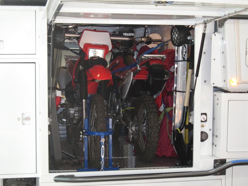

  • Auxiliary vehicle storage capacity: two motorcycles up to 94" / 238.76 cm long and 48" / 121.92cm high (taller bikes can be accommodated if you compress the forks)

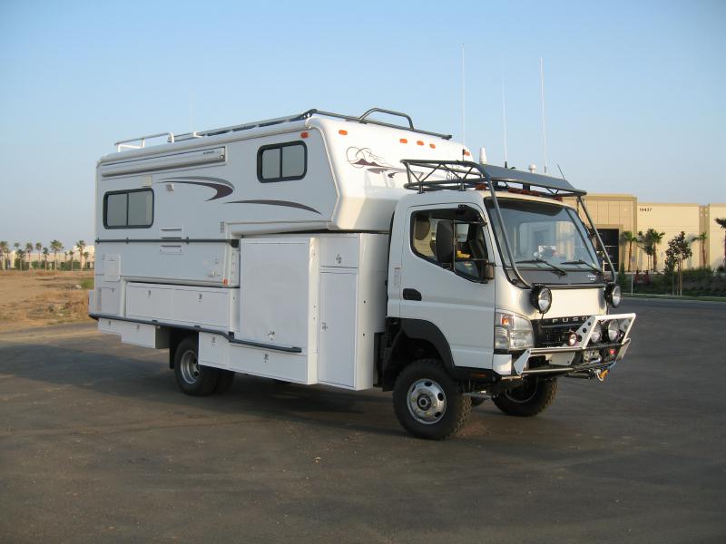

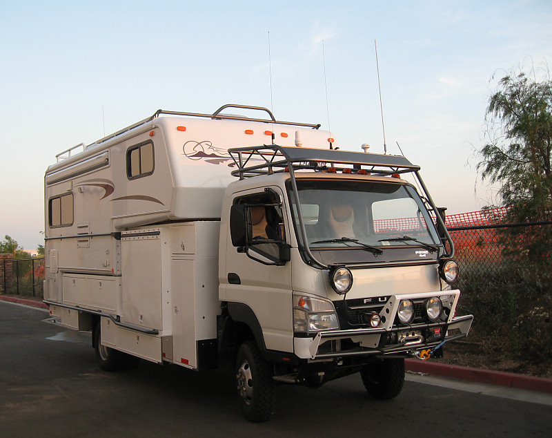

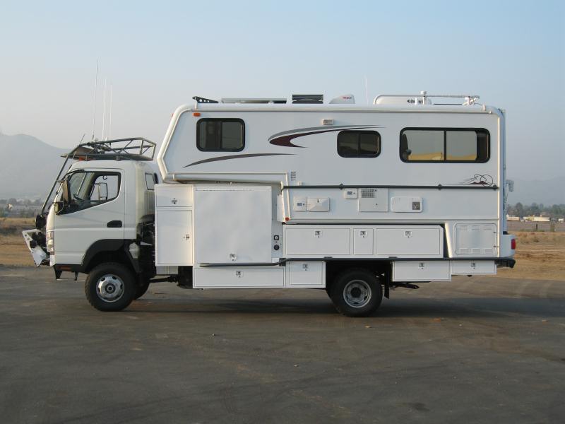

Other views just prior to completion (missing some box corner / stone guards):

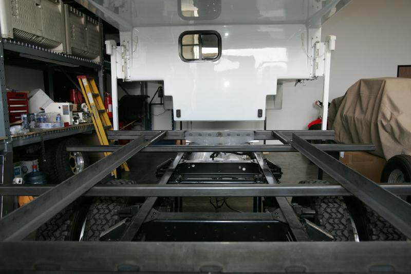

Project buildup photos are at:
BEV Buildup Photos
