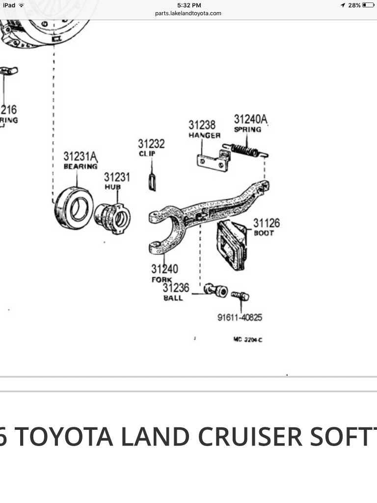

Hello All,
Do any of you know the correct name for these clips? They are the retainer clips that hold/stabilize the throw out bearing to the fork. I just noticed that the incorrect clips are on mine and I need to order them. Also if anyone has an idea where to order these that would be great too. Thanks ahead of time
Release bearing hub clip/spring
31232-55010
Good chance it's still avail.
any Toyota dealer can get these.
looks like you have a generic hair clip type retainer in there now.
