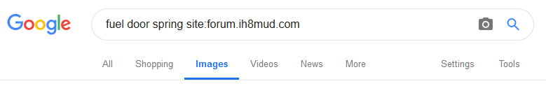

There's a Search icon top right each page.
Choose This Forum and try the words: fuel door spring, gas door spring, gas filler spring, gas door spring, etc, etc
It often takes some searching and reading to find what you're
looking for, here's a couple of results
