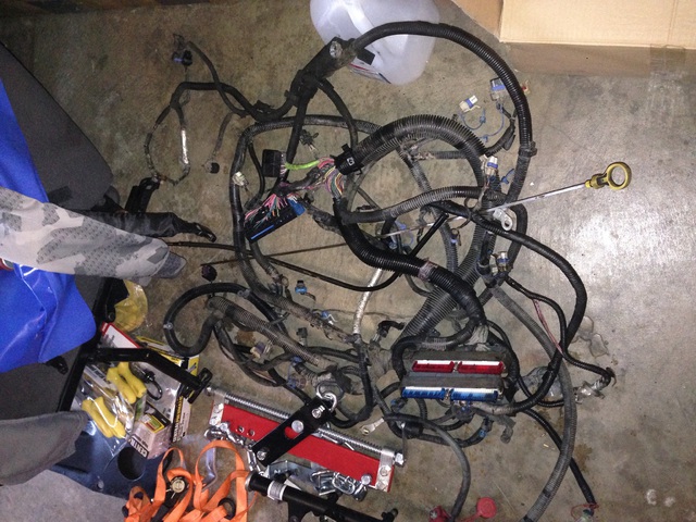

Here's what it looked like getting it home.

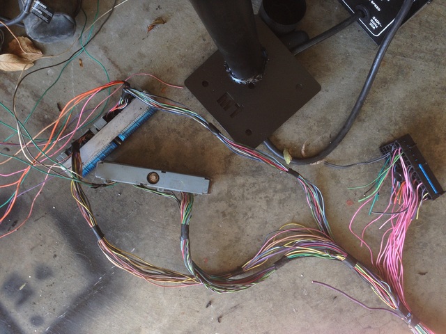

Here's the wiring harness off the motor.

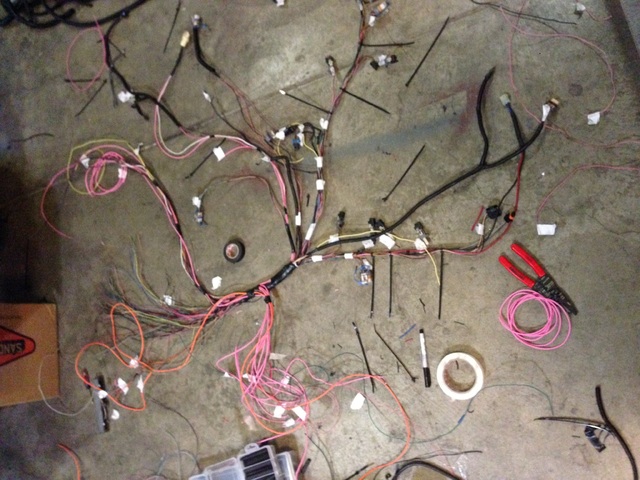

I have the PCM mounting tray from a van that I plan on mounting underneath the glove box, but the stock harness isn't set up to do this. SO I pulled ALL the pins out of the PCM connectors and pulled the entire wire harness apart so I could put every connector and ground circuit where I wanted. I ended up having to lengthen about 10 wires and shorten about 30. The pins are available from Mouser and several other electronics suppliers.
And here's what it looks like after I moved everything around. The bigger pink wires are for the start/run power to the PCM and relays.
