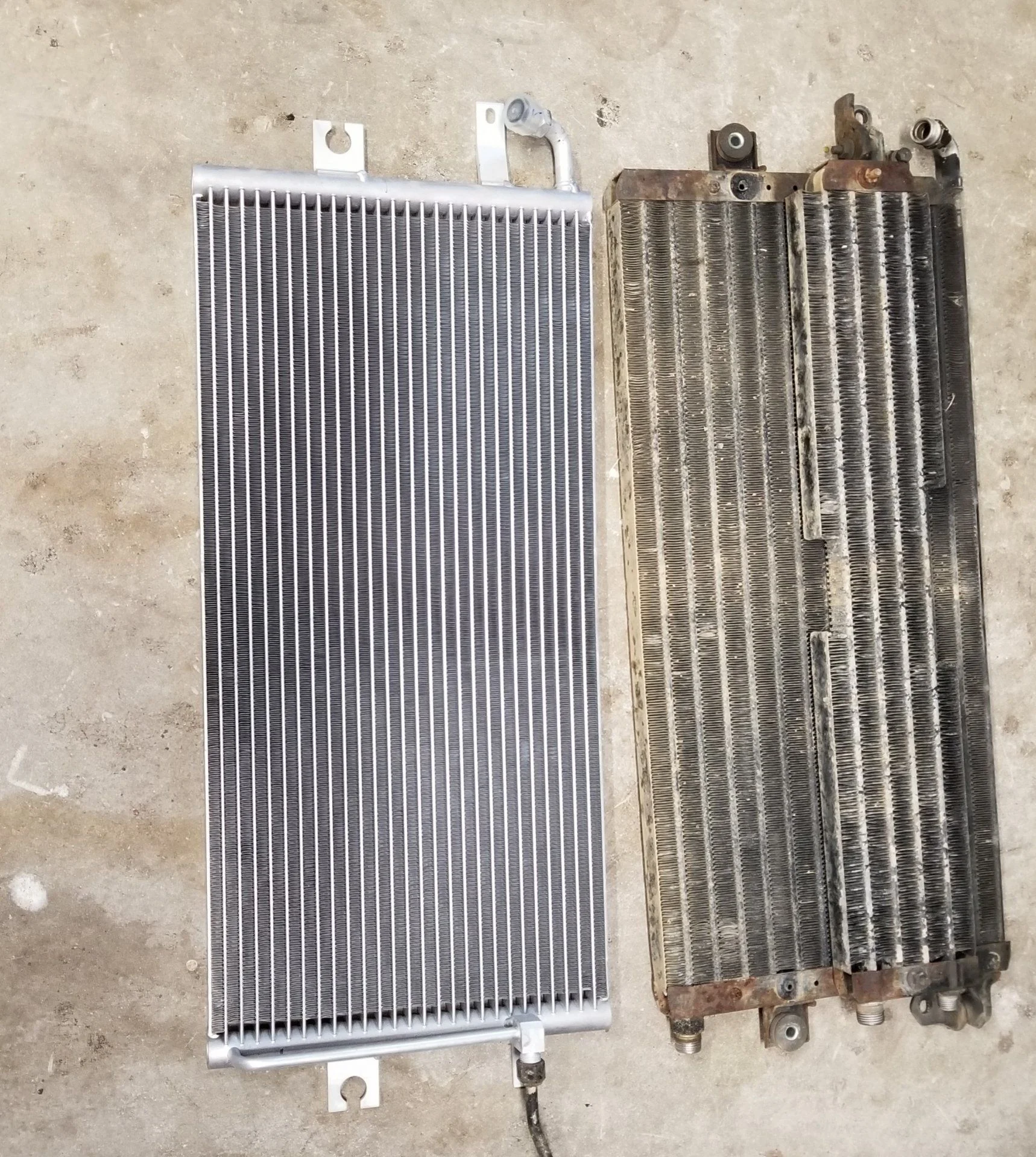

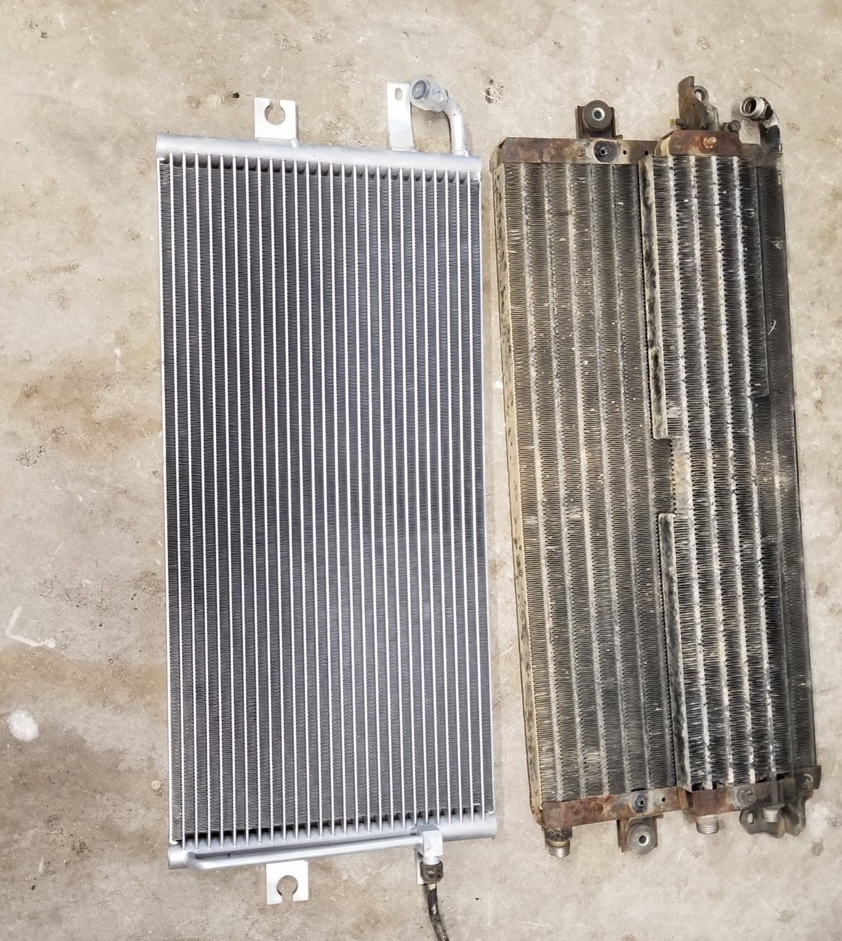

Ok, I have sortof a resolution...I was scouring eBay and taking a hard look at each listed condenser. There is a listing for an aftermarket condenser made by Pacific Best. It is listed as working for the 4Runner, fittings looked to be in right place, but I was concerned that it does not have that little extra condenser in front. Went to PacificBest website and looked it up by application and the details said it was parallel flow. This interested me and I think maybe explains why it does not have the extra condenser piece...parallel flow is supposedly more efficient so it may not need that extra piece to radiate same amount of heat.
Then I googled the PC4221 part number and found it cheaper on carid website... Like $71 shipped. I figured I'll take a gamble on this thing.
It arrived today and just eyeballing it next to my original, it looks like all the connection points are in the right place. I'm working right now so all I had time to do is open box.

Got it installed last night, everything fit up fine.
Regarding parallel flow vs OEM...the new parallel flow condenser has 26 refrigerant passages (and supposedly each passage has small tubes inside which makes more surface area for the heat to be exchanged). The OEM condenser INCLUDING the little front extra condenser has only 17 "passages". So if we are talking surface area for the refrigerant to exchange heat with the metal tubes, then this parallel flow seems like it wins that calculation.
The OEM condenser fins are larger, which maybe helps the OEM condenser shed heat to the air better.
So overall, I don't know, it might be a wash I'm not sure. But I do think the parallel flow condenser will be at least as good as the OEM.
I still have to get a few more things put together, system vac'd, and then charged, so we'll see, fingers crossed I get some cold air.
Following up on this. All installed, vad'd and re-charged and so far things are working.
