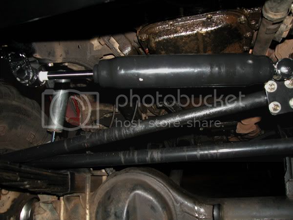

Here are some pictures of my Marlin Crawler high steer. I didn't run a steering stabilizer at first, but while attempting to figure out a death wobble issue (which later I found to be caused by improperly set toe :bang:) I bought one and installed one. It did help tighten up the steering a little, especially on washboard roads and such, but otherwise it didn't really do much. Since I spent the money on it, I am gonna keep it, but as long as your steering is set up properly and your alignment is done right, they don't do enough for me to suggest you get one. Buy a high steer kit, install it right, check your alignment and enjoy. Its gonna get ditched once I go hydro assist, but for now I am just gonna leave it there.
Here is before the stabilizer:
And after:
