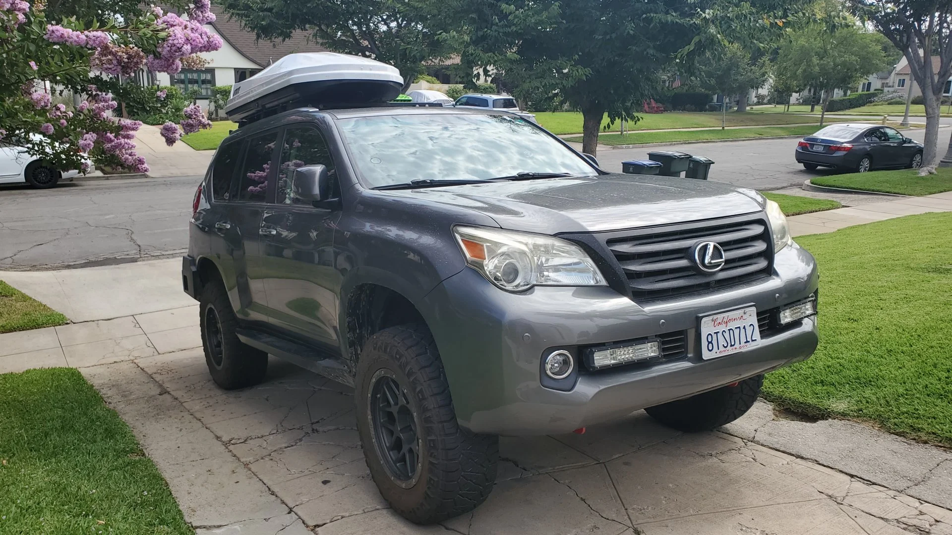

I had to modify the U-brackets. I went and got longer SAE brackets and bent the U to narrow the distance in order to fit around the LFD bars and yet go into the existing mounting holes for the carrier. I had to take off the fairing to get a better fit with regards to the support. I run five LFD bars to give me more mounting options for accessories. In turn it provides more support for the carrier.

Just to clarify, the U-brackets that came with the box were used for the thinner part of the bars. I used the longer, modified U-brackets on the thicker portion of the bars.

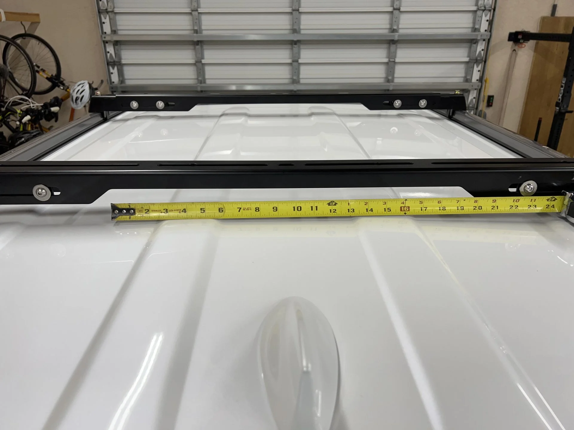

Most boxes that I'm seeing have a wider than 19" left to right spread on the bar clamps...
Search for a used Yakima Rocketbox. Mine has 11" between the mounts. But the overall box is narrow, so the opening would be mid-roof as well. But they'd definitely fit in that space on your LFD bars.
I have the Yakima CBX 18 for my load bars and it is HUGE and fits with the low clearance 470 midguard load bars on my 460. The width of the mounts outside to outside is 21"
