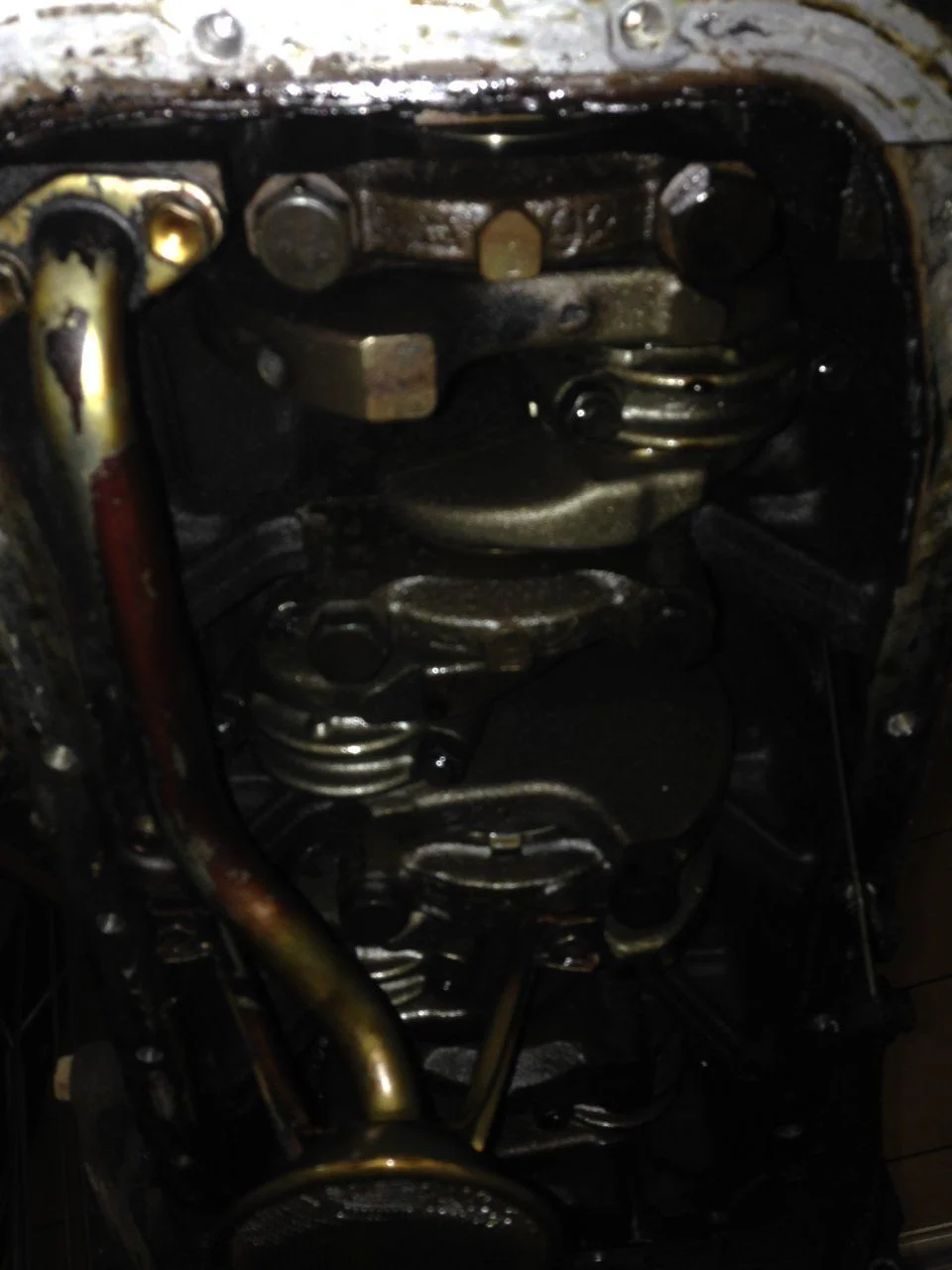

Hey guys I'm working on a 22re motor out of a 90s I was seeing if anyone can give me a torque spec on the main bearings. Anything would help thanks
Anything I need to look for to see if the motor is still good or not?
