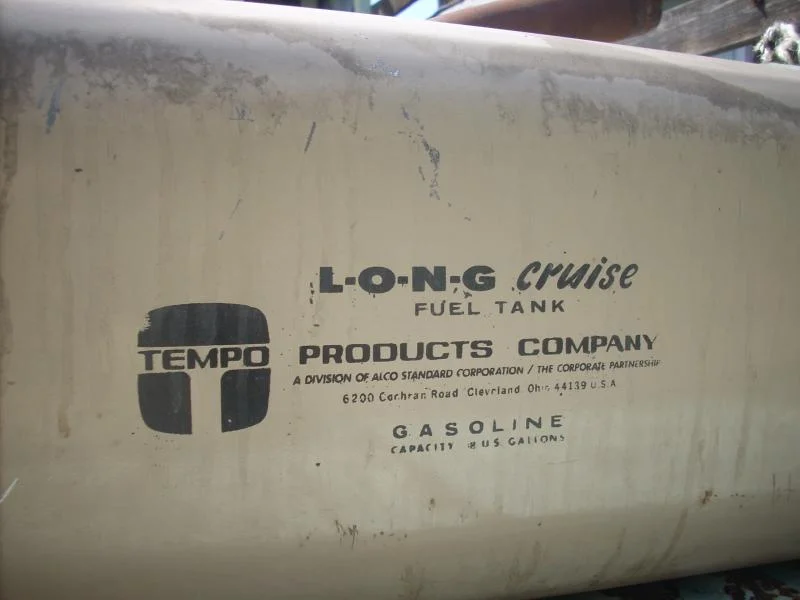

I looked into a second tank for my 45 shortly after getting it many years ago.
I searched MUD and found that someone had installed the gas tank from an early S-10 pickup under the bed in front of the axle.
I'm not sure a search today would easily get you that thread, what with there being 50,000,000 posts on MUD.
95 ? S-10 pickup was too long if I recall.
S-10 blazer was needed someone said I think.

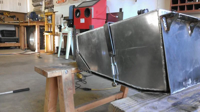

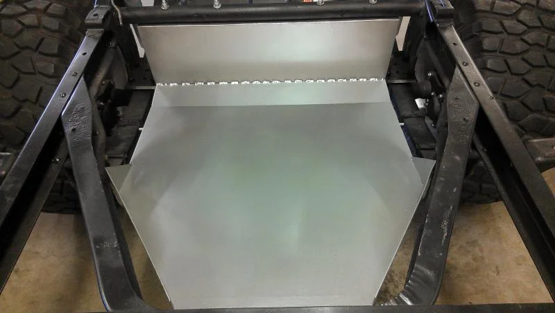

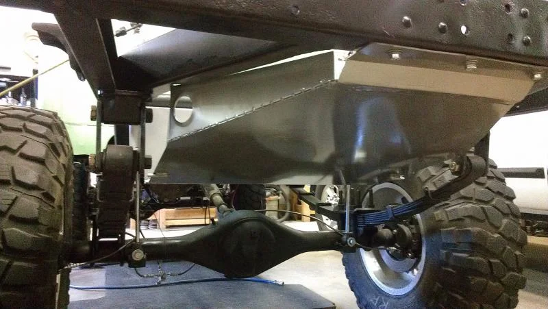

When I did my 63, my friend who was a aluminum boat builder helped me out on a tank. This one holds 30 gallons and tucks up pretty good. It rides in a skid plate and has straps above. I used the factory Tacoma intank fuel pump to feed my 5VZFE.

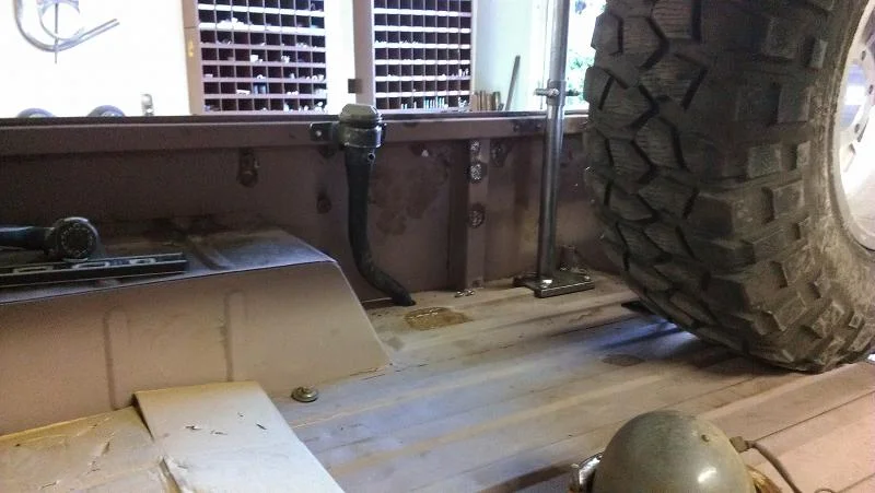

In 2013 I found this boat tank on craigslist. After a few Road trips to Texas and Iowa I needed more range if I was going to make it Cross Country. Worked out really well since the float was already 12volt it was easy to hook up a servo to switch tanks and use the factory fuel gauge for both tanks.
This is how I chose to put the filler neck in. Just didn't want to cut the bed.
Nice tank that is what I was thinking of who made it.
Parker Garrett did and I'm more than thankful that that man had a touch on my vehicle. Unfortunately he passed away way too young in his 30s but you could build a tank like it with a good aluminum fabricator.
