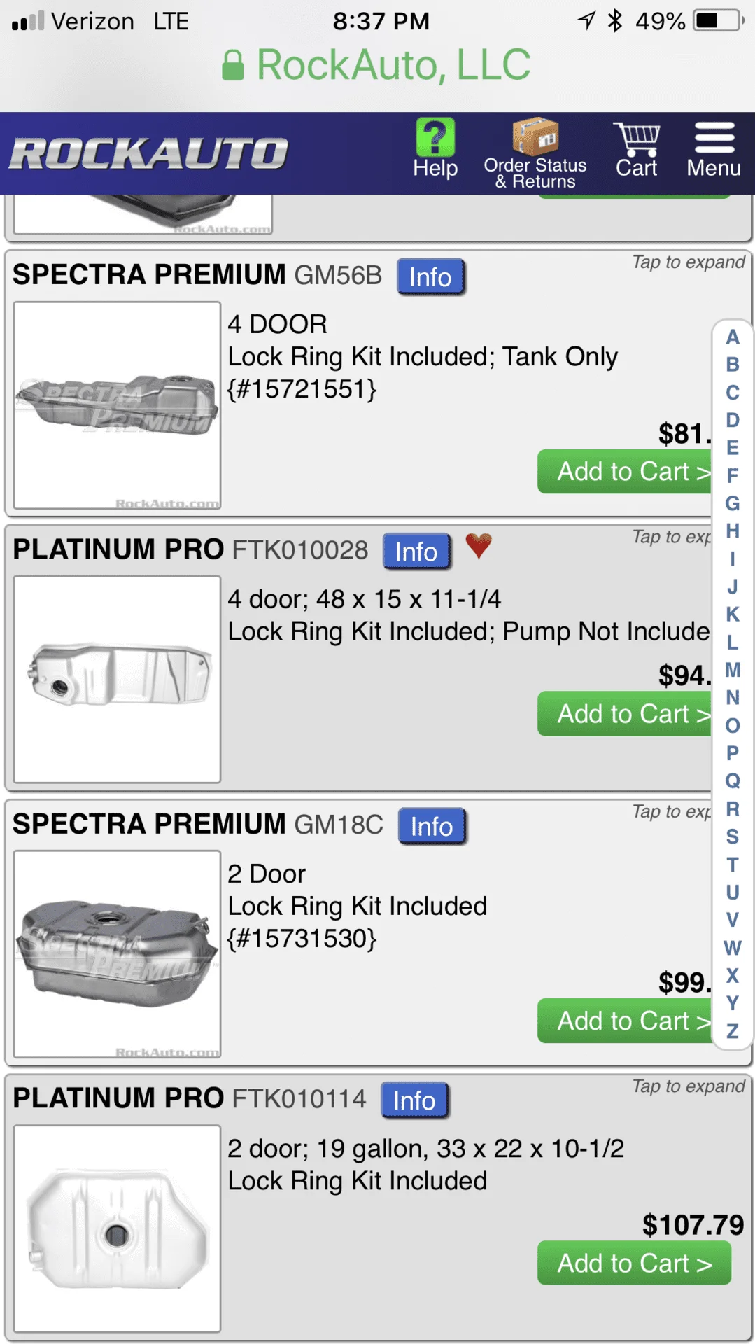

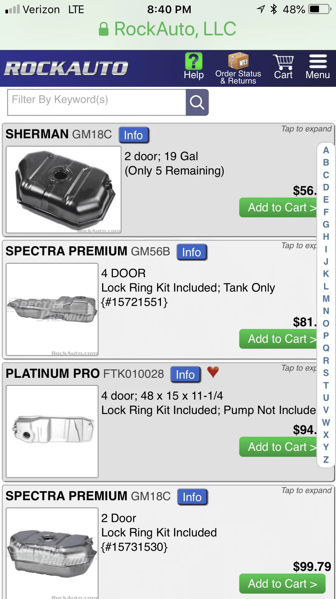

If you go the Blazer route, you need the tank from a two-door model (Not the 4-door). They are relatively easy to find in a salvage yard or you can buy new ($56 to $98 on RockAuto).

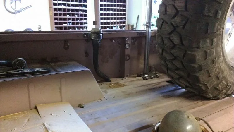

I went with an old Con-ferr tank style setup for the FJ40 in my 45. Mounted behind the rear shock mount, flush with the top of the frame and ran the fuel lines down the inside of the passenger frame rail. It took some time to configure, but it will be well worth it in the end. BTB sells a similar kit.
I did the same. Tough to route the exhaust out of the rear, but it fits very nice. I welded a filler neck from a 40 into the bed side since my bed is just home built.
