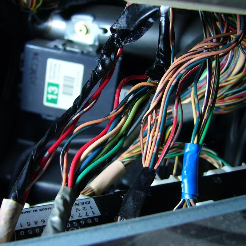

in order for you to see the DVD while in motion, you must take the head unit out as mentioned in this post, snip a wire, and ground another before it will show the video..all you did was enable some nav functions that are disallowed during driving...ie make an appoinment in your calendar, and edit routes in the nav during the drive.....

I've modified my 2005 Land Cruiser exactly as described in this thread and the mod definitely worked. The only problem I've noticed is that my break light is always on now. Not a big deal, but I wonder if anyone might have an idea as to why the break light remains on? Obviously, I've checked to make sure the parking break was not engaged. I soldered my ground wire to the exposed portion of the red/white wire, covered it up with tape, crimped and soldered a connector on the ground wire, and attached it under a screw on the metal frame of the navigation head unit. I have not disconnected the battery. I do wonder if my point of ground was not the best choice, but it sounds like I did what others did as well.

After a DVD hack, the parking brake light will stay on, as this is what happens when you ground the parking brake wire. This makes the computer think that your parking brake is engaged, a prerequisite for making the DVD work. The other prerequisite is making the speed sensor believe that you are not moving. This was done by cutting this wire. Hope this helps.

Can you tell me which wire?
I have a 2003 TLC 05/03 to be exact
I snap a picture
Can anyone point out which wire?
Thanks
according to MARCVP's image, I think it is the 2nd group from the right with black electrical tape.
Then I know which RED/WHITE to ground.
But which Violet is it?
I have another picture to show the detail.
Thanks

Can anyone provide me with a picture of the back of their 04 LC Nav? I need to see the plug and what the wiring harness looks like. I remember seeing one somewhere and have loooked with no luck finding it. Thanks.
