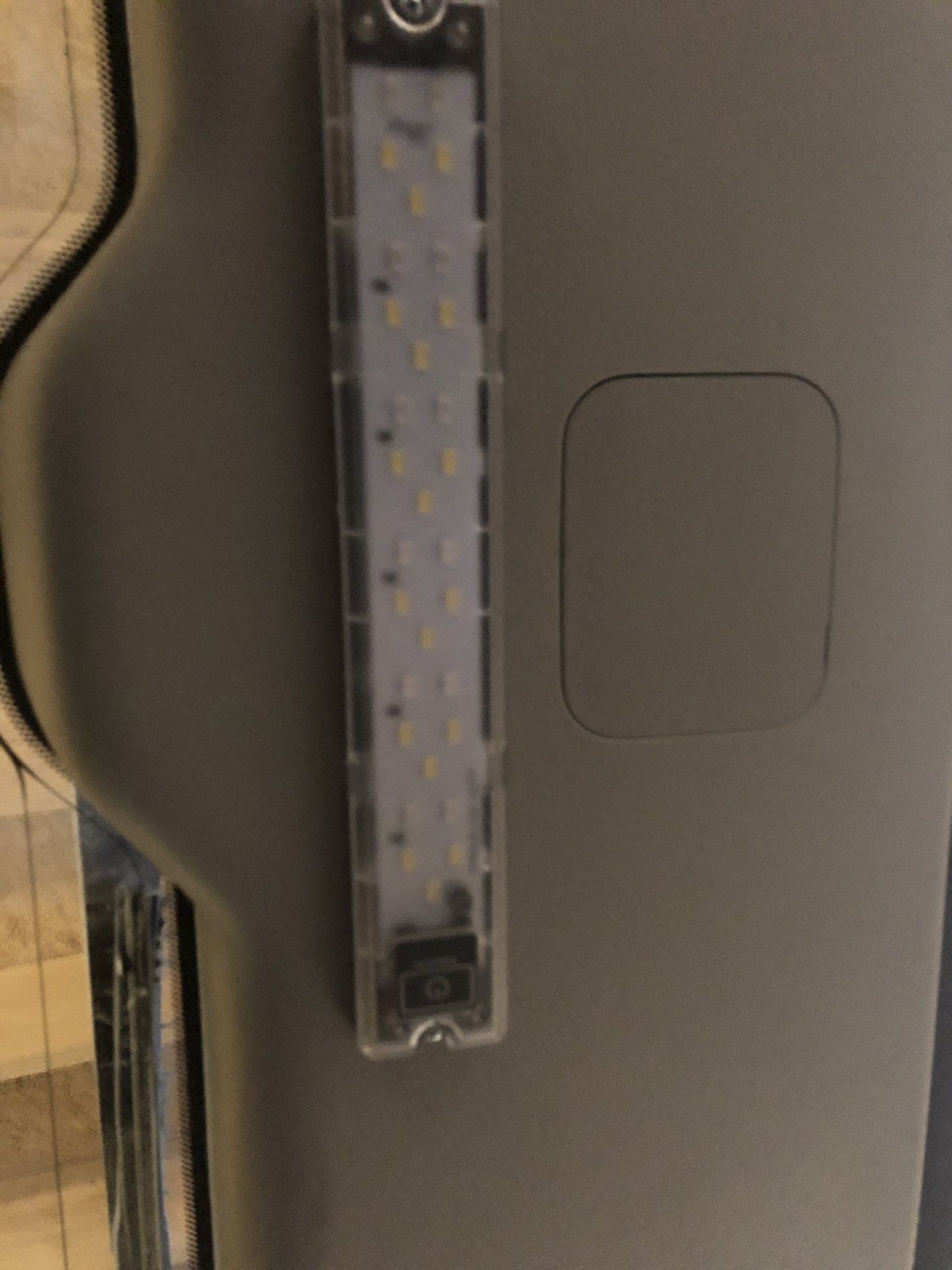

Installed and working.
For future searchers:
  • The rear of the headliner is held up by panel clips, one left, one center and four on the right that hold the ceiling mounted seatbelt - I had to pop these out carefully to gain access to fish wires
  • The seatbelt trim pivots down at the front first, the rear has arms that extend up over the headliner - if you pull the rear down first, you could damage the headliner
  • The cargo light is removed by inserting a thin trim tool into the leading edge of the lens and popping the lens off, then there are two plastic tabs, one on each outboard end, that need to be pushed inboard to release the light housing
  • I used a length of copper wire (a strand of 12 ga from a section of Romex) to fish the wire through above the headliner
  • The wires on the cargo light are very small - like 22 gauge or something
  • On my car, the harness for the cargo light was very short, and challenging to work with
  • Red is power, white with black stripe is ground
  • Not sure if it is just my vehicle, but there was some nasty black grease-like consistency substance behind the hatch seal that I had to be careful to not get everywhere
  • I don't know what the two capped wire plugs inside the hatch are for, but I can tell you if you unplug them, the external hatch release stops working
  • My wires are probably way oversized, I used the only red/black wire I had handy, which was 14 gauge - hopefully this isn't a problem - the wires on the National Luna light and the OEM cargo light are both tiny (maybe 22 ga?)
  • The blue backlight on the touch switch is much more dim in real life than it comes across in the pictures
One thing that is interesting (cool?) is that if you leave the hatch open until the interior lights shut themselves off, the National Luna light also turns itself off - including the blue backlight on the switch...
After that, the power switch on the National Luna unit won't turn it on.
I'm 50/50% whether this is actually cool. On one hand, it addresses the parasitic drain concern. Then again, if I'm camping and I leave the hatch open, it'd be nice to be able to turn the National Luna on with the switch...
Depending upon which way you prefer, you might want to run your power wire to a battery power source instead of the overhead cargo light.
