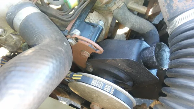

View attachment 1422190 View attachment 1422189
What PS bracket is that? Mine is a hodgepodge of chaos/metal combined with some crappy welds the PO came up with.
The pump bracket is from JT Outfitters. Seems to work pretty well, and is a *great* improvement over the hodgpodge of poorly-fabbed metal bracketry that the PO installed that was impossible to tighten.
I had a mechanic install it and he had a bit of trouble displacing some of the smog system vac lines to get the braket in (on 79 CA-smogged truck).
Polo
Polo
Perfect. I'll have a look at it. Yeah, mine is a disaster.

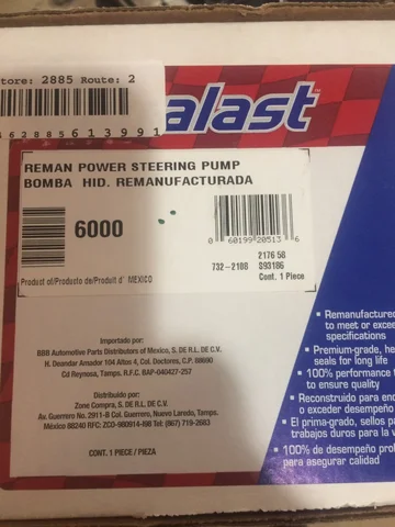

Got my #6000 pump from Auto Zone Friday.
FYI: The mounting bolt hole threads, both front (4) and rear (2) are not metric, but are SAE 3/8 - 16. I used some 3/8-16 all thread, to make some custom studs for mounting.
The high pressure hose I got from Orange45 fits the pump perfectly.
