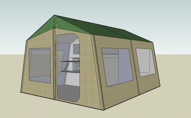

Is this the tent you designed? Same as post 2 illustrations?
Not so much designed as had modified for my needs. Still need to install and verify the modifications will work.

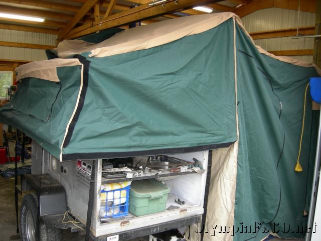

Picked up the tent. I set it up quickly or some pictures and get a first impression. Of course it was raining so I had to set it up in the shop. I was not able to open the annex and install the walls but the main tent fit (just barely) and I like what I see so far. Well made with heavy sippers and double seams. I have some questions on the travel cover but everything else looks pretty good. Now I just have to figure out how I’m going to mount it to the trailer. I think a bit of extra bracketry is required and will have to pack the tent back up and flip it over to get a better idea. I will get more pictures one I get it permanently mounted and can set it up outside.
A few more pictures at http://www.olympiafj60.net/off-road-tent-trailer-build-part-3.html
I customized it in the features I wanted but it can be fitted to most any trailer. I had it narrowed just a little to ~66" and it is 90" long. Once I get the mounting figured out I will put more detail here. I was thinking of making a frame to easily mount it to the military trailers too. Something that could just be bolted or welded to the trailer.

The size of the tent closed is 90" (~7.5') long, 66" (5.5') wide and between 6"-12" tall. The width was selected because that is the width of my trailer outside fender to outside fender. I believe the M416 is roughly the same. The base is designed to sit 54" off the ground. Open, the tent is 17' wide and 15' long (7.5' each for main room and awning). The peak is 8'. The tent fabric is 10oz rip stop poly cotton canvas and the floor is 13oz PVC. Polls and ladder are steel. The base is 3/4" marine grade plywood with a metal frame under for added support. There are two hatch doors in the base for easy access to trailer storage once setup. There is a 3" foam mattress. The entire tent weighs roughly 350 lbs.
I am still working on the mounting. I am thinking of offering a mounting frame at additional expense or having the customer provide their own mounting method. The frame would fit customers trailer and have hinges, latches and struts.

So far the quality looks great. I have only had it set up in the shop though. I hope to have it on the trailer and get it set up outside next week. I will leave it up for a while and check for water leaks and get a good look at the seams from the inside on a sunny day. On the travel cover all seams are taped.
