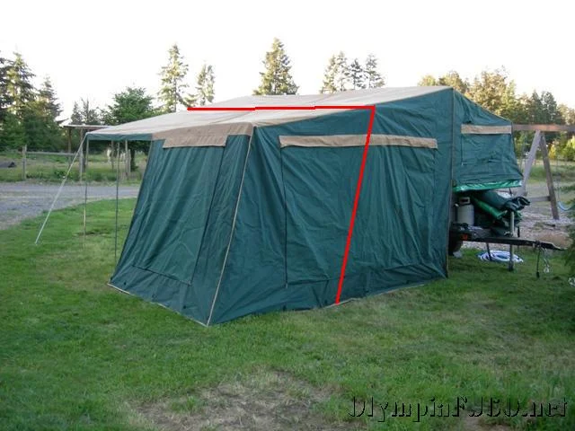

wow nice set up.. but man that thing is big is this the large version?
Yes this is the large one. Here is a paint pick, the red line showing the approximate size of the small tent. The small tent is also shorter on the trailer.

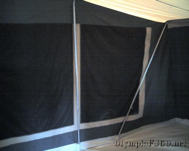

The tent wasn’t difficult for me to set up by my self the first time, but two people will be helpful. I started by removing the cover, removing and setting aside all the poles, guide lines, stakes and awning (annex) walls. Next I pulled the tent off the trailer spreading the PVC floor out as tight as I could. This also pulled the two ground length internal poles off the
The walls for the annex are as simple as Velcroing the three panels together and to the tent. They also Velcro along the top. Fully deployed, the tent has two windows with rain covers and six windows that can role up. All windows as well as the two doors have mosquito netting to keep bugs out.
