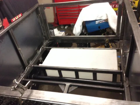

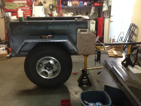

Looks good. I finished building one for a buddy in June. I couldn't find wide fenders so I ended up building some. I also added a 25 gallon water tank underneath. It hangs about 6" below the frame rails.
I'm building another one and decided to go with Toyota 3" lift leaf springs for a 4runner this way I hopefully can fit the water tank directly over the axle while still keeping it spring under and 35" tires.
this build has a huge progress since the last time I check the thread. great work. Those fenders seem to fit perfectly. its hard to find wide fenders. a friend of mine have been searching for weeks now.

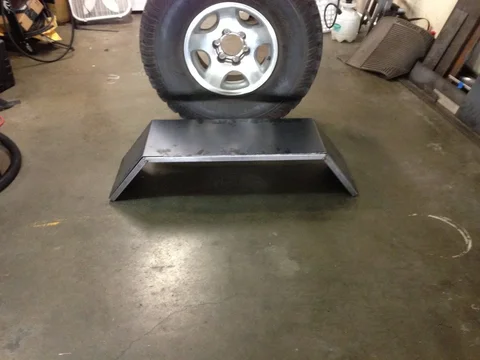

@Rwhat isn't it complicated to build up wide customized fenders? hope you can give me a link on your build. that sounds interesting too.
image.webp image.webp image.webp image.webp image.webp image.webp Here's some pics I have. Used 1x1 square tube. I used 16 gauge sheet and bent it in the swag fab metal press.
Sorry phone added 2 pics of each

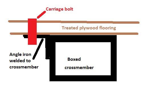

I thought about Liquid Nail but that stuff is a b!tch to remove when it came time to replace the ply. I thought u-bolts around the frame but that would only work for the 2 cross beams. Any tips on how to attach AND make it easily replaceable?
How about welding bits of angle iron along the cross members? You can then simply bolt the plywood down with carriage bolts. No holes in the frame.
