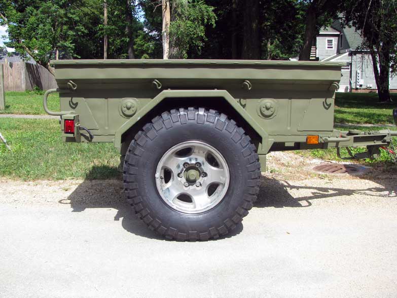

Fenders came in today and they are HUGE!!!! Had a hell of a time finding a 13" wide fender but glad I did. It'll cover the tires perfectly. I need to trim about 3.5" off the front and back to make them line up with the bottom of the frame. Pic is just showing width, fender will be mounted 4" above top of tire.

Those fenders fit your trailer perfectly! Same rigid lines as the trailer & fit the form good.
Thanks!:beer:
Mostly my design, with a little input from my welder. That was exactly the effect I was trying for, to make it look like the folks at DEW (the Canadian outfit that built it) updated their design for use behind something a wee bit larger than an Iltis.:D
