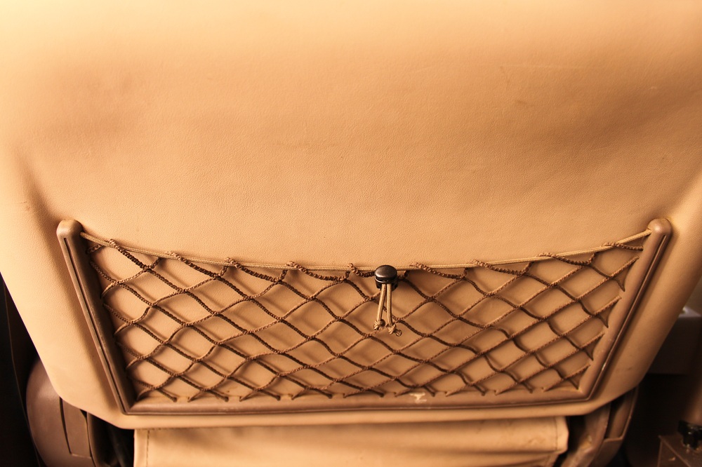

I cut the old bungie support lace in the center. I found this by pulling what stretch was left of it out and down. The net has nine openings across the top so the opening in the center will have four to each side of it.

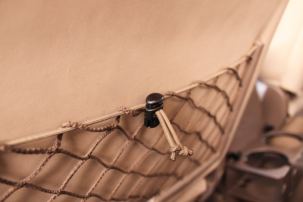

I then slightly melted each end to keep it from fraying. I am using the old lacing supports as they are strong and attached at each end. They just have no stretch left.
I then slid the lock lace onto the old lacing/bungie. I put them on so the writing on the lock lace was up right and when you want to release it you naturally push with your thumb from the top.
I then simply tied a knot in each end and cinched the lock lace up tight. This holds them up securely and neatly. When you want to put something in just squeeze and open. Cinch back up to secure.
Very simple and inexpensive fix. Those sagging nets were an eye sore for me and not useable.
I will note that the original lacing has to be pulled through the netting and re-weaved so that both come out in the center opening. Pretty simple to figure out when you look at it.

If you notice, you will want to start threading the lace from the back of both outer most net openings first. Then weave back and forth till the center. This way when you get to the center opening, both sides will be coming out of the cargo net from the back of this center opening.
