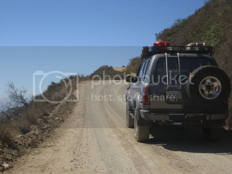

Good work. I am also a fan of the wildyoats style tire carrier, although I paid someone to weld it for me after I got all the parts and metal needed it for the project as I don't have any welding skills, and didn't require a full metal bumper yet for the type of wheeling I do. Still, I have put in over a hundred miles of dirt and easy to medium trails with the tire carrier at places like Joshua Tree, Anza Borrego and Baja with the carrier mounted. I think making sure there is no back and forth, and nor up and down free play of the swing arm is key for supporting the latch strap longevity and to avoid hearing any rattles coming from the carrier. The carrier does not make any noticeable shakes over rock gardens, or those pesky street bumps on street roads.
