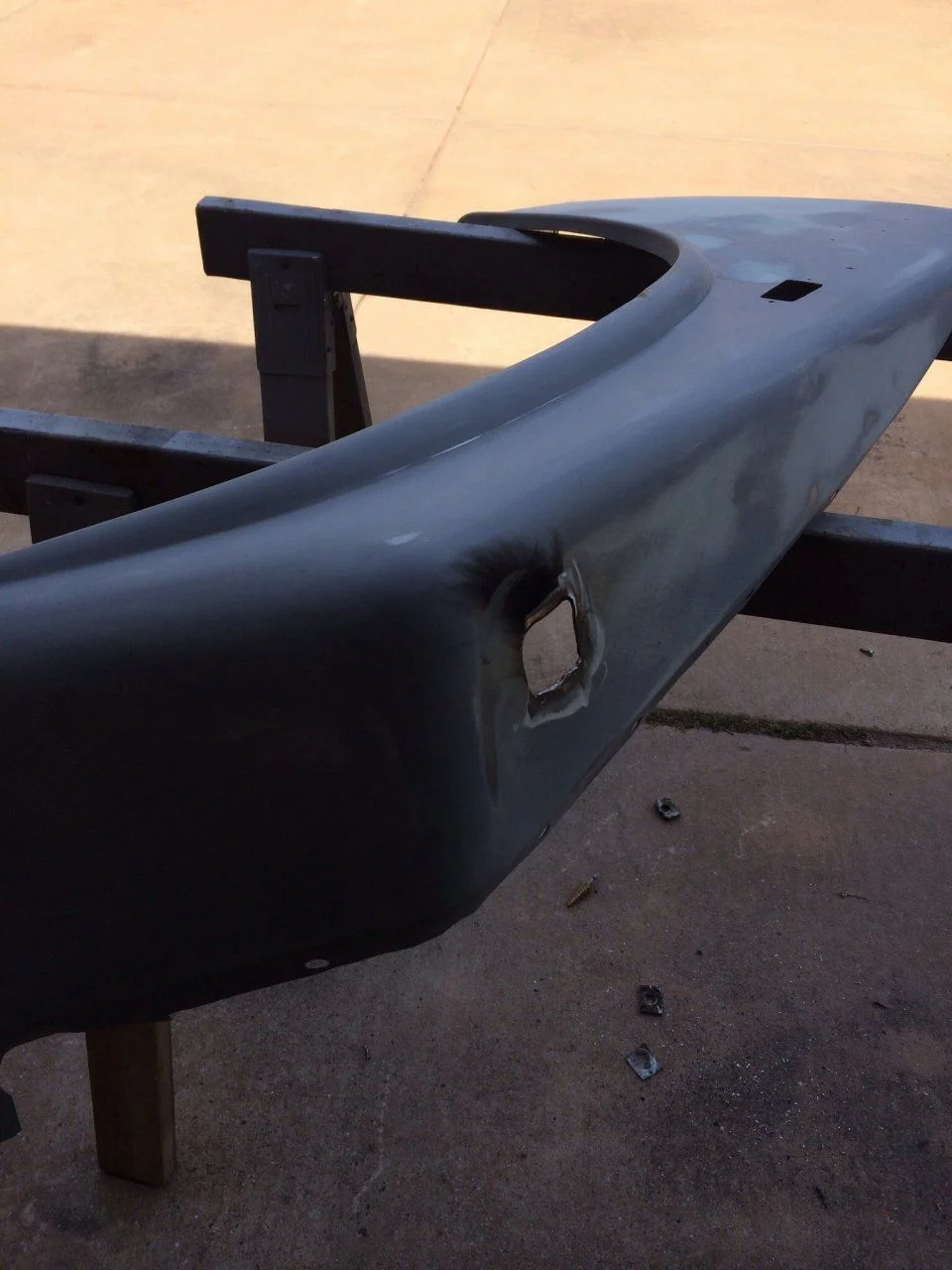

image.webp image.webp image.webp It been a while since I've updated. I've been tinkering on a few things like body work. I know it's sacrilege but I cut holes in the front fenders to mount VW beetle turn signals since I've never been fond of the stock light the way they scream "hit me". I wanted something a bit more streamlined but couldn't find any good alternatives.

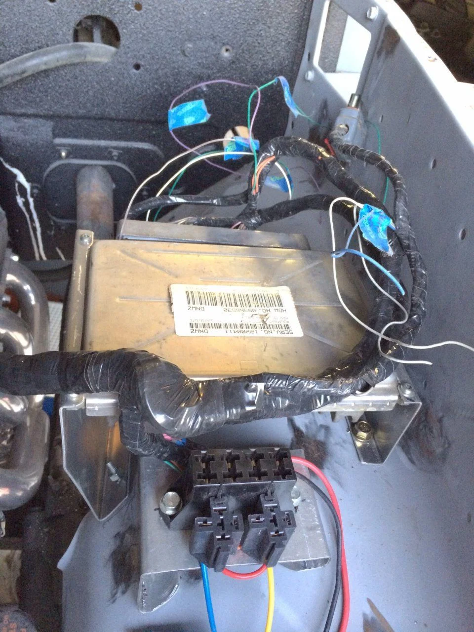

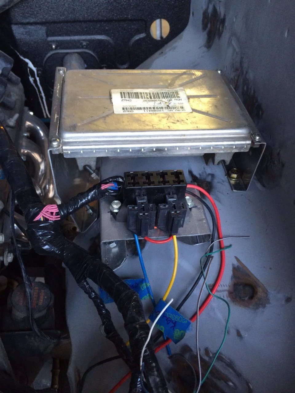

I also put my new sheet metal bender to work making mounts for the computer components.

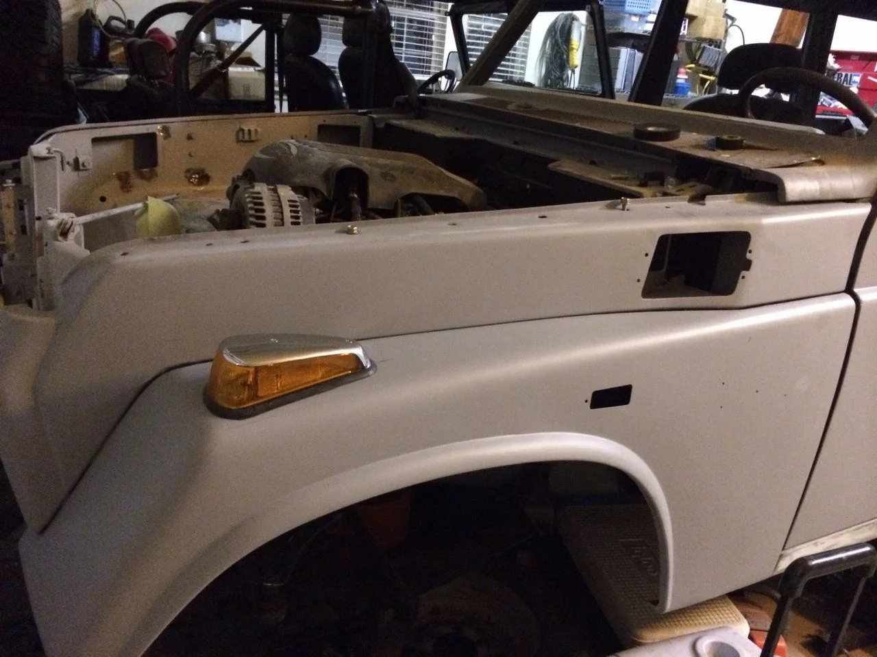

Need some opinions on the issue of turn signals and side marker lights.
I mounted my fenders so I could mock up the VW turn signals. I like the line of the turn signal but I'm wondering if the side marker light is now a bit out of place.
With the large side light on the turn signal, I don't think I need the marker and I'm not sure if they'll look good together.
I'm thinking about welding up the marker hole. Give me your thoughts....

Strictly my opinion.... I would leave the side marker lights in. One, they look good, not out of place with the VW blinkers and Two, you can always go back to the stock blinkers with the side lights, if you so choose.
I really like the VW look. You won't break those off. Had them on my 40, but I had the older ones.
I dig that look and have wanted to see since Ron suggested some time back.
Glad to see them installed as it solidifies......although I've a different, more heretical plan for mine.
Personally, I'm glad the '76 I'm planning this on doesn't have the side markers in the fender, because I'd be faced with similar and probably opt to delete, but Ron is right in his suggestion to leave them in there, just in case.
