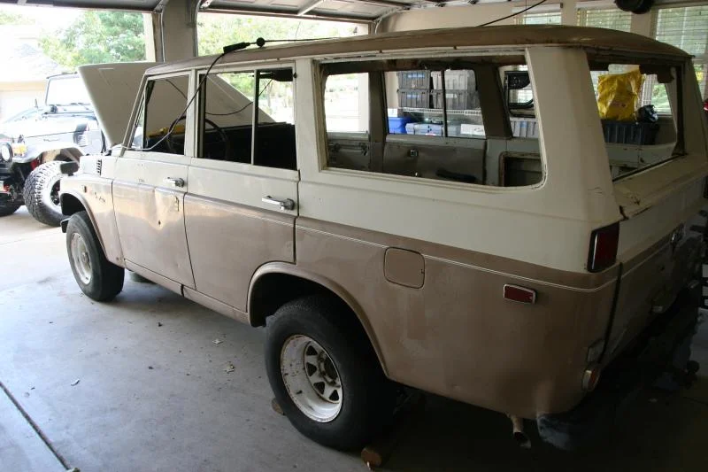

I got a two-for one deal and I couldn't pass it up. This was the first one that made the trip home.
It was knee deep in Texas sage brush so I didn't get to look too closely since I was buying this mainly for windows and other misc parts.
Come to find out when I got home, it has a '78 2F transplanted in it. I haven't studied these too much to know exactly what I'm looking at with regard to motors since my FJ40 had an SBC. Hmmm.... Wonder what other surprises I'll find? Many I'm sure.
For one, the PTO winch looks like a decoration (no driveline and I haven't crawled under to see if the transfer case parts are there).
Not too much rust rot although it's got the normal areas on fenders and rocker panels. Floor pans look solid. Can't wait to look further.

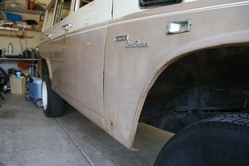

So this is the '70 that has a fairly good body. The only rust sport are the right front fender panels and those will be really easy to fix.
So my plan is to make this into a daily driver for when I move to Colorado. I'm convinced a new car isn't worth the money anymore so I've decided to go old school and have something that doesn't cost me $1000 for a mechanic to look at.

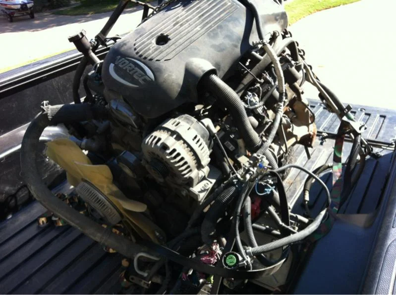

Look what I found for my pig. 5.3l vortec with 68k miles. Now I need to study electronics to see I can figure this out.
This should be fun. Just need to find a transmission and a t-case adapter.

I picked it up for $700 complete with all the accessories, ecm and wiring harness.
What year vortec? For tranny, I'd HIGHLY recommend getting the tranny that came off the back of the engine. Things work out MUCH easier;)
2004 - I'm planning to find a 4l60e that would go with it. This came out of a 2004 GMC pickup where the owner got a desire to swap in a 6.0L. so the transmission didn't stay attached.

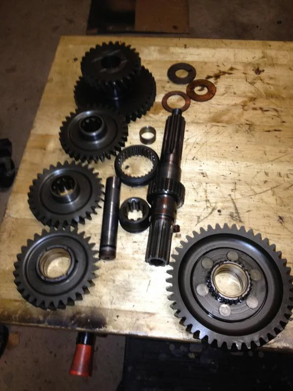

I also took advantage of the Advance Adapter Christmas sale and ordered a transfer rebuild kit and and 4l60e adapter. Today, I dissembled the transfer case so I could start to bolt pieces together for fitting of the engine. I'm hoping I can test fit with just the gearless t-case. I need to rebuild the 4l60e I picked up so while I have it apart, I'll be able to shorten the shaft to accommodate the AA spud shaft. So in the mean-time, I'm just test fitting then I'll remove to do all the rebuilds.

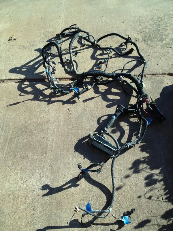

So a pulled my 5.3L out of the corner of the garage and started to strip off all the electrical wiring. The wiring is enough to scare you. I'm a computer guy and still this amount of electronics is a bit intimidating.

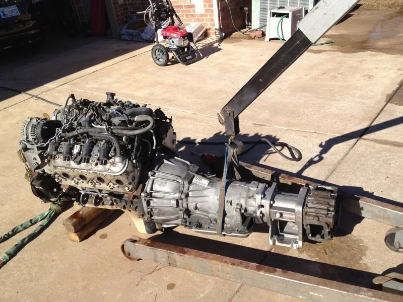

Once that was complete, I mounted up the transmission and the case from the transfer. I'm hoping I can get away with minimal components to do the test fitting.

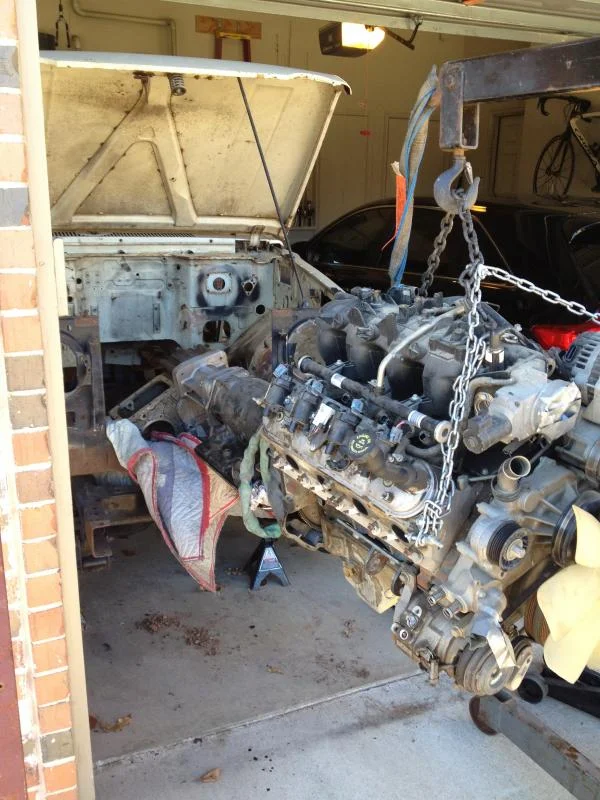

Then the fun began. I hate to bother people when I can do things myself so I stuffed the engine in without help. Just a little at a time and some creative positioning of the chains.
I go it stuffed in and hanging from a cradle I built to level and hold the engine. I had a family commitment so I was in a hurry and didn't get pictures. I'll post them up later.

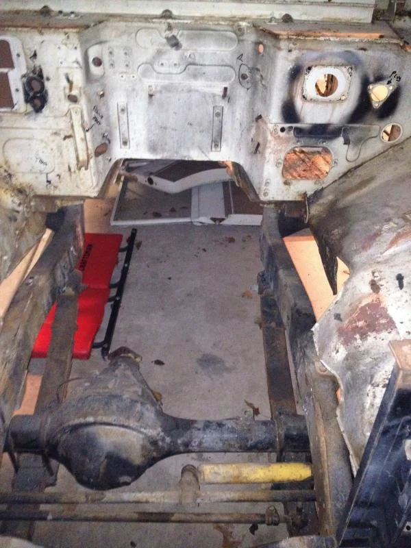

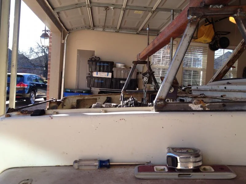

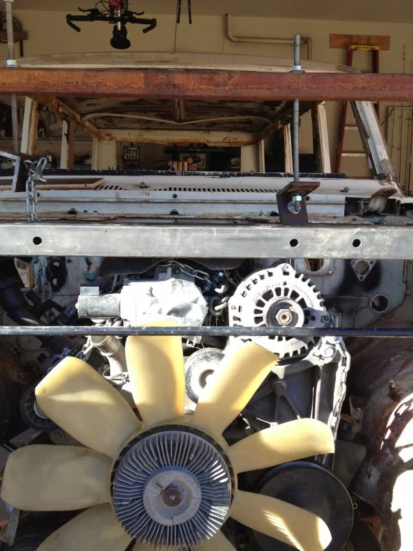

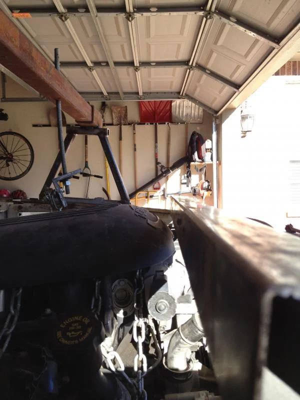

So another good chunk of time in the garage. I got the engine where I want it and I think I've got enough room for it all to fit. I took lessons from Lil'John's build and I think I'm low enough to get the Vortec cover installed and not have hood clearance issues. If you disagree let me know since I haven't welded motor mounts yet.
The pictures shows a 2x2 piece of square tubing and it sits just below it. Based on rough measures of the hood I should have and inch or so to spare in the end or maybe a smudge more.

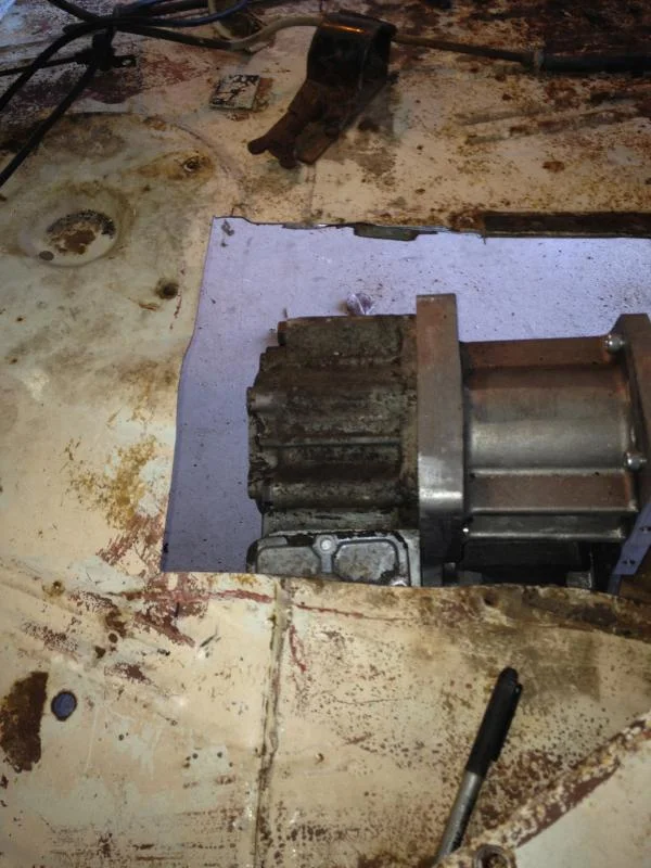

I also decided to cut out the rear hump cover and extend it a couple inches. I did this to gain an inch or two more clearance for the transfer case as it hung below the frame 2-3 inches. Now I've got it just less than two inches and should still have clearance for vacuum shift hoses and linkages. (cross fingers)

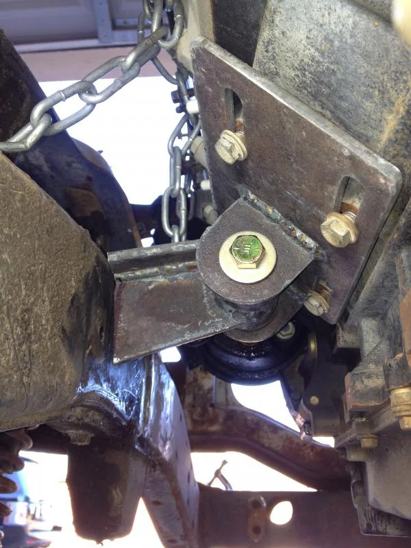

I cut my motor mounts to fit for the final welding so you can get an idea of how they look. I'll probably machine them down 1/4 inch and weld them to a 1/4 flat plate and weld the flat plate to the frame.
If you have any doubts about needing to do a spring over you'll see in the picture there is no question. Does anyone know if the diff flange from fj60 axles will sit any further to the outside than stock? I haven't done any measuring on the 60 axles and hope it sits an inch or so further to the right so in a sever flex I won't have to worry.
