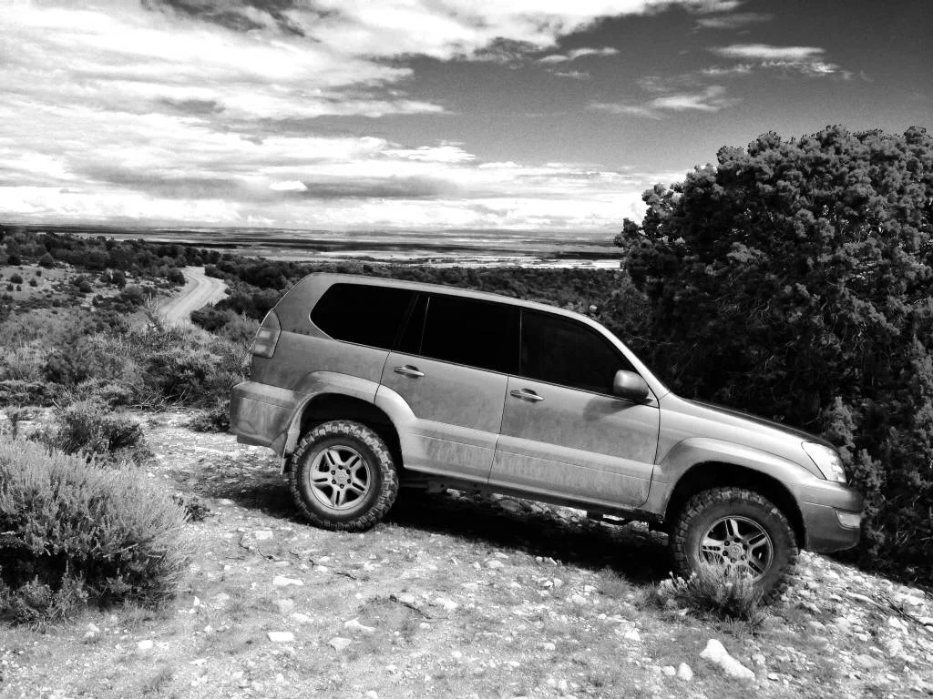

255/80/17 km2 mt's siped on my gx do really well everywhere
^those pizza cutters look at home on the gx!
