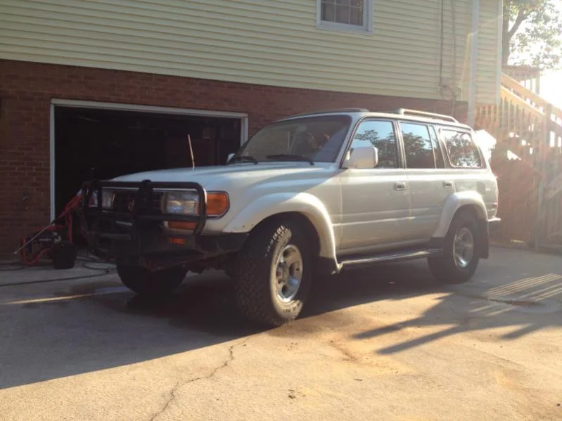

I washed my rig today. Then took an abrasive to it to get the sap/s*** off of it. After that I waxed it and got it all shiny. Now I have a clean interior and exterior. Although in three weeks I'm going to the hunting club and it will all be for naught.
bumpers looking noice!
I shoulda come and used your pressure washer! I still need to actually! lulz. Where is there a cheap car wash?!
In my driveway is a cheap carwash. I'll be glad to let you use it.
