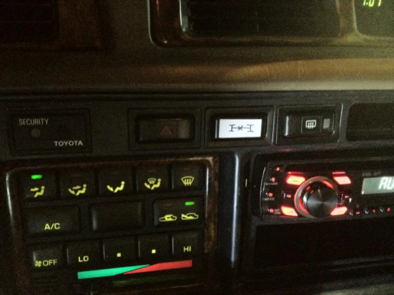

I got an old flasher switch and attached it as a CDL switch. For now it has a piece of white tape on it with a drawing. I moved the antenna down low and the rear defrost over one. It works though.
Fancy.
It is fancy. It took me at least ten minutes to locate tape, doodle the picture, and cut it to size. I'll offer my artistic services to anyone for a small fee.
And thanks to chroad for the switch.
Wow. If I had known that hazard could look so good with some tape and a pen, I'd have kept it instead of getting the real CDL!
I guess you had no problem getting the A/C bezel off and locating the plug. That's got to be the easiest and most rewarding mod there is...

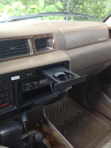

Bam. New cup holder.

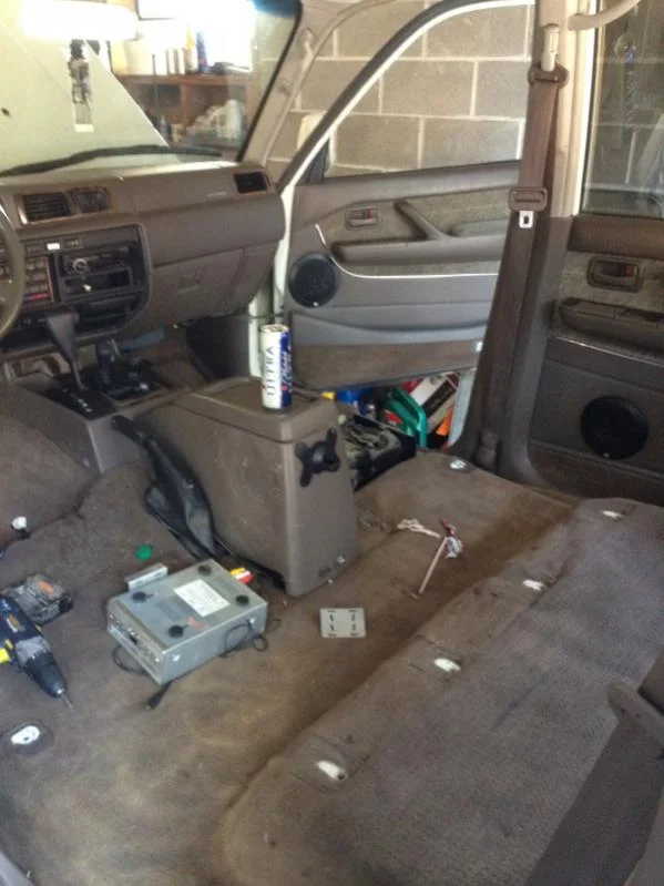

Decided tonight to take all of the seats out and the carpet from the rear cargo area forward out of the cruiser and wash it. I don't want my 80 smelling like Clank's. Just saying.
Which one?.. The hundred smells good.!
And as long as I can keep people from losing their dinner in it I'll be good.
Wait is that a mickey ultra!? That fully explains your reaction to real beer.
We will have to work on that before you now it we will have you drinking beer like man.
By the way that's the way real 80s smell. I mean ones that get used for more than driving 2 miles to work and back.
