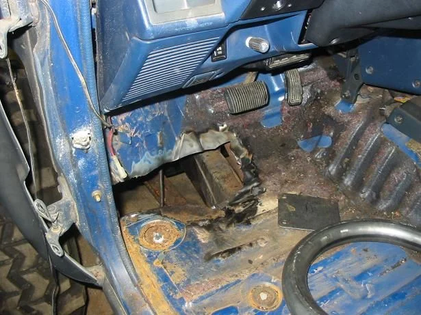

The first thing on the list was patching the floor board, so we cleaned up the area in question.
attachment.php

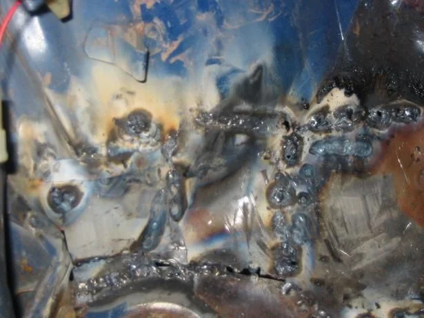

And then proceeded to make a mess of it again.
attachment.php
I am utterly disgusted with how this turned out, and will be redoing it, but didn't want to waste anymore time since I don't have the right materials to fix it right now, so I moved on.

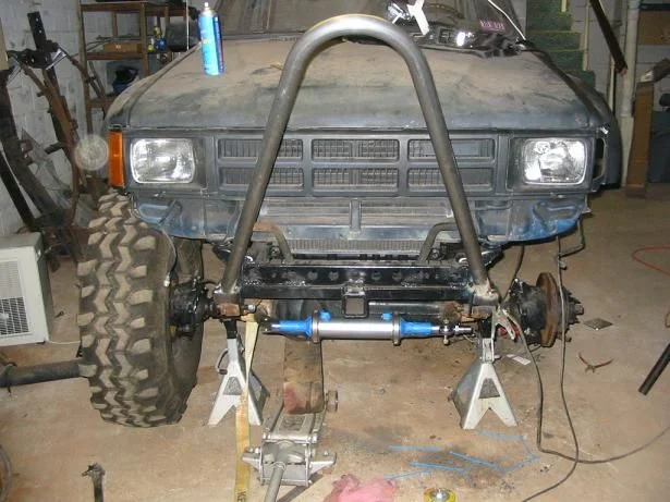

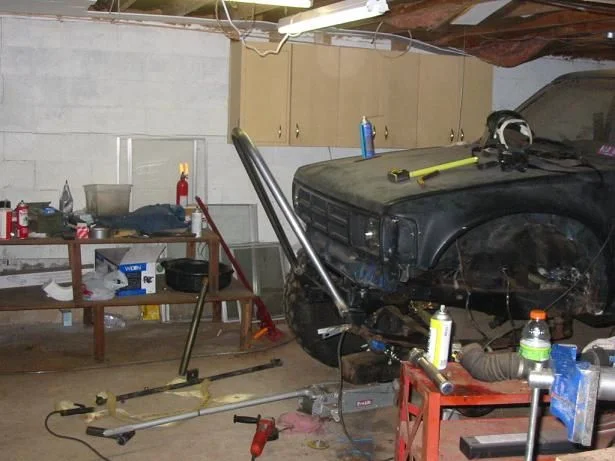

After screwing up the floor board patch, I was pretty frustrated. So, what do you do when you're frustrated, you have tube and a tubing bender? You make an obnoxious stinger! :D
attachment.php
attachment.php
I had these two pieces of tubing already bent and just set them up there to see what they looked like, and I really like it. I'm gonna wait to see how the rest of the bumper turns out before I put them in, but they may end up staying.

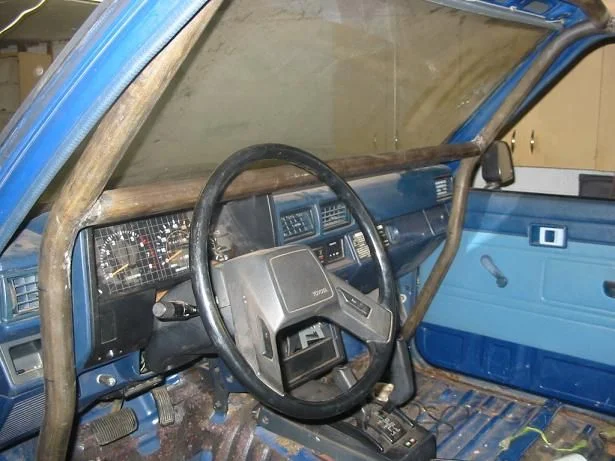

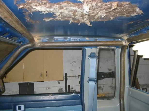

The next morning I set to work mocking up the cage to make sure everything fit properly. I quickly got very frustrated with the lighting situation, and decided it was time to install the new dome light I had picked up. I have no problems seeing anything in the cab now. :flipoff2:
attachment.php

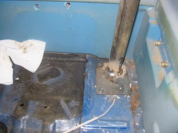

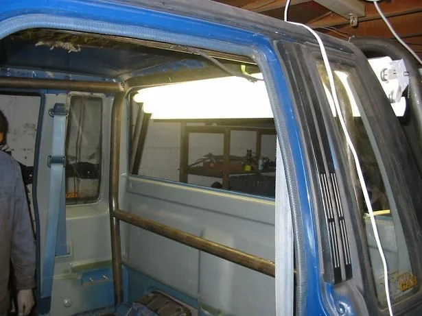

After about 2 hours of tweaking and adjusting the notches on the tubing, it was ready to go in. At first I was going to try and tack certain parts together so they could be lowered and fully welded in a better position, but after having the whole thing fall apart like Jenga puzzle on my head 3 times, I gave up on that notion. I tacked it all together, positioned the floor plates, drilled and bolted them in, and then started welding. These are pics of the end result. BTW, many of the joints are not finish welded yet, hoping to borrow a mig for this too.
attachment.php
attachment.php
attachment.php

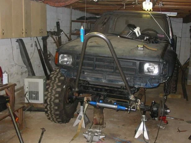

Haven't been up to work on it in over a month, but I do have some pics that I haven't posted yet of the steering.
First I mocked everything up w/ the heims/tres w/ tube inserts and took some measurements.
See Pic 1
Then I cut and prepped the "tie rods" 1.5" .250 DOM
See Pic 2
Then I welded them all together and installed them.
See Pic 3
