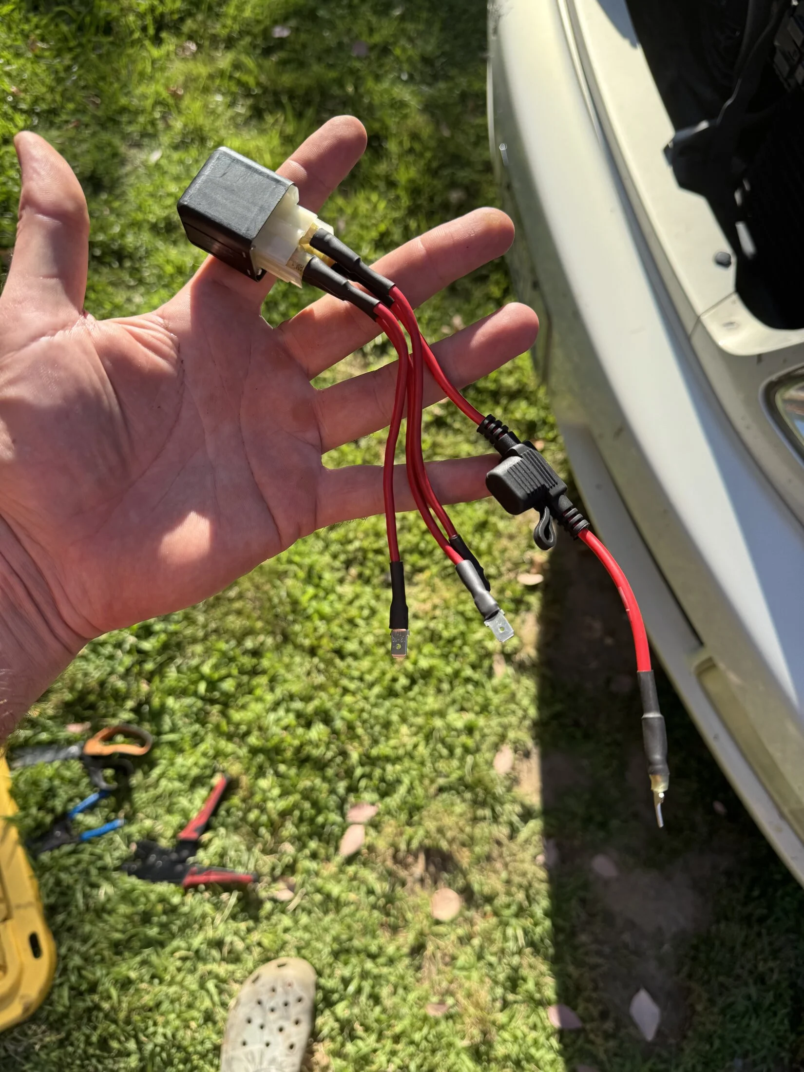

Told the mechanic to hold fire....made up the test lead and as I was over that side of the country for a MTB ride I decided to pop to my sisters and test it.
I was VERY happy to have the thing fire up after 3 months and lots of wasted trips (and money on spare parts I didn't need).

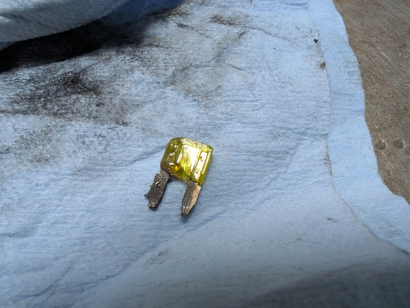

That efi fuse was very expensive! @medtro I'm going to message you about cost. Thanks

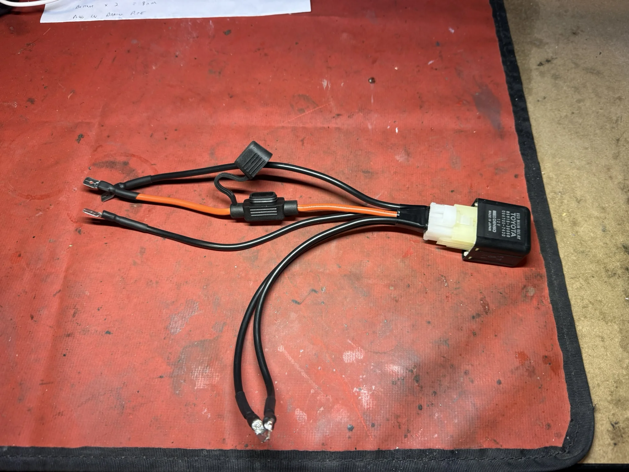

Well, not what I wanted to find when installing @medtro's kit. His kit got the truck going again, I might just wire the power straight to the battery as suggested, but also think I might pull the painful trigger on the whole fuse box.
Props to medtro, kit is super well made, easy to put in, and something I'll def. either put back in or keep in the truck so me/kids never get stranded with this. Amazing thing I was thinking about was just his original thread on this and chasing down the voltage issue. I was wondering if I was just average Joe and dropped off my truck at the dealership with this issue, how long and how many labor hours would I be paying for for them to figure this out? Huge $$ saver with the knowledge here yet again.

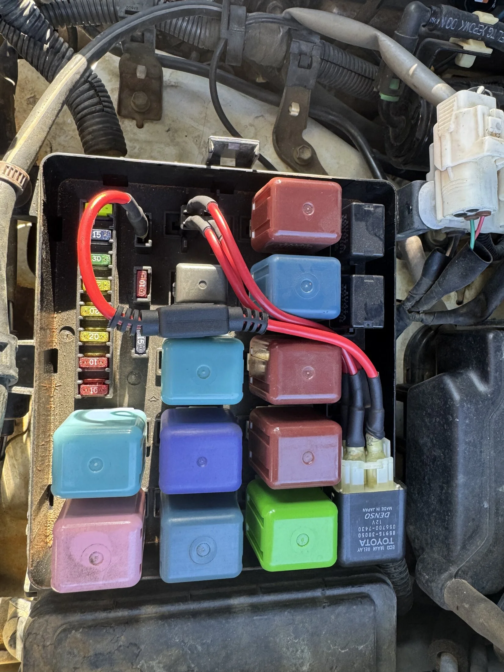

To get truck cranked in emergency like you're in now, you can run a fused wire from Postive + battery to the F slot in this photo. Then pull the wire after shutting off engine so it will not run battery down.

I made my own for now, but I’m having issues with the spade connectors staying seated in the relay sockets. Are there longer/thicker spade connectors out there that will fit?
I would pick the relay receptacles with a picker to make them tighter, or/and bend the spade connectors slightly.
