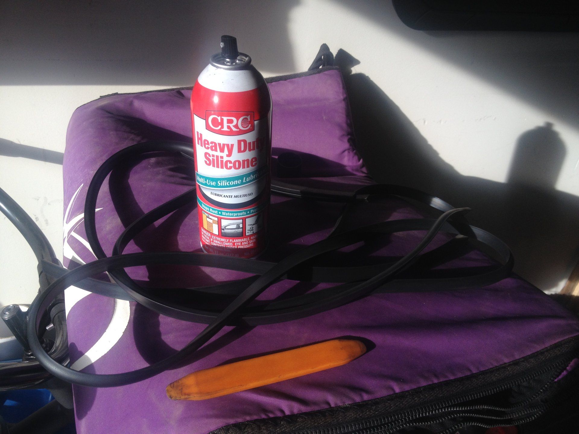

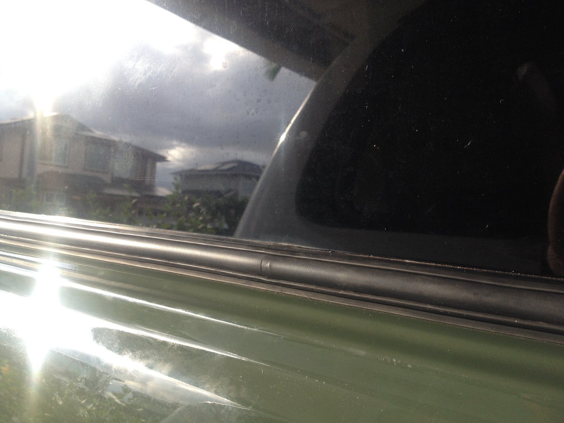

Couldn't find anything new for the rear so I've re-use the original one for now with a chrome infill. I'm on the lookout for a plain black infill strip.
There is a couple vendors on here that sell that black rubber infill strips for all the windows. I got mine from the Mud vendor @reevesci. PM him to see if he still stocks it. Here’s what I got from him that I used on my 60.
