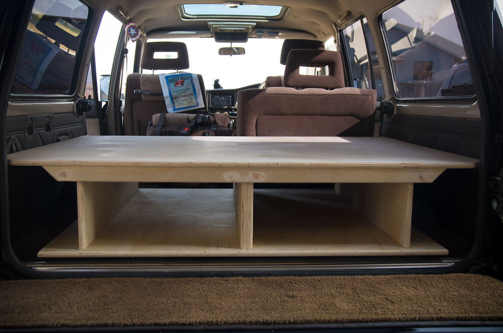

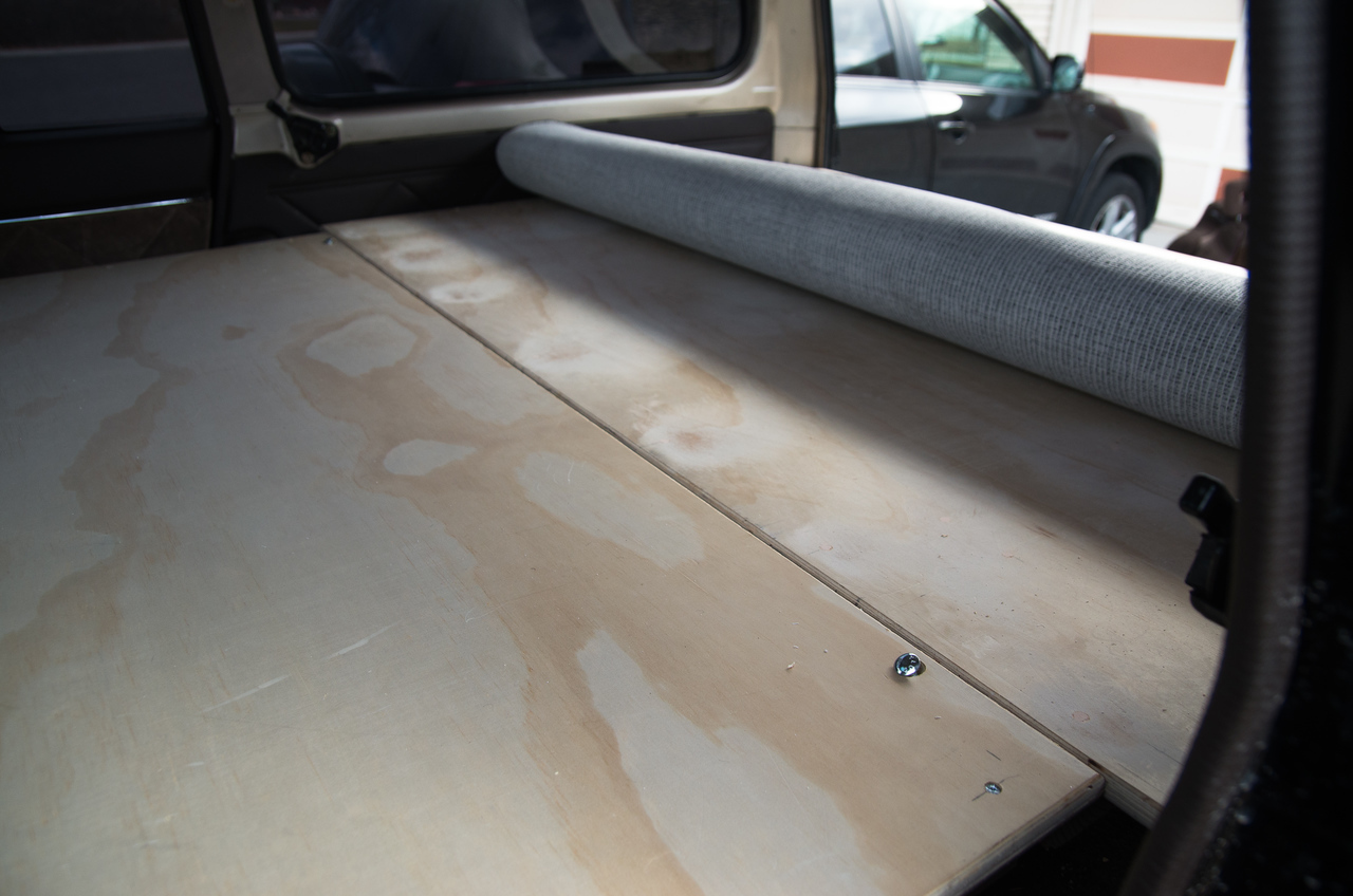

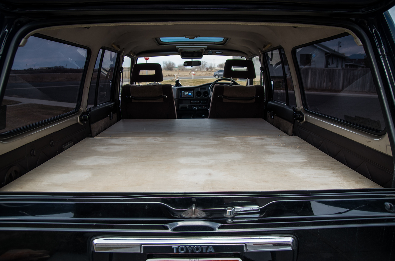

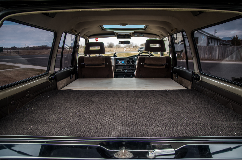

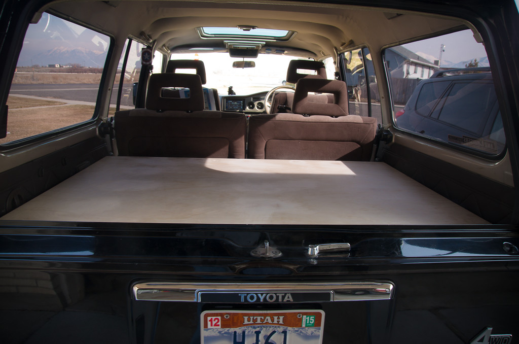

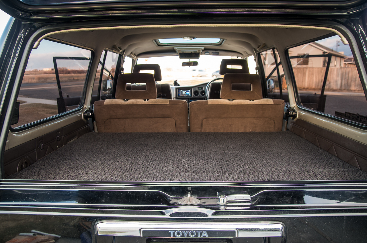

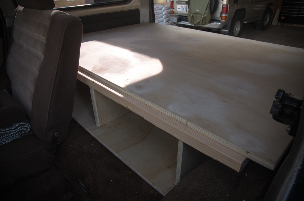

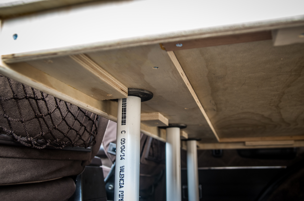

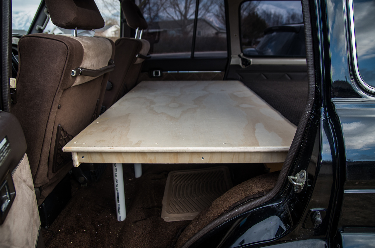

Stage one of the sleep platform build. I found that it helps to have a retired father that is bored at home. All I did was give him my ideas, some sheets of plywood and off he went!! For the next stage I will build the second half of the sleep platform where the back seats are now. Stage three is drawers.
Looks great, I'm jealous!
How do you have the forward portion of your platform stowed, when the back seat is in normal position?
That would be in the garage! Lol :D
Really though, the second section will only be used while on a camping trip so I will keep it stowed away until we need it. When we want to go camping the rear seats will come out (4 bolts each seat) and the second section will be installed.:clap:
Haha, that's cool. I usually have my sons with me, so I need the back seat functional. If I didn't, I would definitely go your route.
Gotcha, in my case it's just me and the wife so it's easy to set up the second section before we hit the trails. If we had a passenger or two I would definitely have to figure something out to store it until we set up camp. It would be interesting to see what others have come up with for that situation.

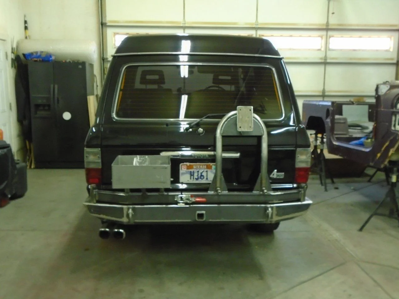

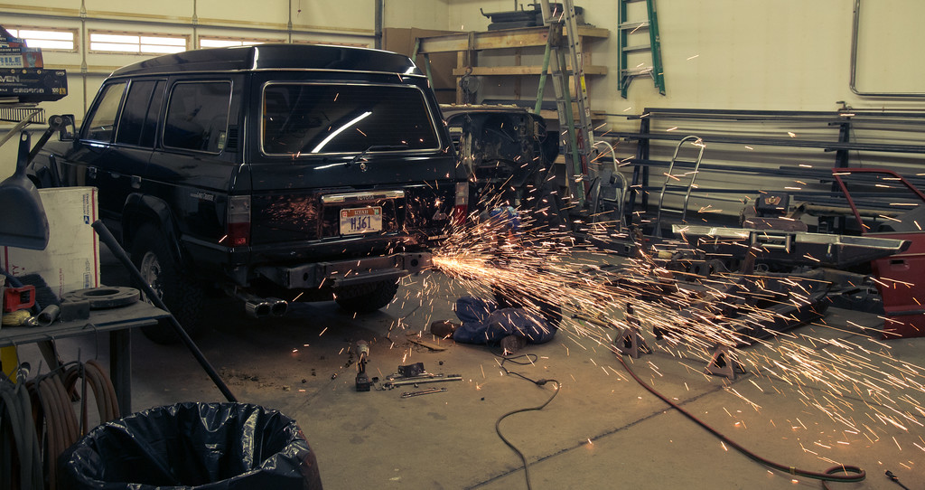

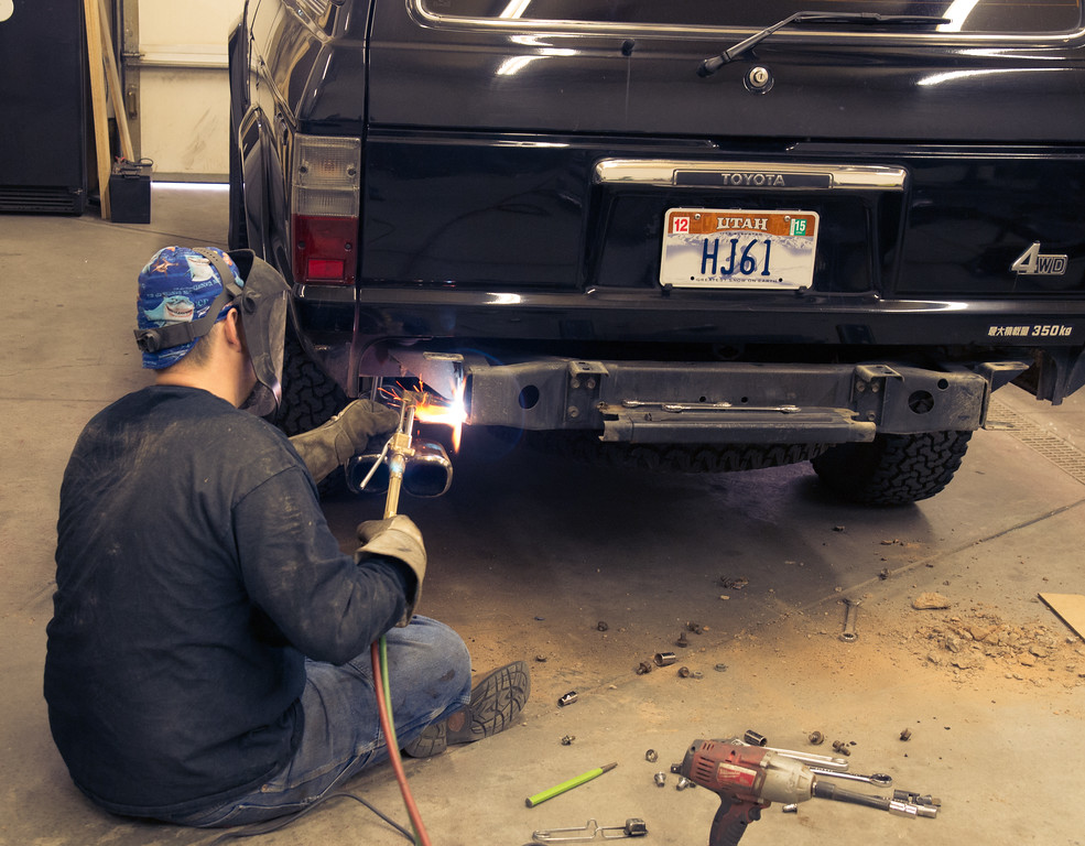

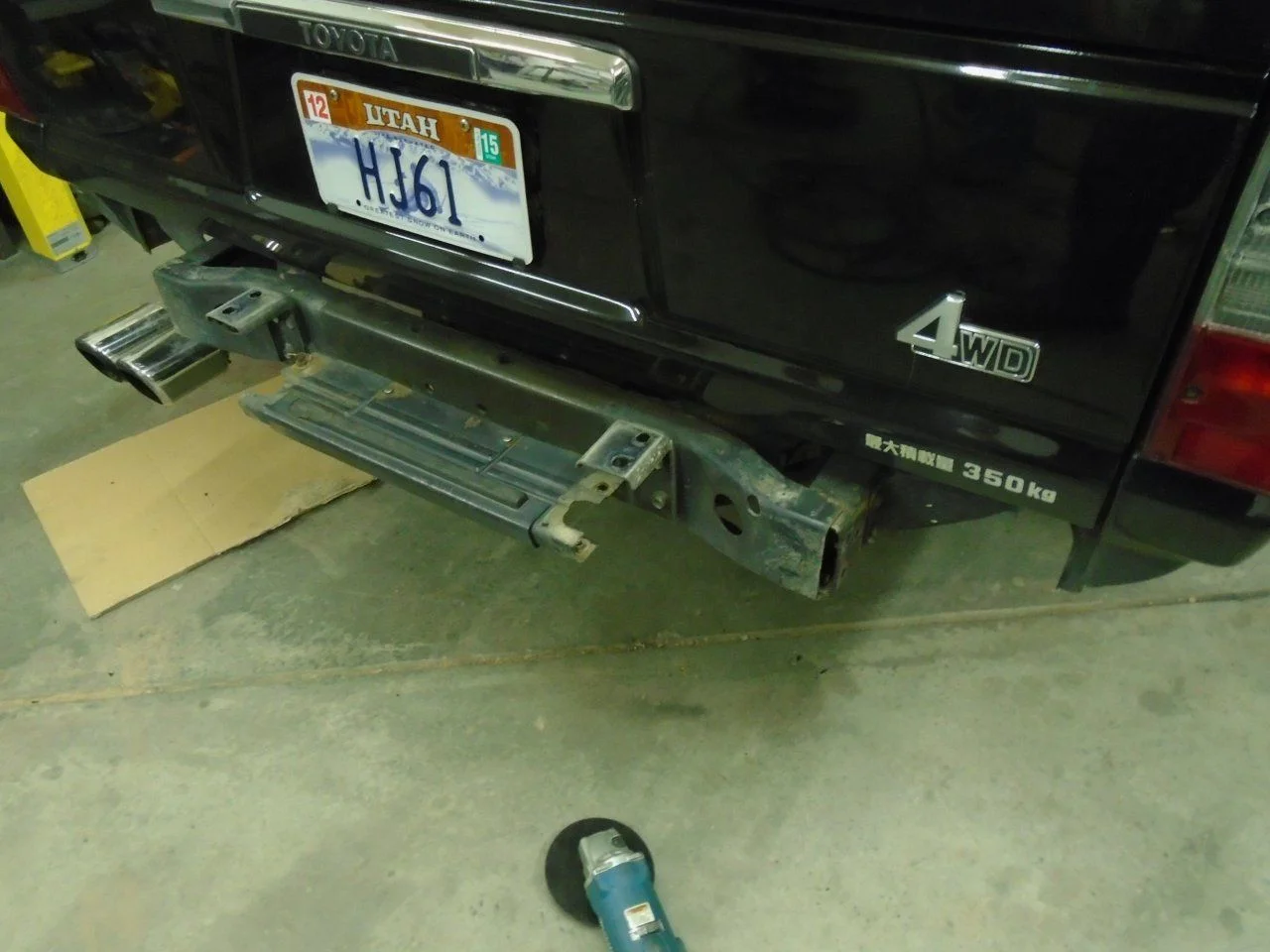

Yesterday I ventured into the vast land know as Wyoming to meet up with reevesci and pick up my new rear bumper! It was great to get to meet Jason and have him help (by help I mean he did all the work and I provided support) with the removal of my old step bumper so I can install a new double swing out rear that he made. I can't wait to get this bad boy powder coated and installed on Stoffel!! Here are a few pics (some that I stole from Jason):

Thanks again Jason! I'll see you in a couple of weeks to pick up the sliders and drop off the wife's BJ71!

Will you move the exhaust out of harm's way, looks like they will drag easily.

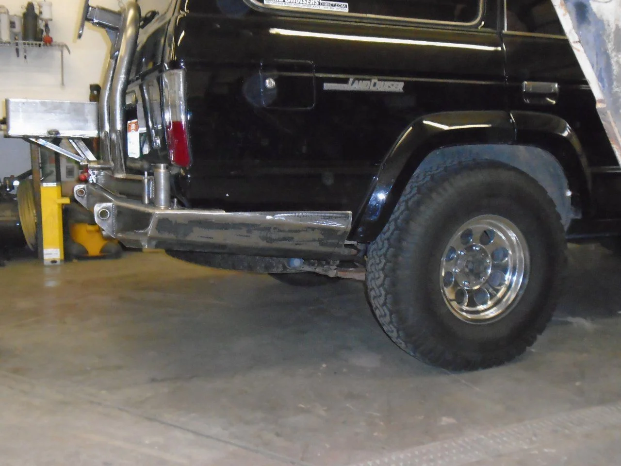

Can you show of the mount of the quarter protection to the frame?
Are those tires 33x10,5?
I plan on replacing the exhaust soon(ish) with 3 inch from the down pipe to the rear. Final placement will be determined then but I agree, what is there now is wayyyyy too low!
There is no mounting of the quarter protection to the frame. Jason has welded a backer plate on the inside of the bumper to stiffen up that area. If there ever is an issue with flex he has offered to weld it to the frame to make it stiffer.
Yes, the tires are the 33x10.50 BFG AT's. When I received the rig it had 33x12.50 tires, but I like the narrower tires so I swapped them.
