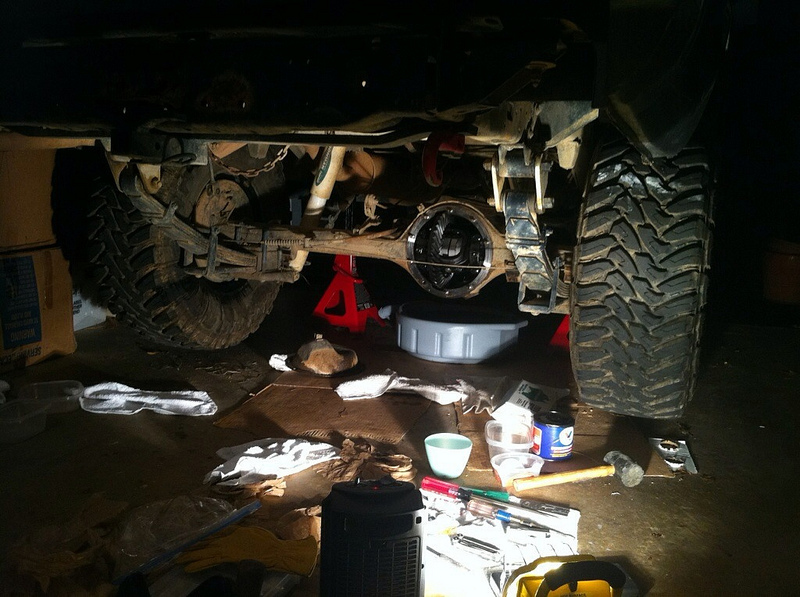

Got around to putting the Aussie in the rear diff yesterday. Started around 3pm, ended around 7:40. Definitely wouldn't have taken so long if it was a nice warm summer's day, but it most definitely was not.
I had a lot of fun doing it since it was my first time opening up the diff and seeing how everything works, but i did feel bad about disrupting the elegant dance the gears have been continuously doing for the last 23-ish years without incident.

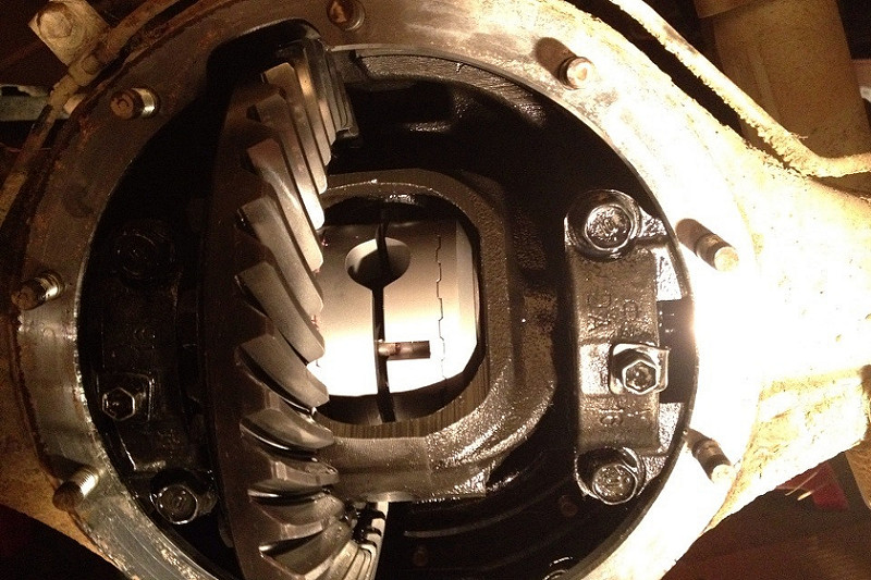

what you're supposed to see upon removing the diff cover...

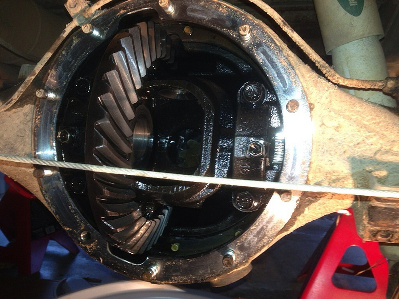

After doing some tolerance tests, INSTALL THAT B!TCH...
Finish Inside.......;)

VERY IMPORTANT INFORMATION: (DONT VOID YOUR WARRENTY!!!!!!)
-Make sure the distances between locker spacers and pinion shaft on each side are between .006" - .020"
Mine were .006" and .007" (Cuz i like to live on the raggedy edge haha)
-Make sure the distance between cam gears is between .145" - .170"
Mine was .151" (YAY!)
If there are any questions, I am now a battle-hardened locker installer and will do my best to answer them :cheers:
So what did you use to check the tolerances, feeler gauge, caliper, just eyeballed it? Looks good - did you have to remove the c-clips to remove the spider gears?
While i would like to say i just eyeballed it, I am only human and was about .002" off in my visual estimate (probably cuz i wasn't wearing my my glasses), so i used my handy dandy feeler gauge to double check.
To remove the the spider gears, you slide the pinion shaft out (by taking out the pinion retaining bolt) and then just spin the wheels slowly. They just revolve right out into your hand. Removing the C-clips comes a little later.
