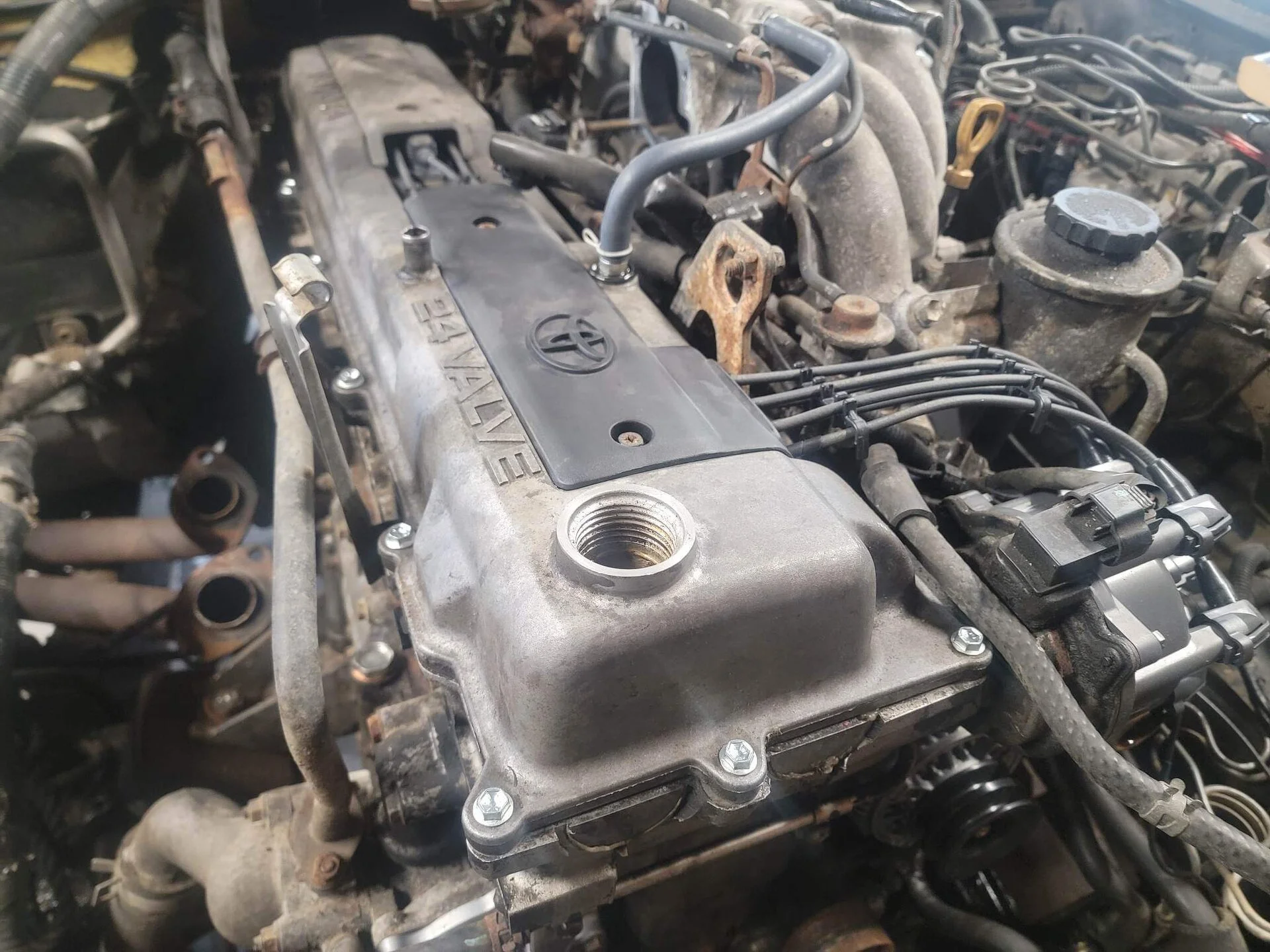

Looking more like a motor every time! Not pictured, but i replaced more vaccuum hoses and put the throttle body on.

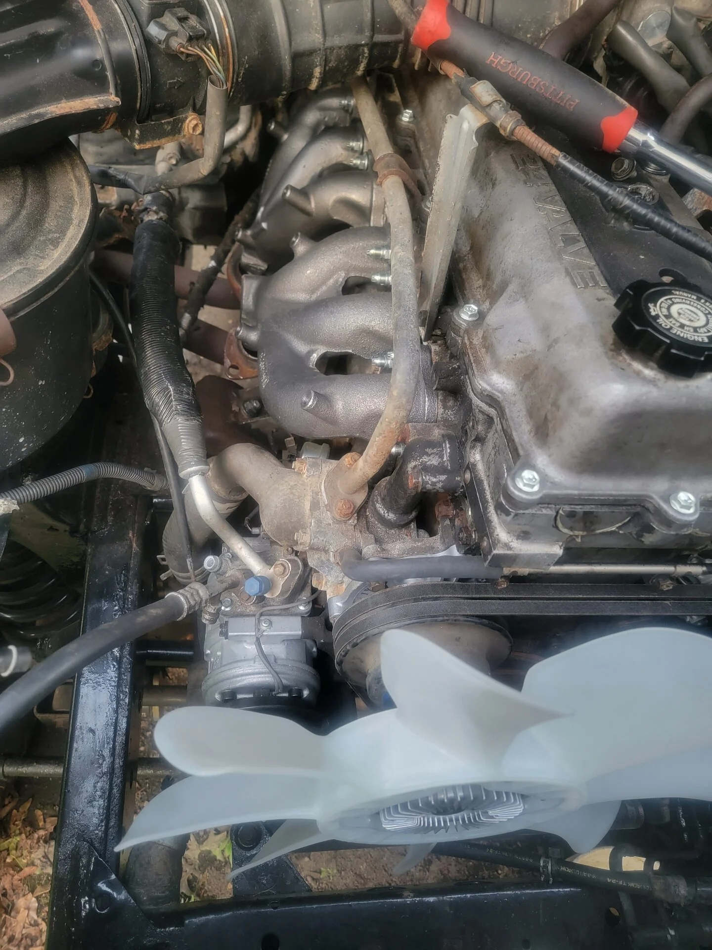

More progress- I got the blue hub fan clutch and a/c compressor on. Still need things, which I have an order from Partsoq coming in. Getting closer to being able to fire it up.

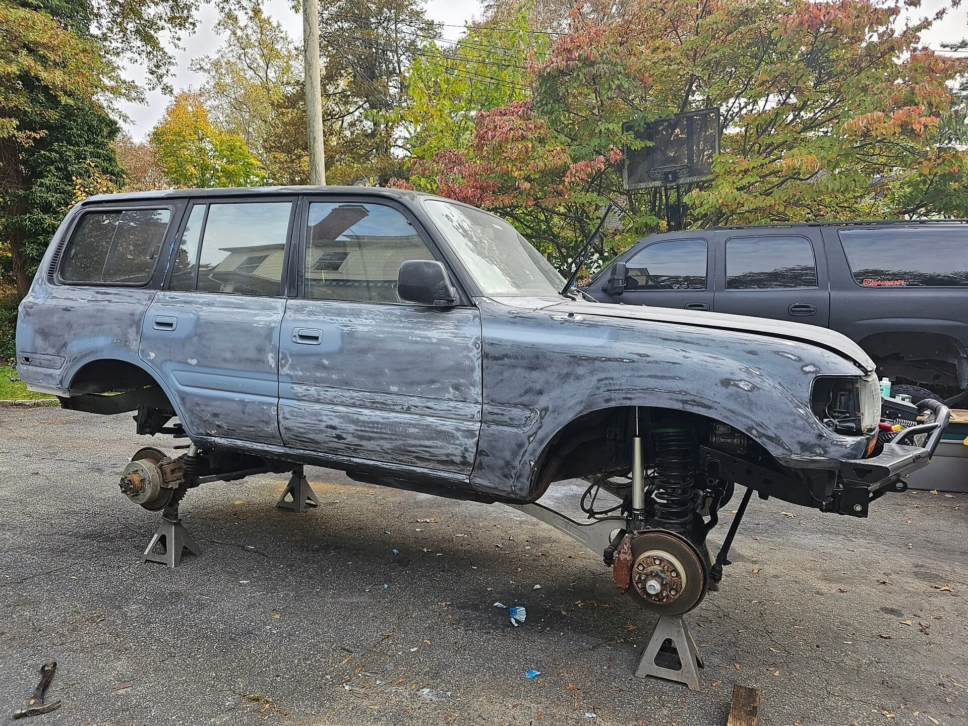

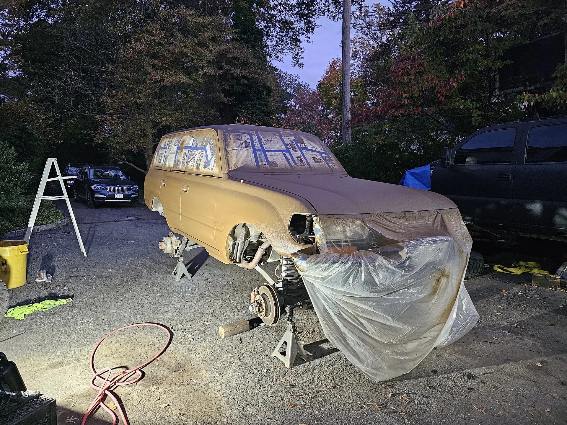

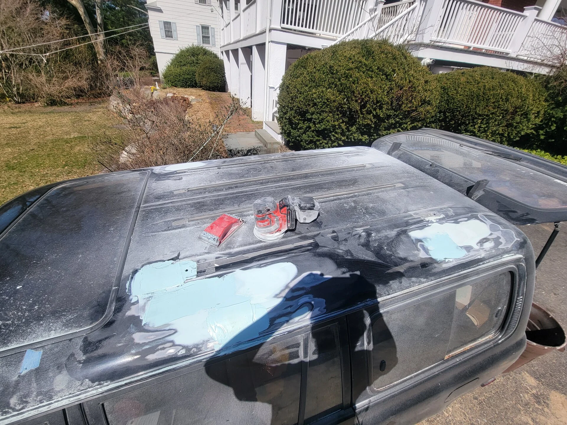

I also started the body work on the roof. What a pain it is trying to re-shape the end of the raised section. It won' be perfect as this is this is a wheeler and will get scratched and dented, but its going to look better than it did.
On the roof rack holes, I used steel stik to start. On the rails in the middle (or where they once were), i am going to be using fiberglass reinforced putty.

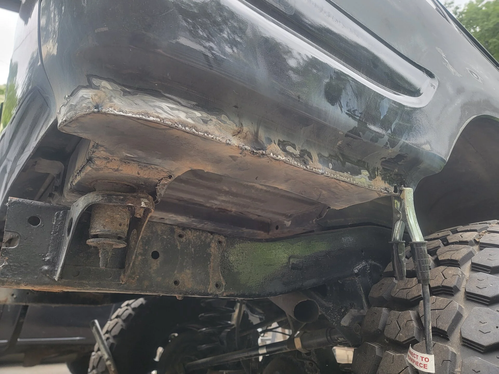

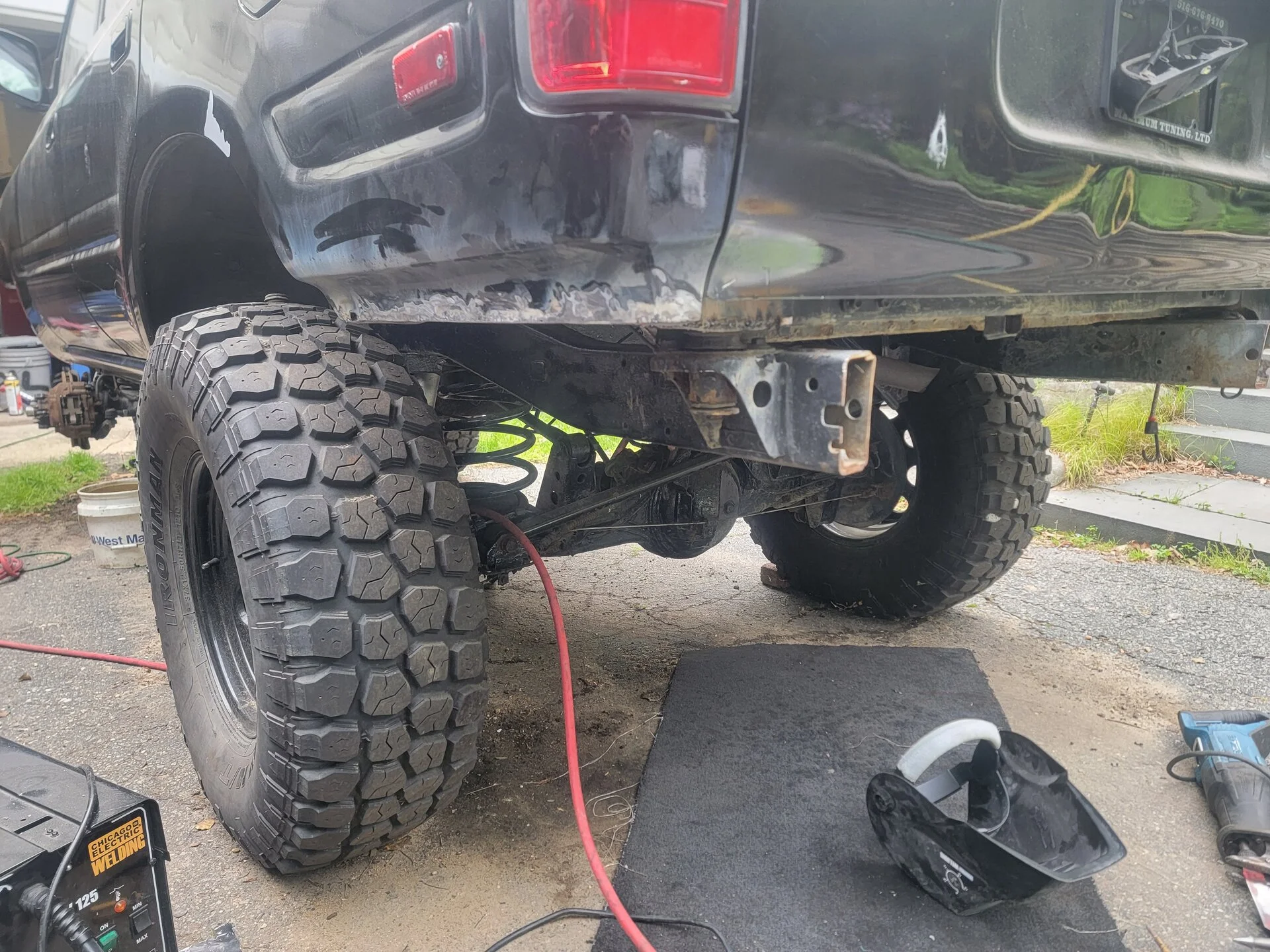

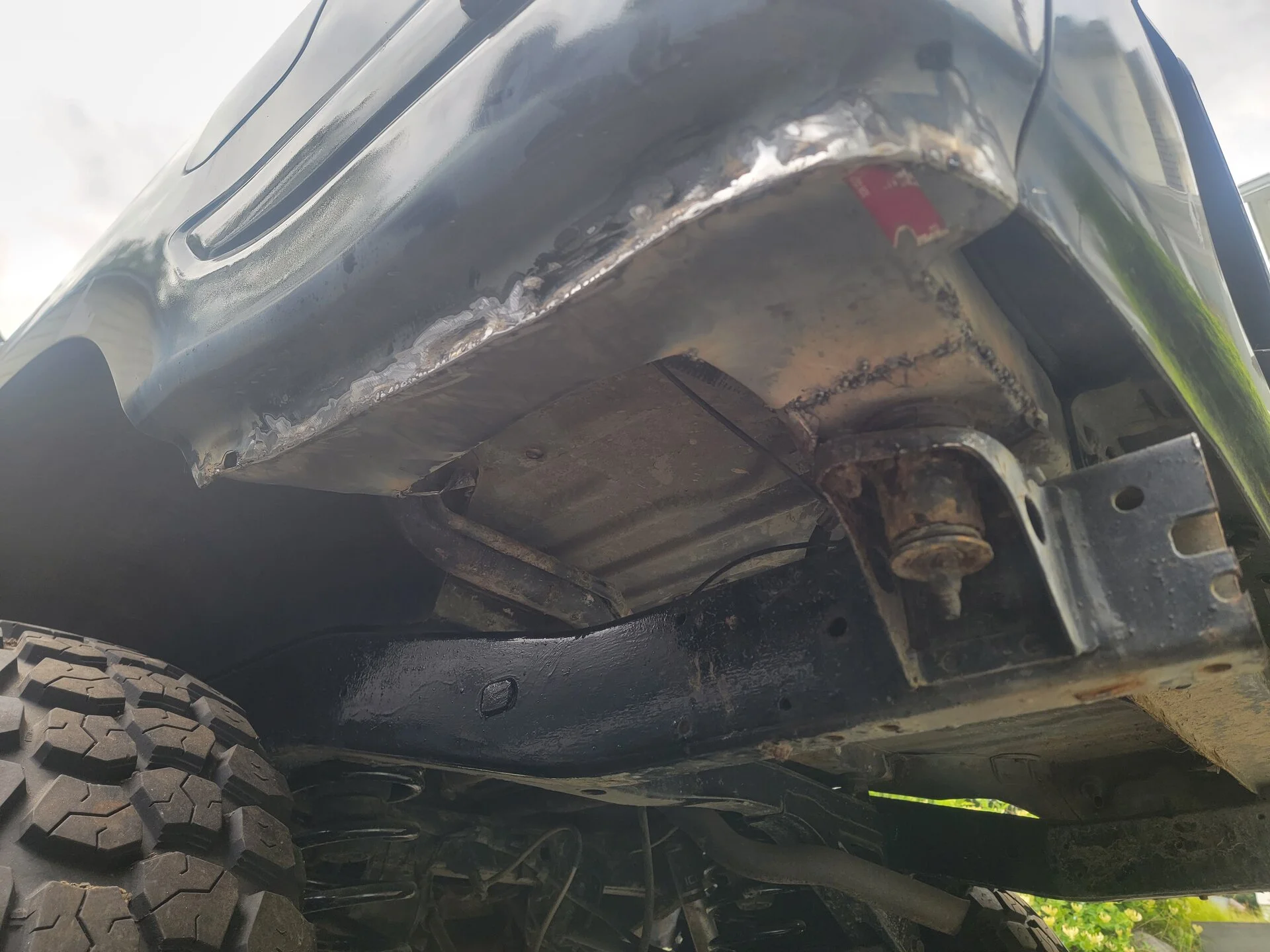

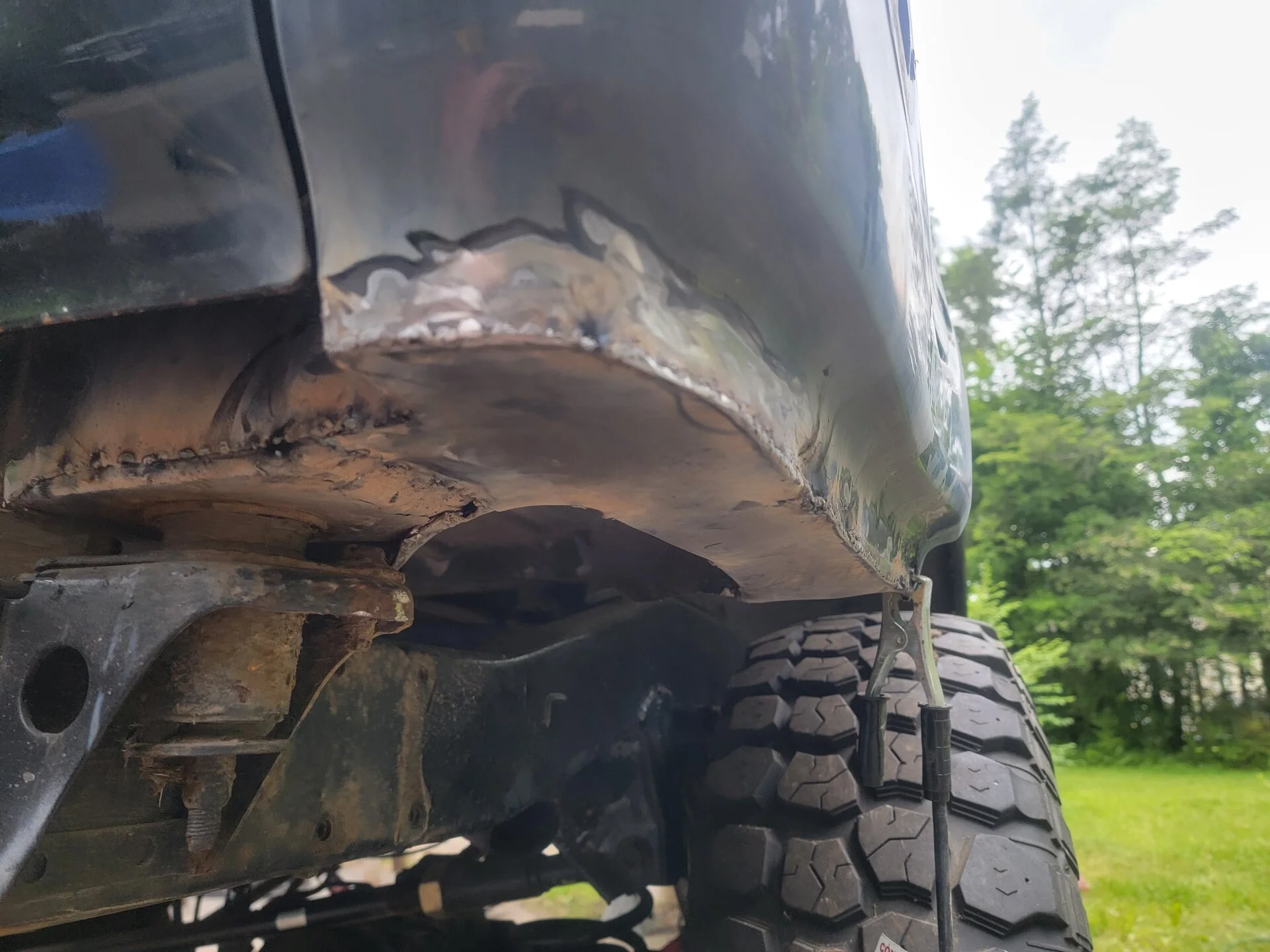

Starting to get rid of the rot. Drivers side quarter panel chop is done. Still gotta grind down more welds and apply bondo. Little harbor freight flux core welder put in some work today. It's not perfect, this is a trail rig-but it'll keep water out at least. Also need to cut a new hole for the sunroof drain.

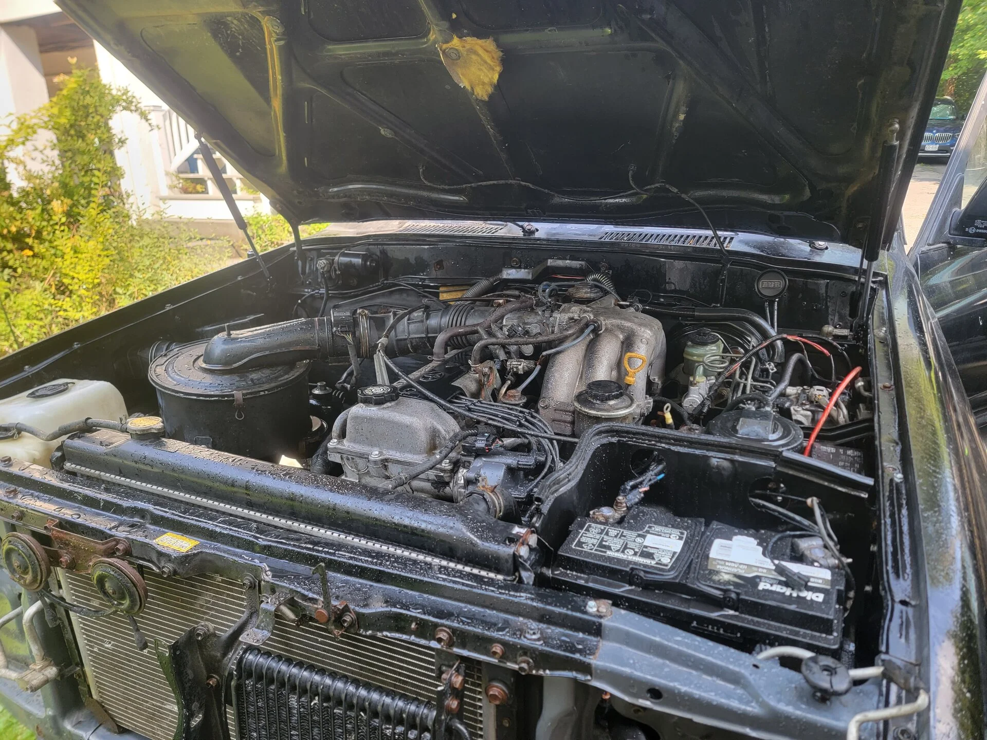

It's been over a year, but she finally fired up yesterday with the "new" motor. Only ran it for a few times for 5-10 min each to check different things. Gonna do an oil change, and make sure the remainder of the wiring harness is plugged in. She ran rough, but with a few different things not 100% i kind of expected that.

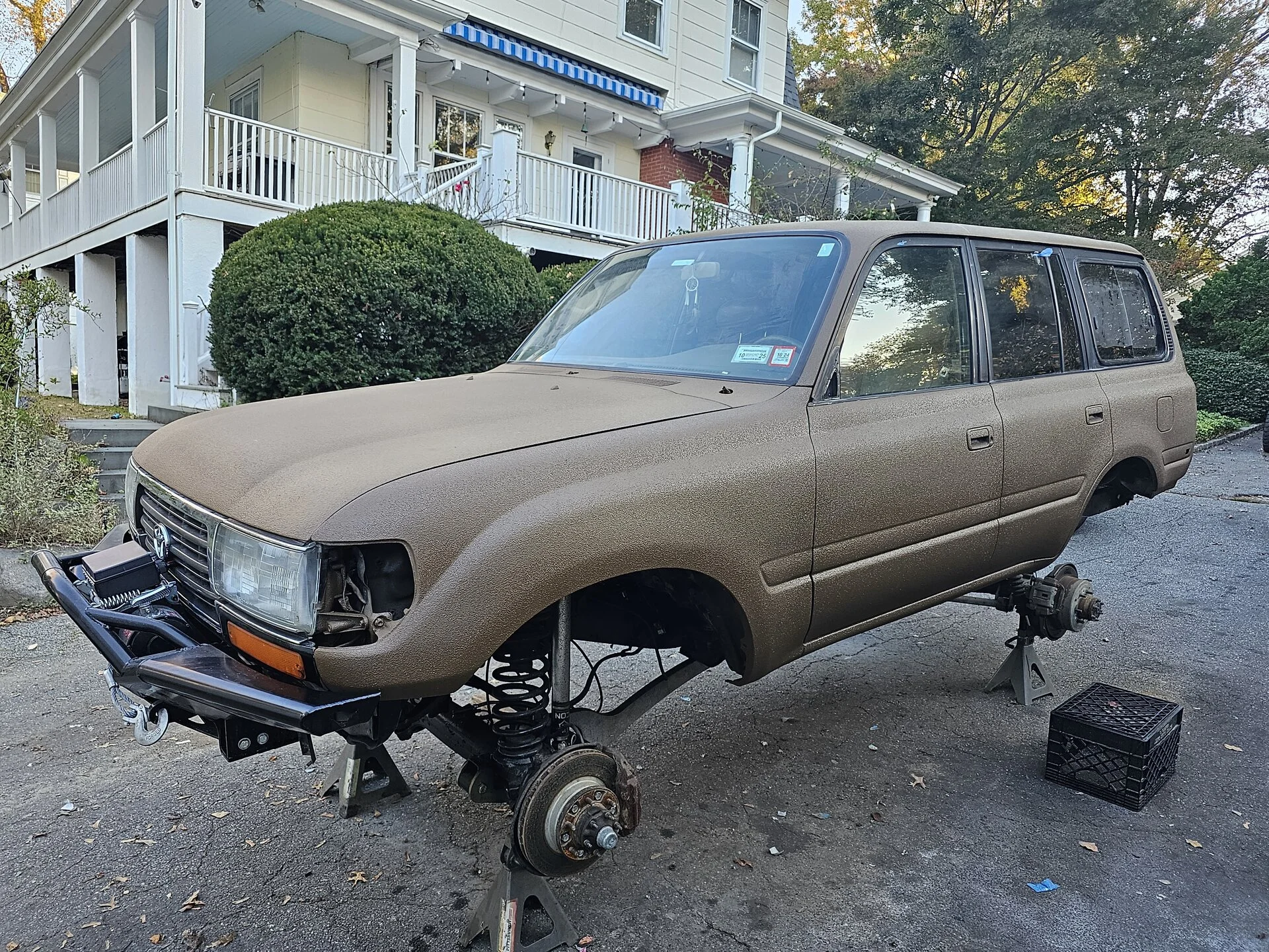

Got the front end put back together.

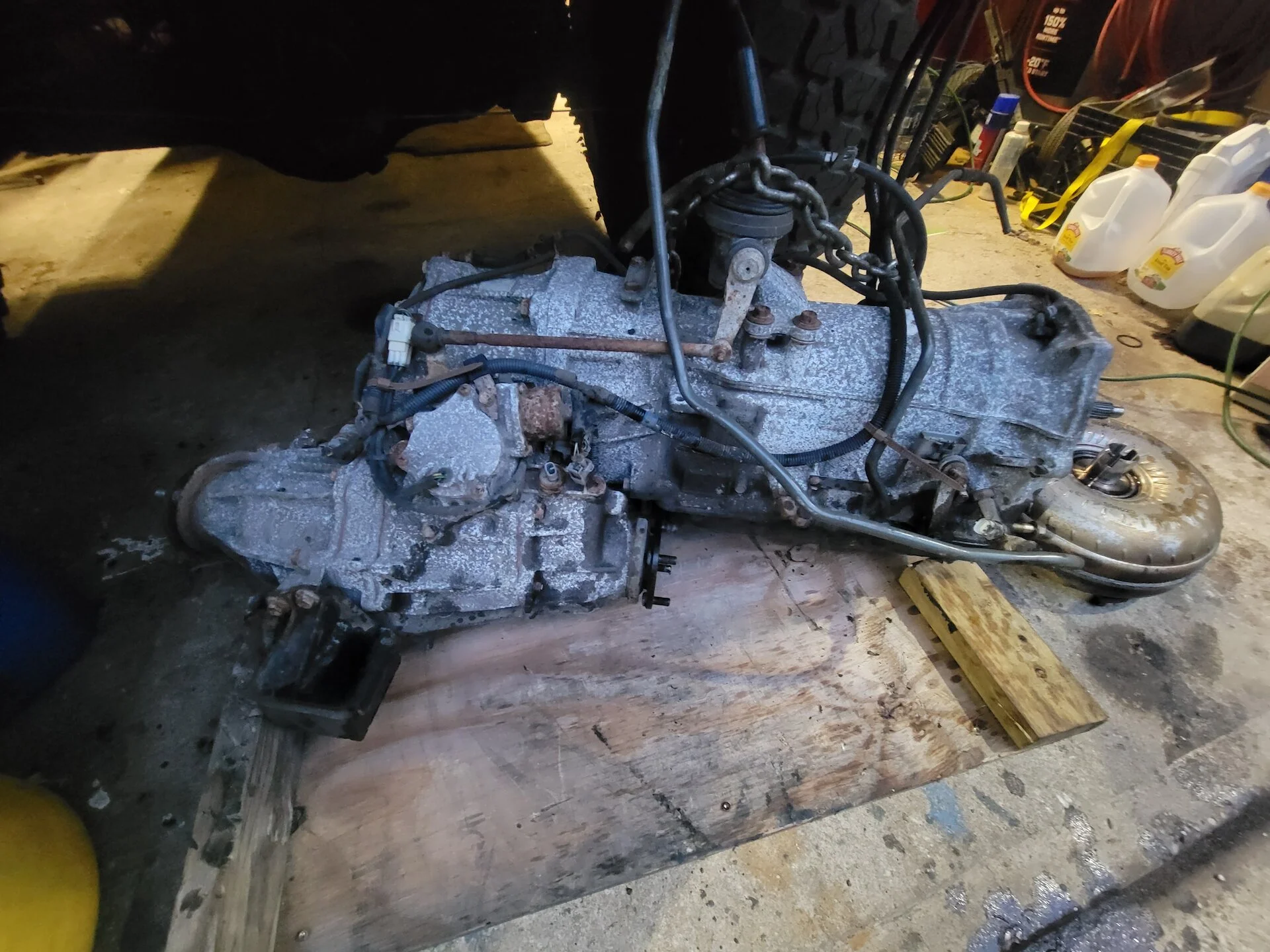

Transmission now did barely move in drive. Reverse and low gear was fine. Got codes P0753 and P0758 which are shift solenoid a & b. The person I got the transmission from originally, gave me another transmission free of charge. Happened to also have a t case still bolted on too, so i guess I have a spare now (which i may end up refreshing and putting in Marlin Crawler low range gears)
Plan is to change out the valve body and see if that solves the problem....

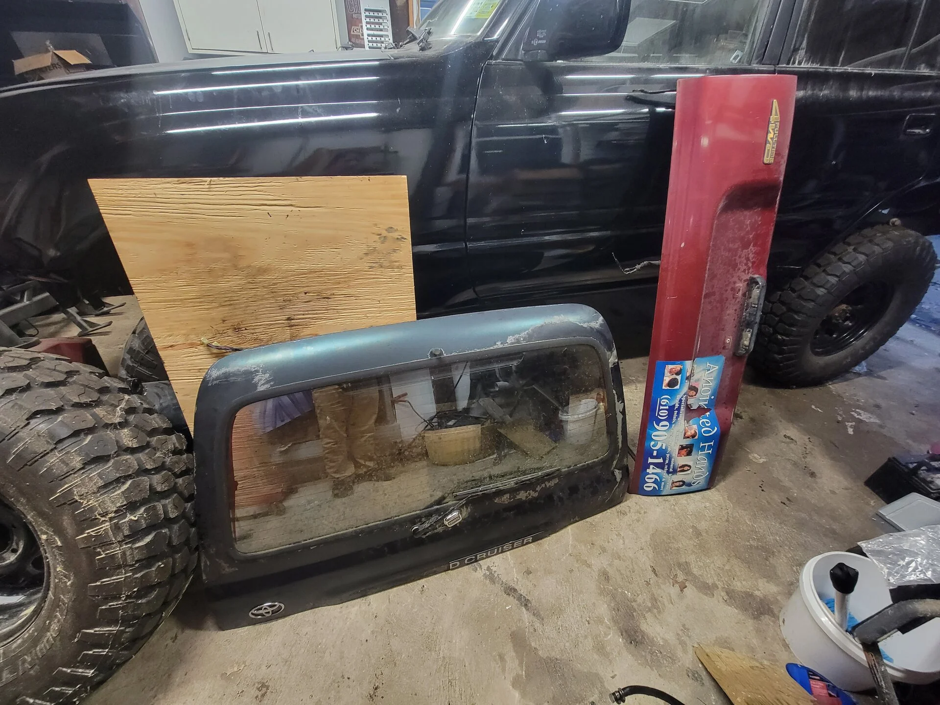

Also picked up upper/lower tailgates in better shape.
I swapped out the solenoids from the transmission pictured above, and put them into the one that's in the rig. The codes went away, but still having problems in drive. I am wondering if it is worth it to now swap transmissions again....

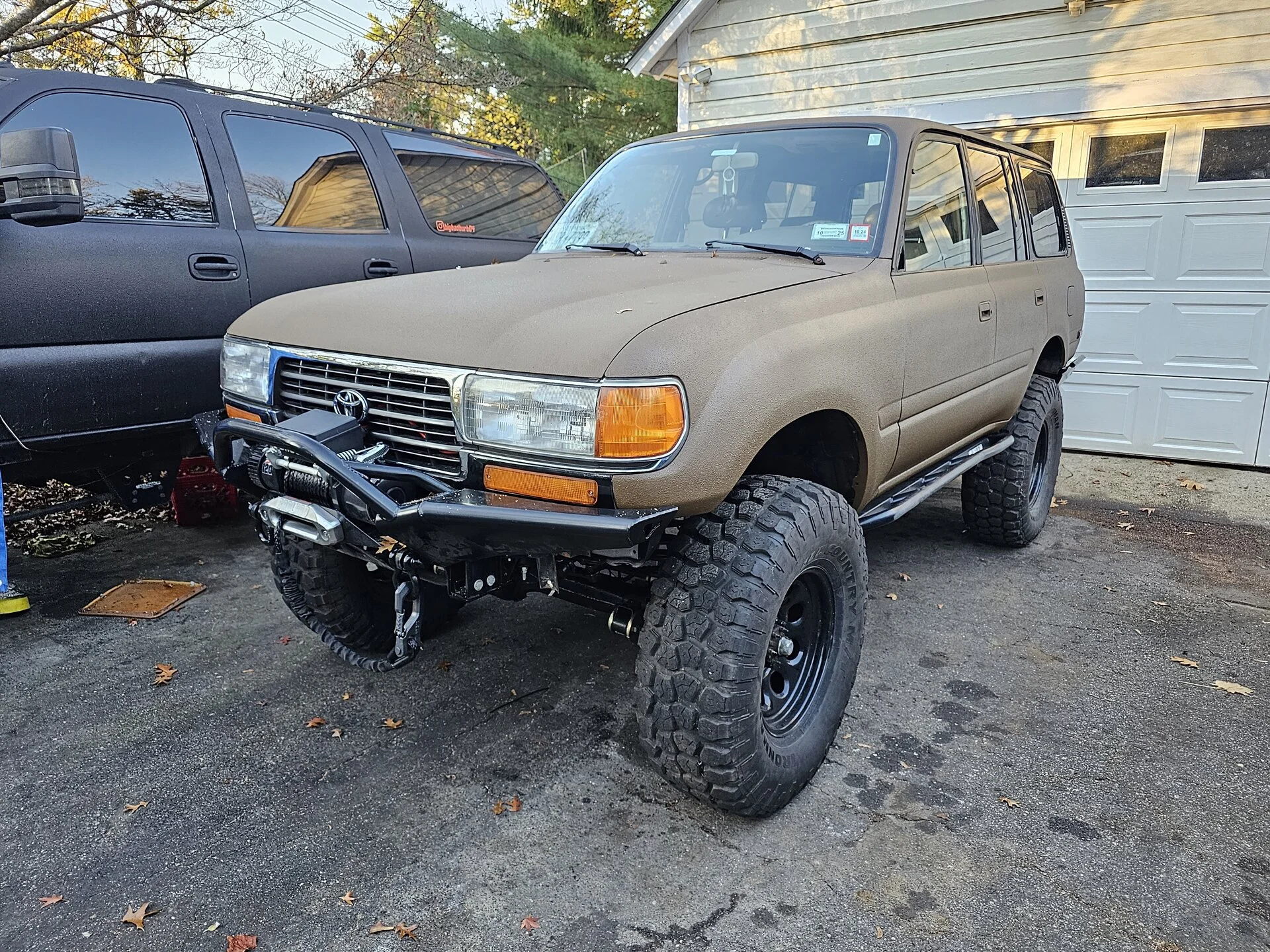

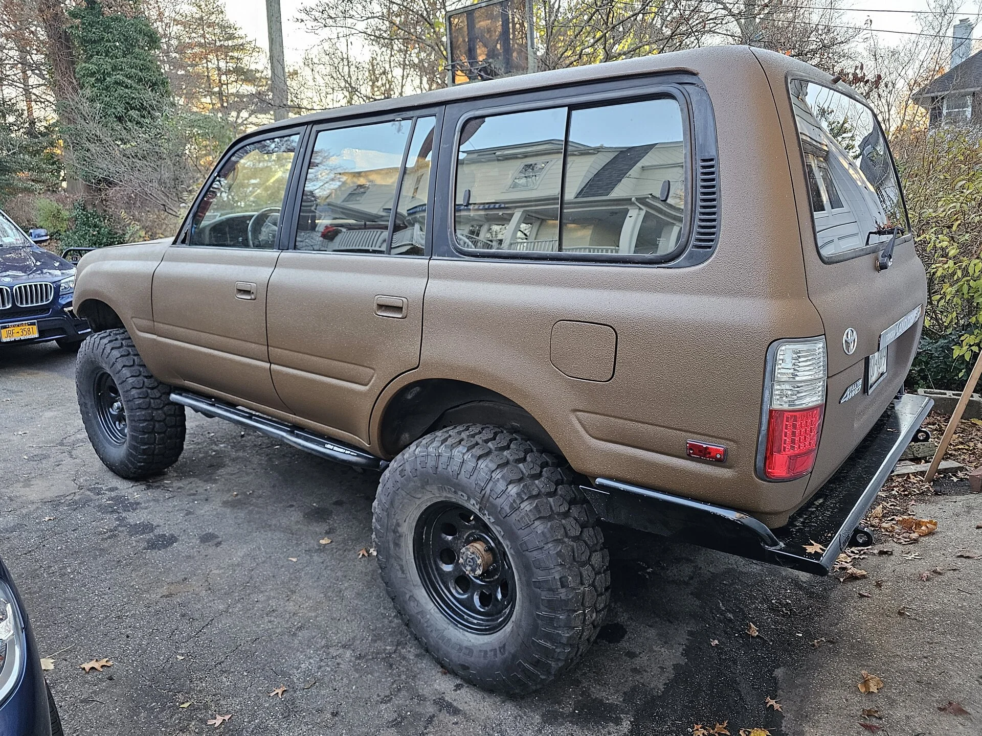

In the meantime, i got the raptor liner on. The color is sepia brown. All the body work is complete, and there are no more rot holes. I must say ive never seen it look better. I know raptor liner isn't everyones cup of tea, but it holds well up against branches and such.
