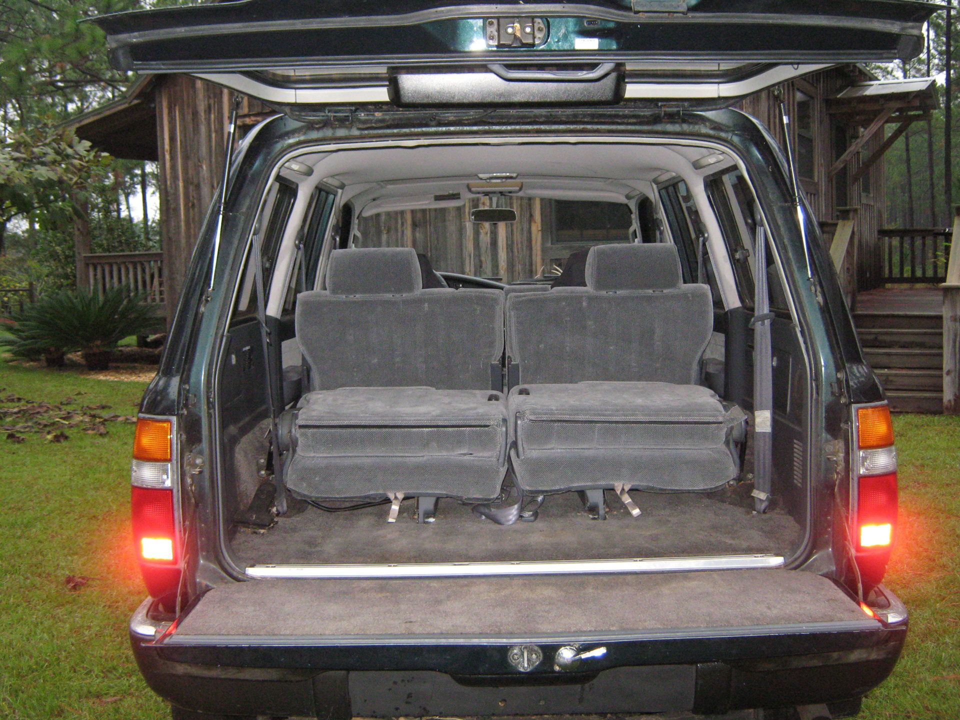

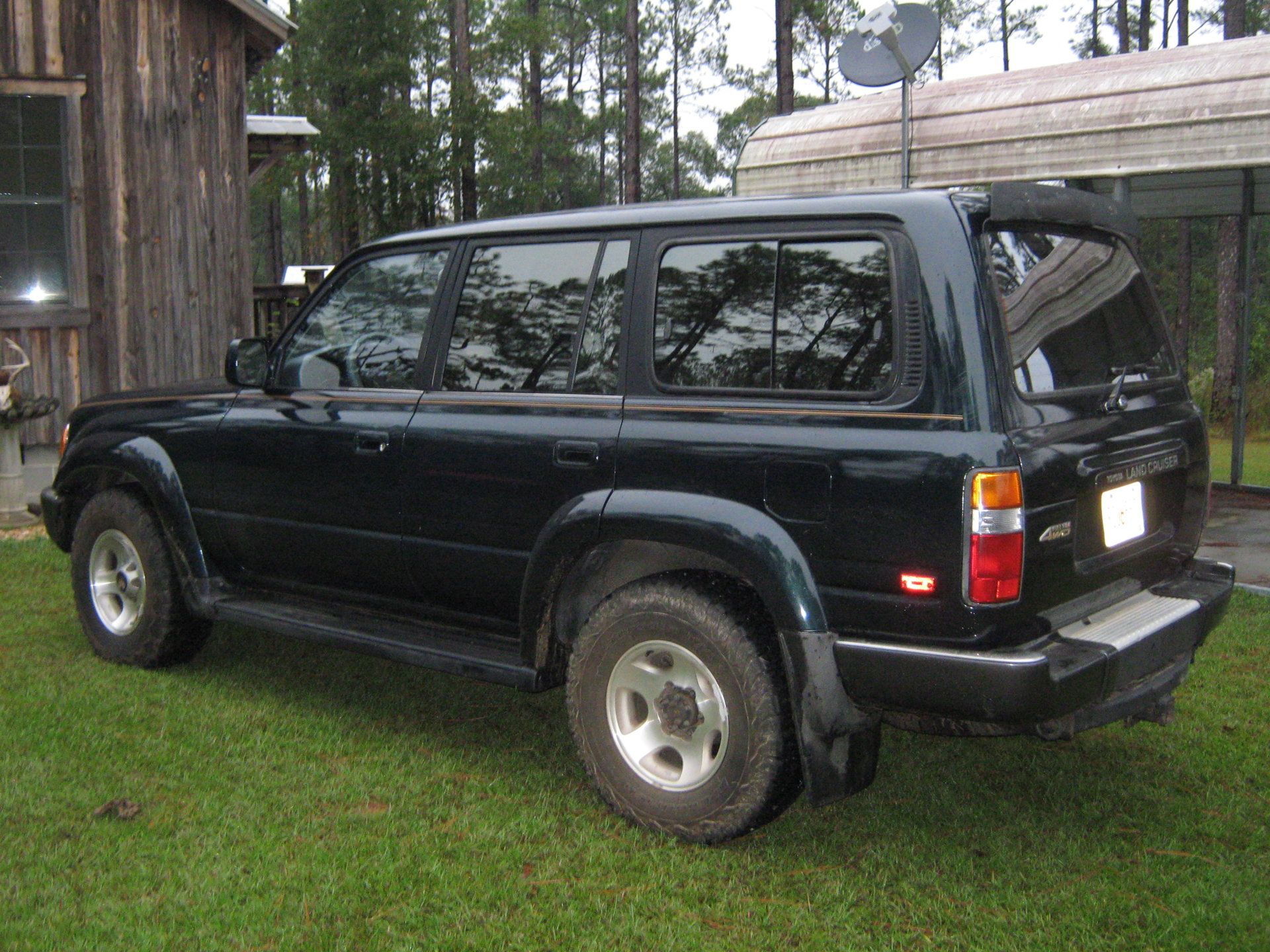

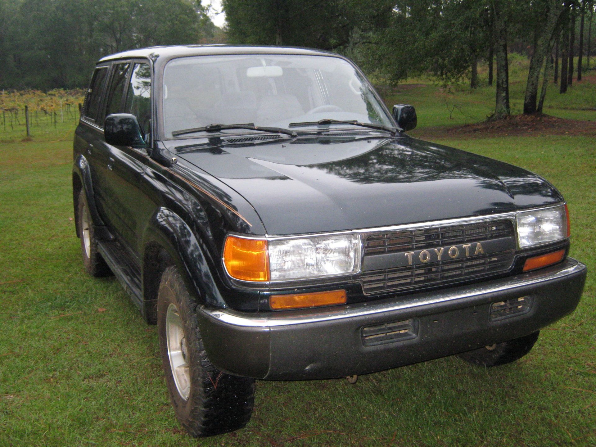

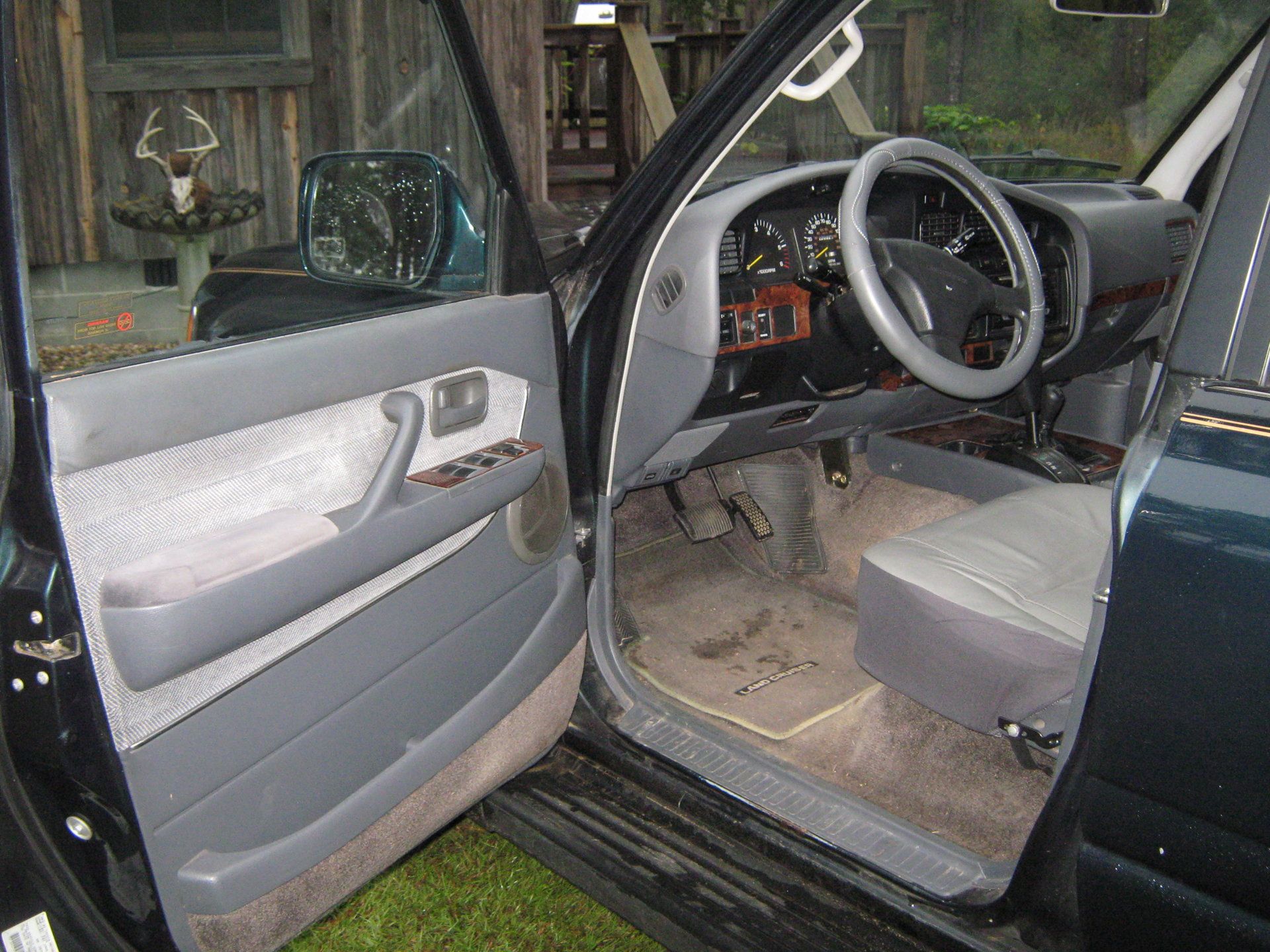

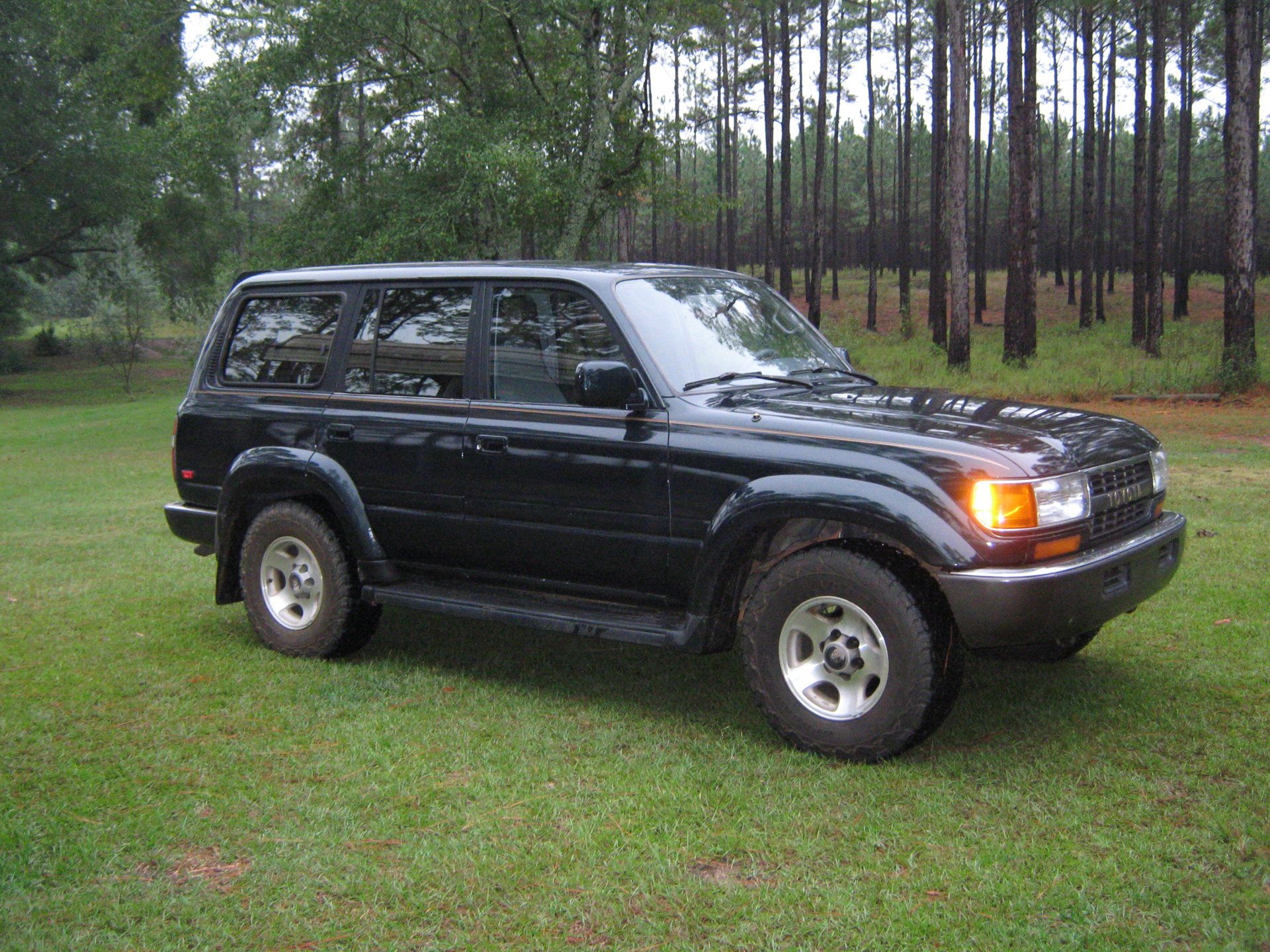

After owning three FJ60's( 1983, 1986, and a 1987 which is in my avatar), I finally found an 80 series from Birmingham, AL in eddie baur green that was clean, close, and within budget. It's a 11/94 build date with the later full float axles and rear disc brakes and ABS, no airbags to worry about exploding, and cloth seats in great condition. No diff lockers, but I would rather have a clean example vs. bad example with the lockers. 207k miles on the odo and $5500 in documented repairs and maintenance that the previous owner had done recently by a reputable shop( Bfg AT KO2's plus spare, engine seals, brakes/rotors, new side mirror, power steering hose, rebuilt steering pump, oil pump, new radiator, new air plenum, Kenwood, etc.)
The only thing left is rebuilding the knuckles which is next on the agenda as well as changing of all fluids. Bought cheap walmart front seat covers for now. Had one front caliper bolt missing(just replaced) and the sunviser clips where missing(ordered from toyota dealer and replaced). Needs new antenna. Plans for the cruiser are to keep it stock for now as I want to keep it original as long as I can. I've got other vehicles for more off-road use so this 80 will be an occasional driver. View attachment 2120952View attachment 2120955View attachment 2120961View attachment 2120974View attachment 2120975

Truck looks very nice. Has it been repainted? I like the pin stripes too
Thanks, I'm not 100%, but I think it has been resprayed on the driver's side, not sure about the passenger. I noticed a slight color difference when in the sun. Overall minus a few rock chips it's in pretty good condition. It was the best example I could afford when I bought it.
