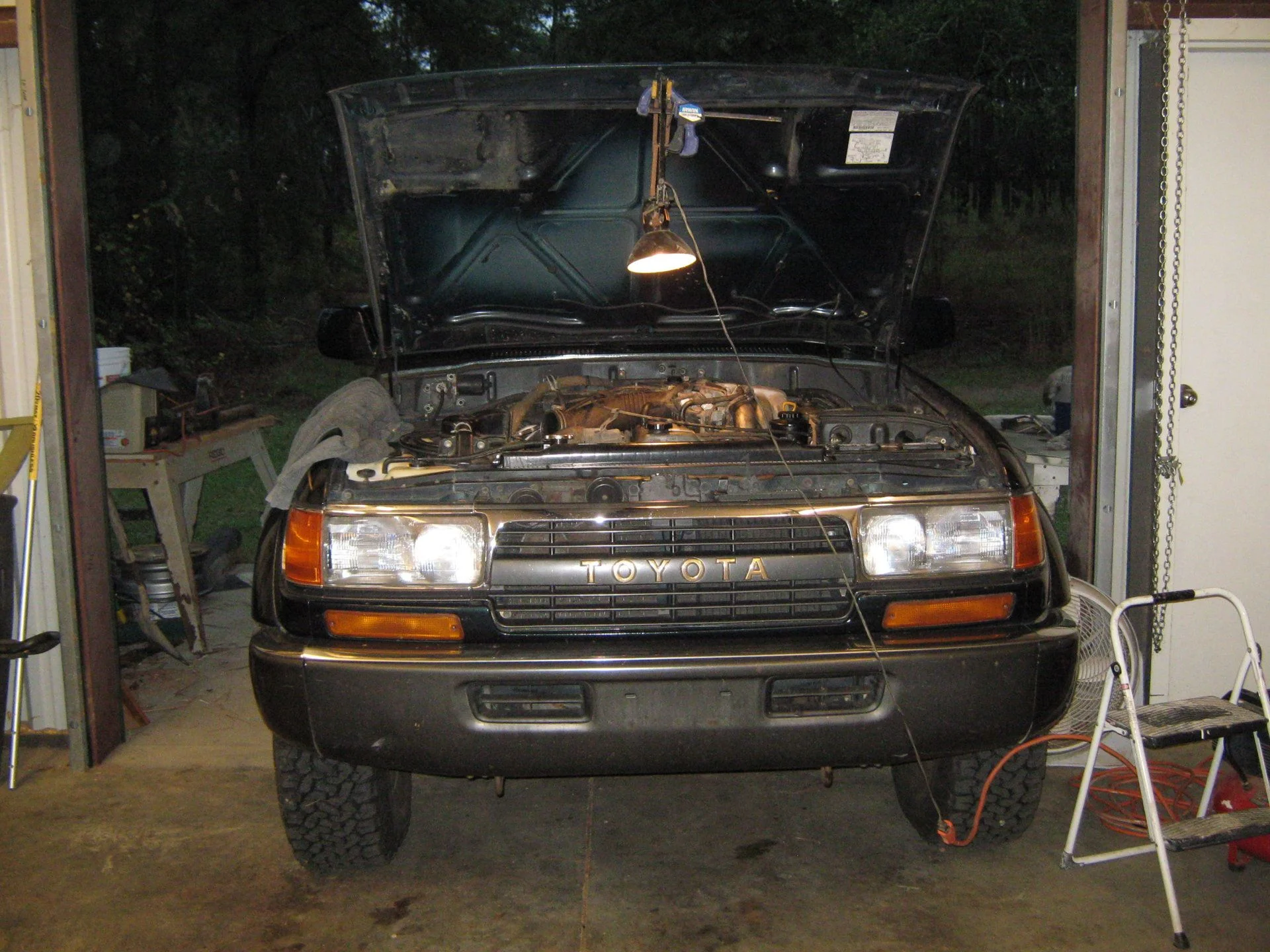

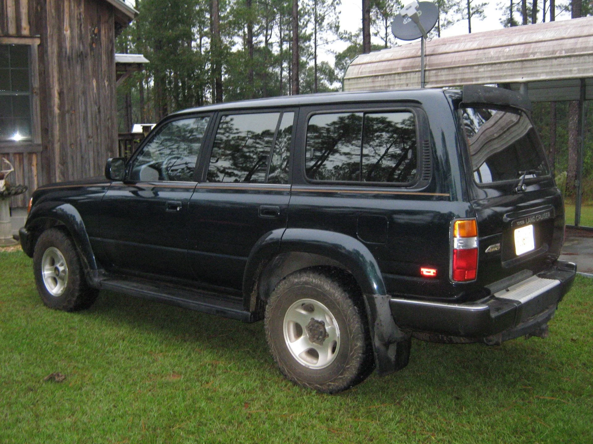

After owning three FJ60's( 1983, 1986, and a 1987 which is in my avatar), I finally found an 80 series from Birmingham, AL in eddie baur green that was clean, close, and within budget. It's a 11/94 build date with the later full float axles and rear disc brakes and ABS, no airbags to worry about exploding, and cloth seats in great condition. No diff lockers, but I would rather have a clean example vs. bad example with the lockers. 207k miles on the odo and $5500 in documented repairs and maintenance that the previous owner had done recently by a reputable shop( Bfg AT KO2's plus spare, engine seals, brakes/rotors, new side mirror, power steering hose, rebuilt steering pump, oil pump, new radiator, new air plenum, Kenwood, etc.)
The only thing left is rebuilding the knuckles which is next on the agenda as well as changing of all fluids. Bought cheap walmart front seat covers for now. Had one front caliper bolt missing(just replaced) and the sunviser clips where missing(ordered from toyota dealer and replaced). Needs new antenna. Plans for the cruiser are to keep it stock for now as I want to keep it original as long as I can. I've got other vehicles for more off-road use so this 80 will be an occasional driver.

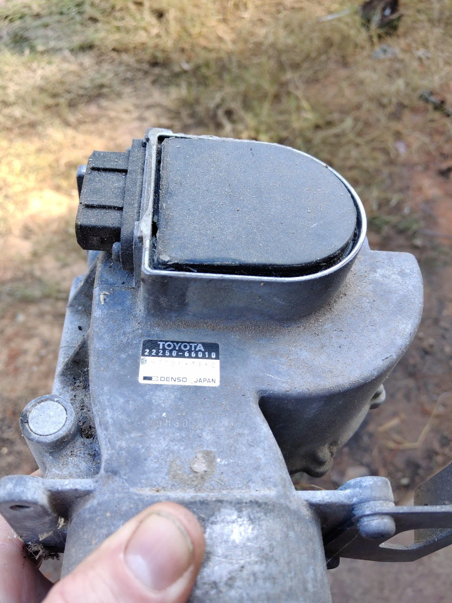

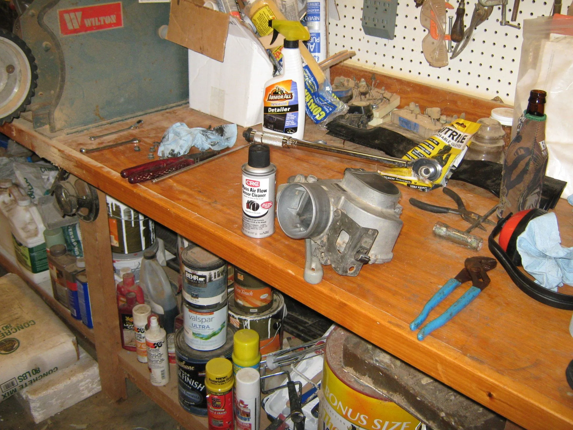

I did the unthinkable and attempted to clean the MAF sensor and throttle body this week.
Of course I did the ultimate bonehead rookie mistake and removed the two infamous screws holding the ecu plug to the maf sensor housing, then pulled the plug reciever out slightly before I realized it is not supposed to come out. :bang:
Now the cruiser starts strong, revs up to 1500 rpm and then dies abruptly every time. I've spent the better part of today searching the forum for guidance on what next step to take, have confirmed that I am not the only one who has made this mistake. Seems like a ritual of passage for a new 80 series owner.
The posts were quite old, so was wondering who is the latest goto member to send the unit to for a rebuild? If this post is too redundant, please ignore as I'm sure this comes up all the time.
If all else fails, I will attempt to disassemble and solder it myself, but would rather have someone that knows what they are doing before I butcher the part beyond repair. Thanks for any info or guidance, as I would rather not have to shell out $700 for a new unit.

I'd like to think I'll remember reading this... Unfortunately I'm likely to remember this AFTER I've done the same thing...
They all get tested. Some of them have been repaired in the past.
Just out of curiousity, what is involved in repairing these sensors? I looked at the repair job that was posted in the 80 series maintenance from secret squirrel from 2009 thread. He took the plastic cover off and soldered a couple of the connections, then resealed. Is it that simple to fix, minus soldering skills? If so, I might have a go at it first before buying a repaired one. If I mess it up no loss and will buy one of yours.
It all depends on how bad they get pulled apart and how good your skills are. We work on copy machines at work and repair bad boards all the time so we have a nice solder station which helps a lot.
