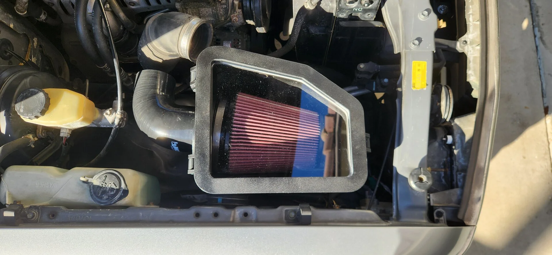

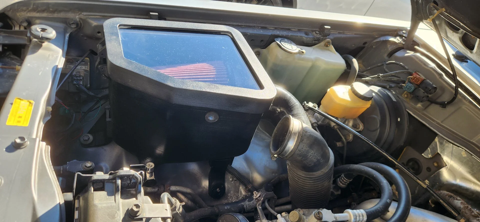

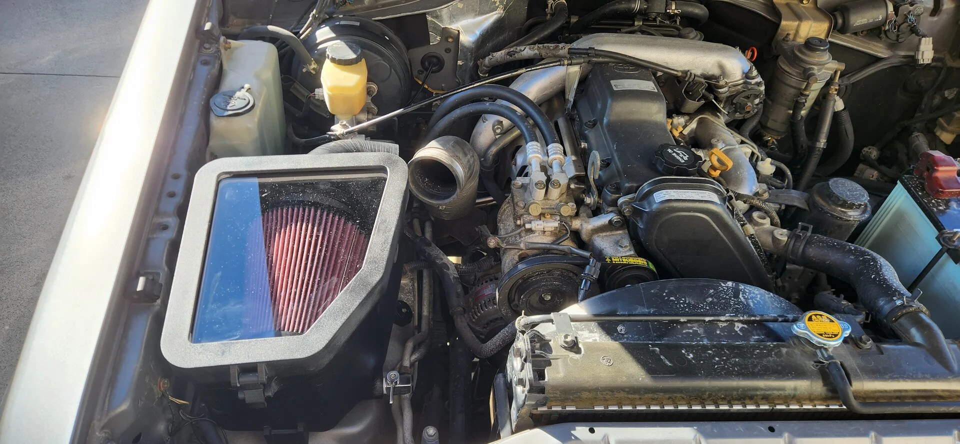

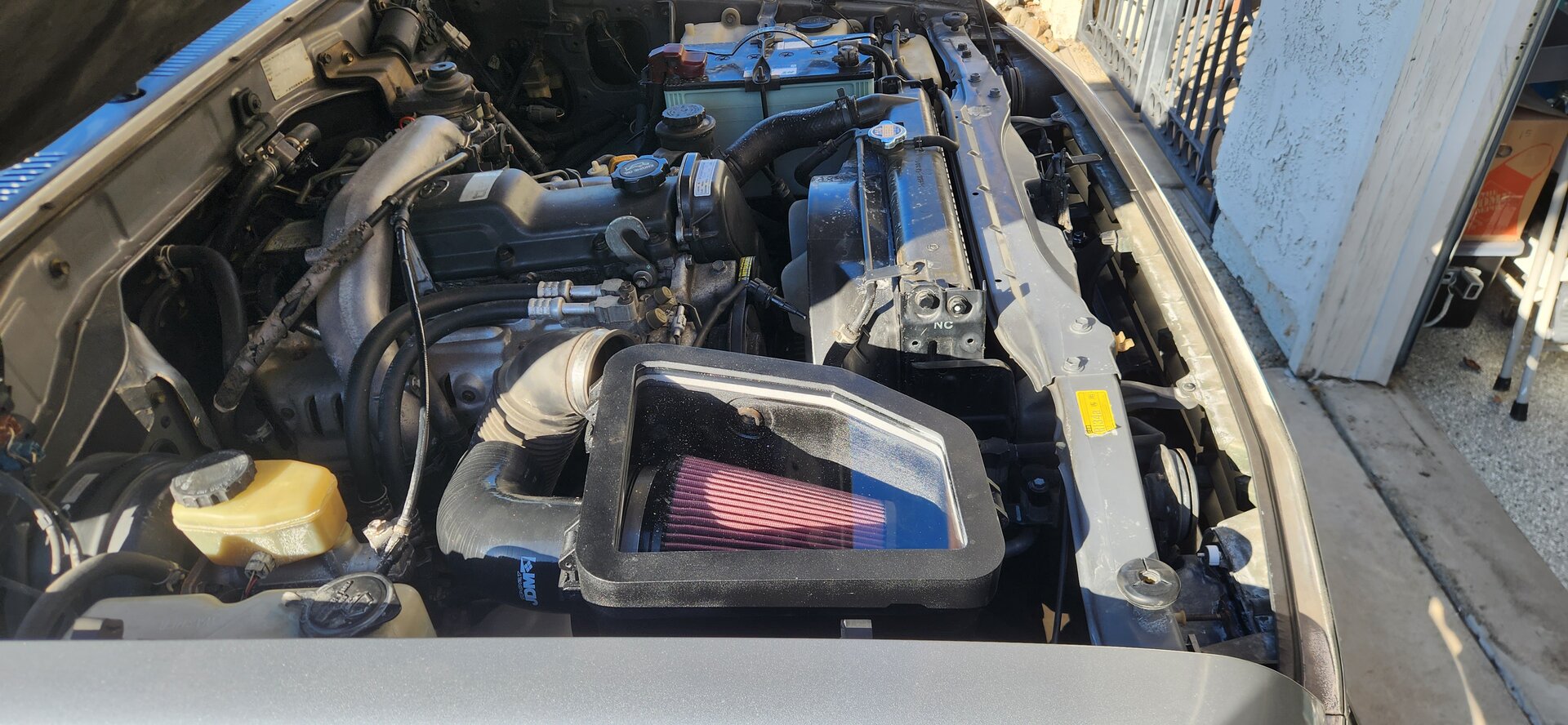

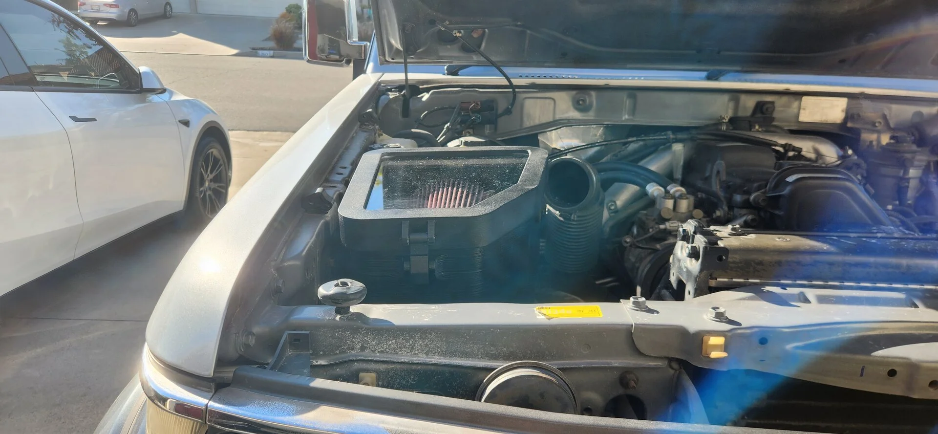

More pictures of the install:

Very nice! Are you using PLA or ABS?
PETG, pla is absolutely too low of a temp for the engine bay... The PETG material is better but not a permanent solution either. Once I'm done with this prototype I plan to reprint in carbon fiber nylon for a lighter stronger solution
So that would be preferable to ABS in this usage?
ABS will be sufficient for an intake but keep it away from hot objects in the engine bay. The cf nylon is better for high temps but it's more difficult to work with and pricier too

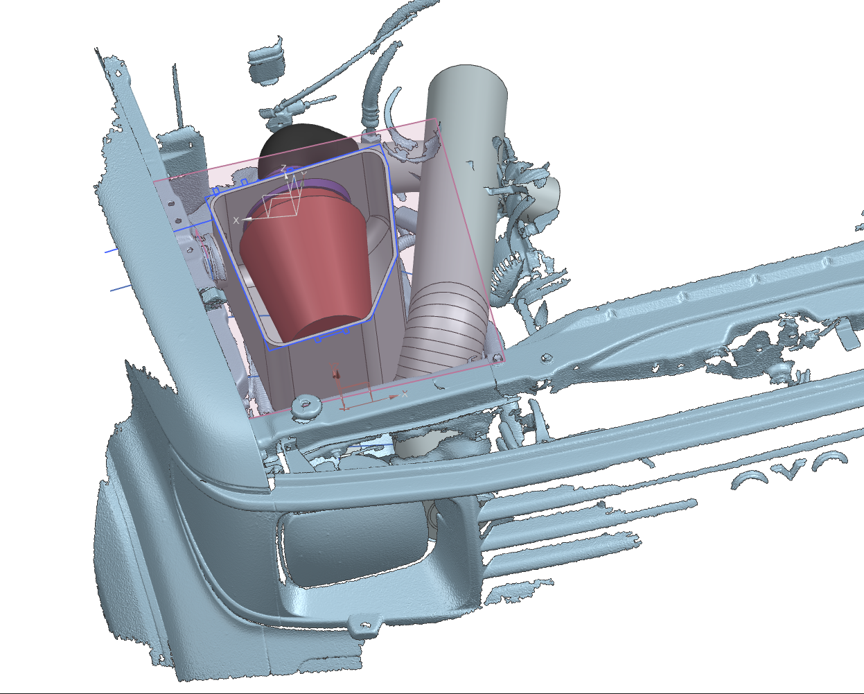

This is a very helpful thread and your 3D scanning, design and end result for the sealed airbox is outstanding! Well done and subscribed.
