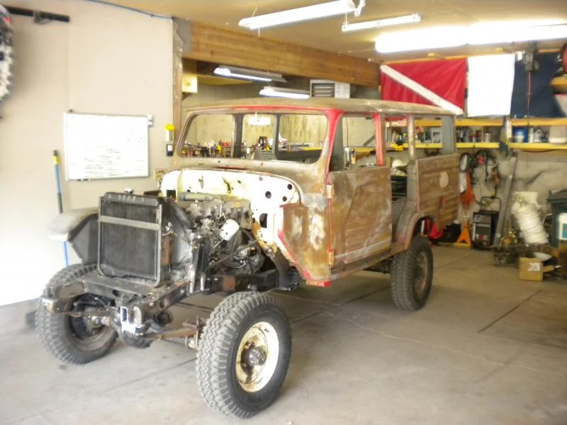

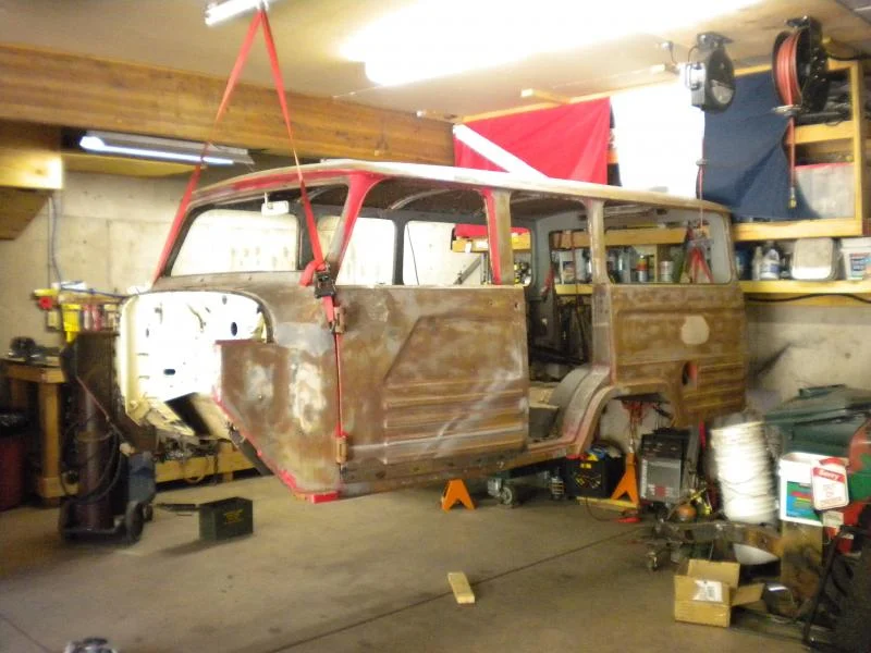

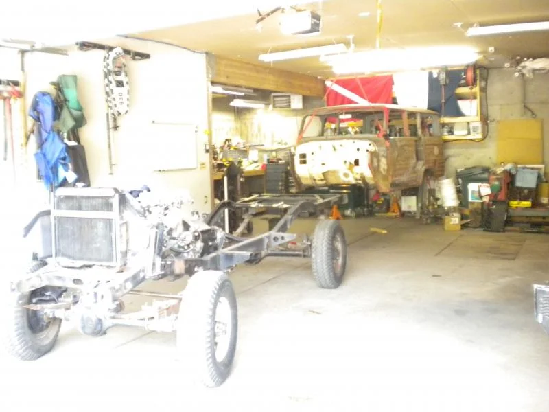

Here are a few over all Pictures.
Whats Done:
SOA and Shackle Reversal
Motor and trans located
PS conversion- Still need the reservoir..
axles rebuilt with 4.88's and ARBS
Next order of business:
plumbing the Turbo..
building a fuel tank out back
running fuel, brake and clutch lines
battery tray
AC- I need a pump and the bracket if anyone has one kicking around:)

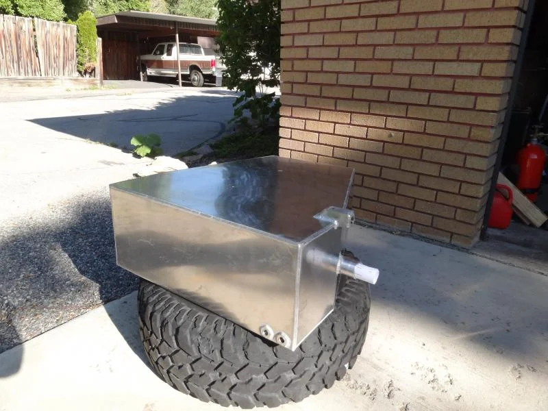

long range tank has been made
